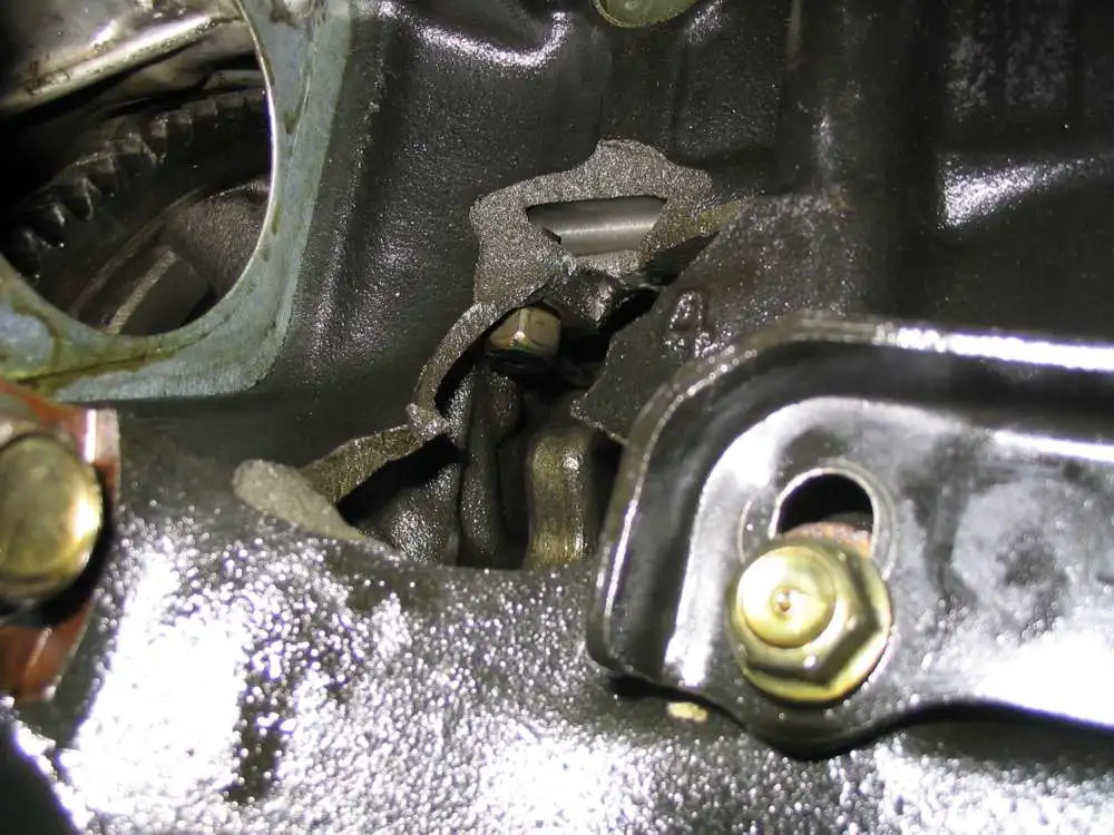

These first pics are the hole that got knocked out of the bearing support plate... and you'll see what is left of the rod in the hole....

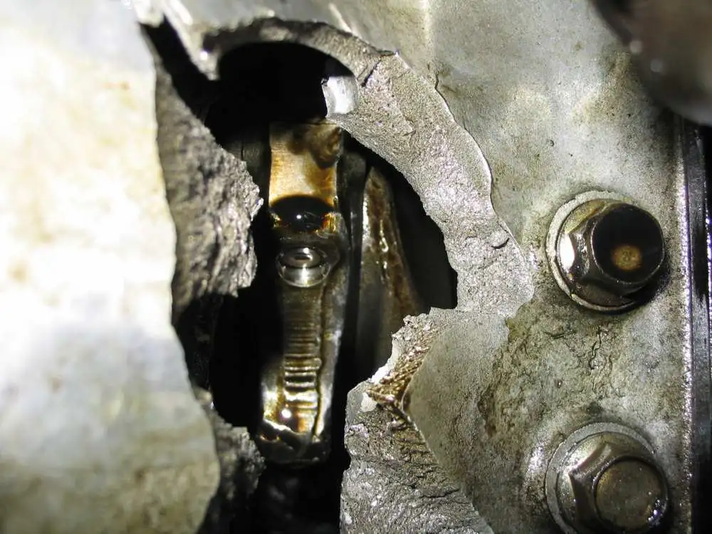

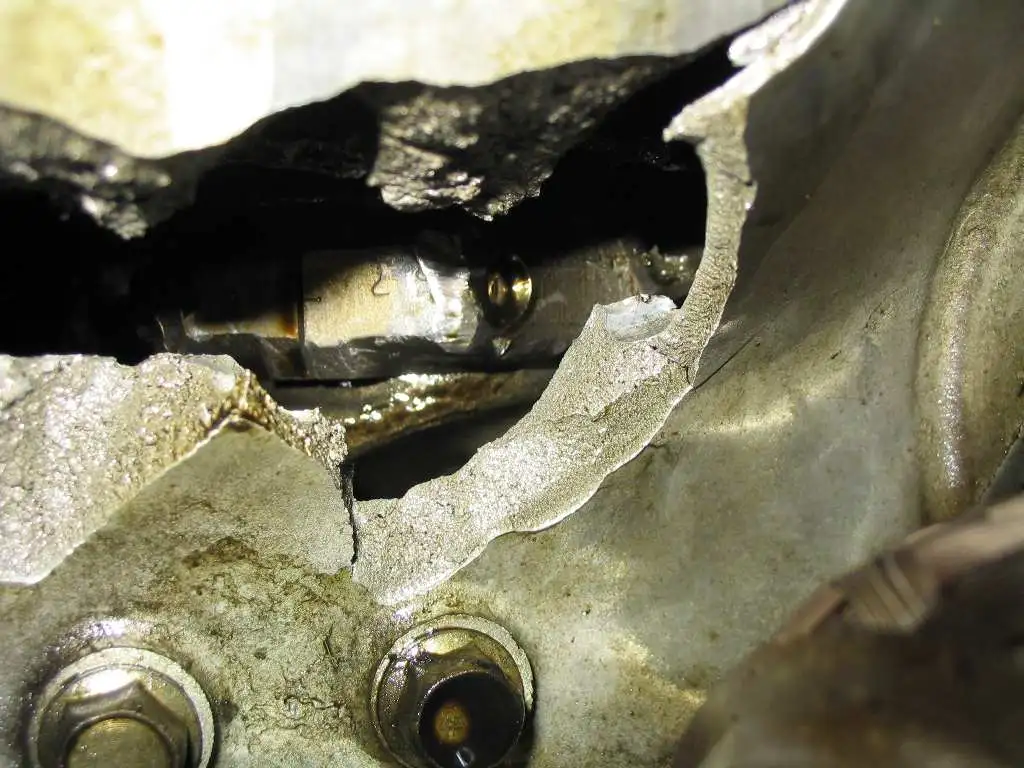

And these last pics are of the whole in the block itself that was right behind the starter. You can also see what I'm guessing is a coolant passage or clearance hole at the top edge of the fracture.

OUCH!!! So aybe it looks like you were too rich, if there was that much fuel in there. If you had it tuned for 8PSI and it went up to 11 or 14, then you definatly were bound to blow. How can the motor be tuned for 8 and still run on 14 with only enough fuel and timing for 8? I would think that's why you felt no power difference, but I could be wrong.

OIC!!! As I was then! Thanks for the clerification, sorry I misunderstood. So how will you determine the root cause of the failure?
