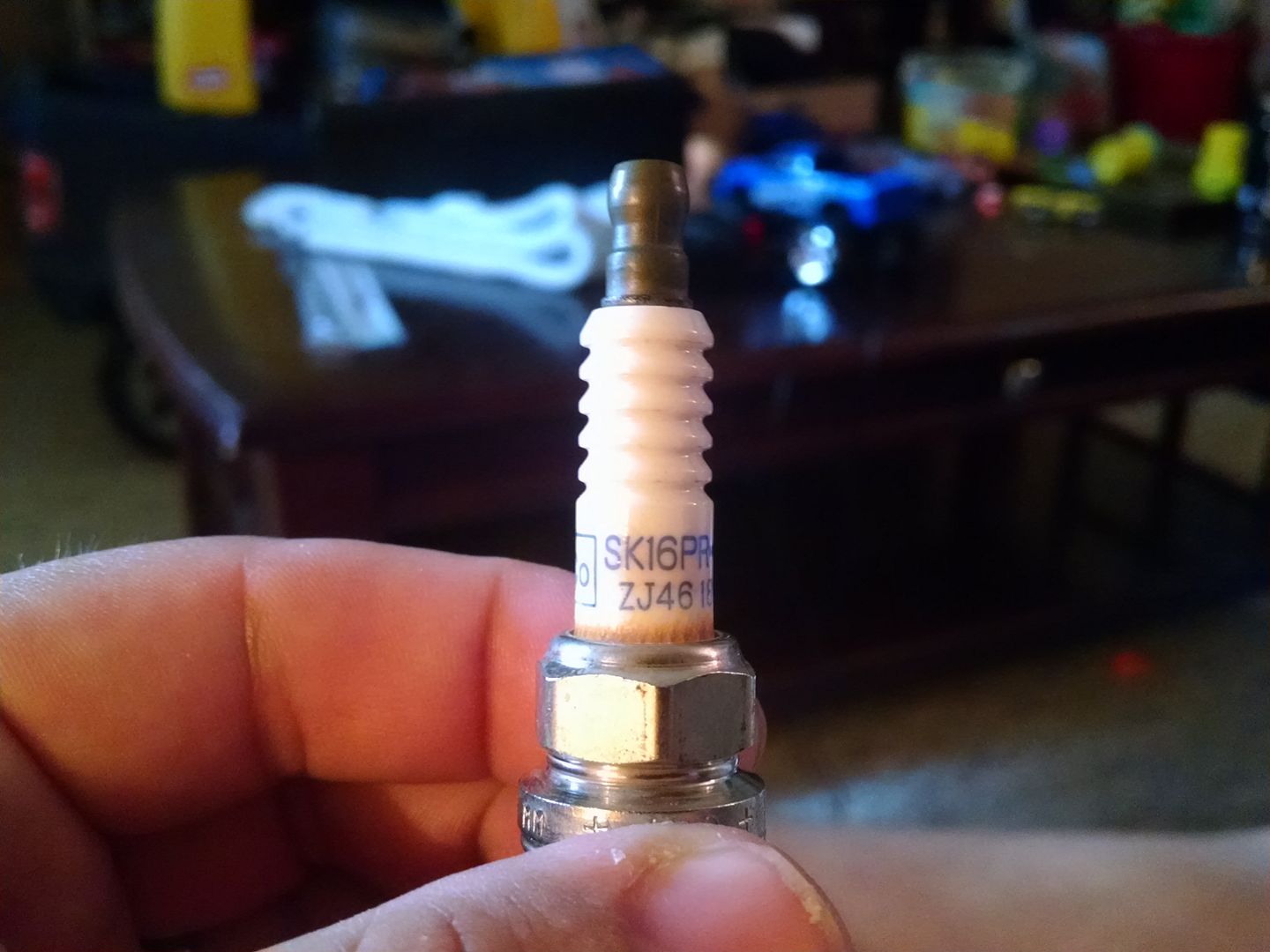

Since your's is an American market 2, it should be the ZJ part number, which is exactly the same as Denso #SK16PR-E13(the stock plugs even have both of these numbers on them... The number you have is an updated part number though I'm guessing). Also has Fomoco on the plugs too.
I'd recommend NGK BKR5EIX-11 as a better alternative because the stock plugs have failed early for several people(causing misfires at idle before the 75k interval)... Mine started this at only 50k.

FWIW going to a parts store, asking for #5464 will probably help you find them faster as that is the general inventory number for those plugs. I've found spark plug numbers can confuse the hell out of some parts guys.
