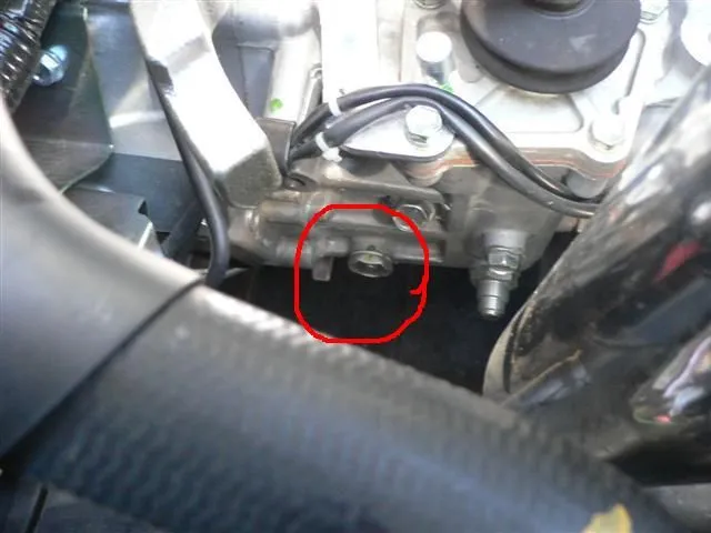

I haven't seen a write-up but it's not hard. Put the front wheels up, preferably on ramps. remove the engine undertray. Remove drain plug, it's located at the rear of the transmission case, can't miss it. It takes either a 17 or 19mm wrench, I don't remember which. While it is draining, remove the fill plug as indicated in the picture. The two plugs are identical. When it's empty, put the drain plug back in, nice and snug. If you are anal, get replacement washers from the dealer, but it really isn't necessary.

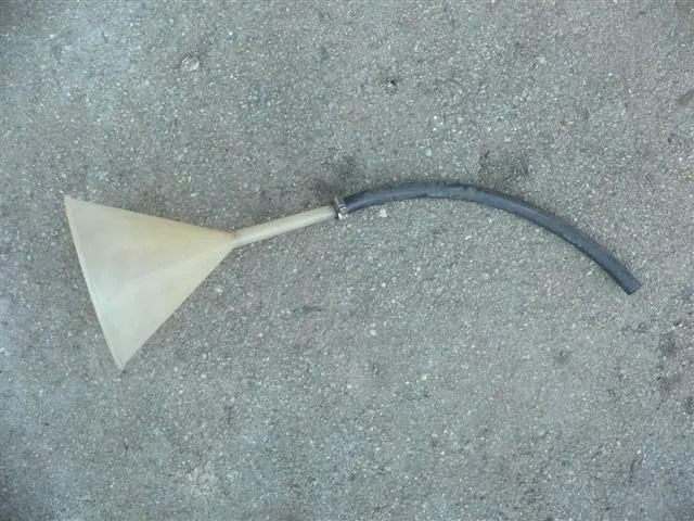

Install a funnel from the top of the engine bay into the fill hole. You need a funnel that has a long skinny tube that can be bent at 90 degrees. The other picture shows what I used.
