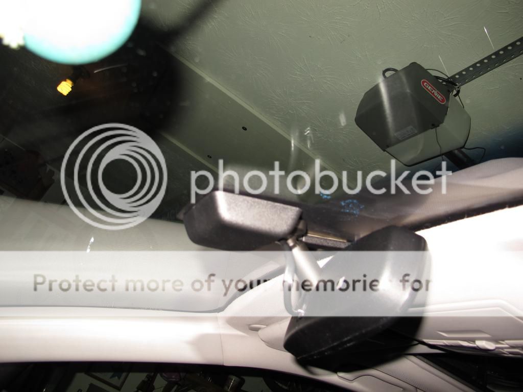

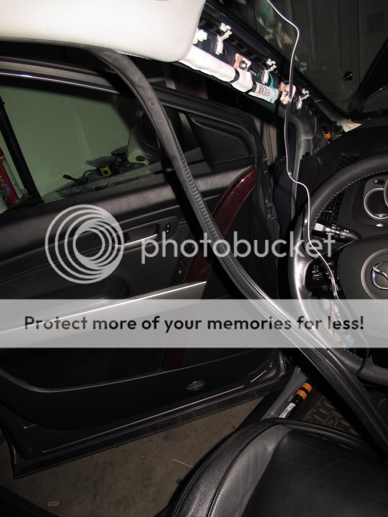

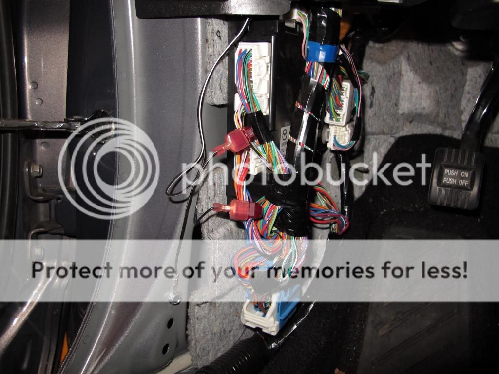

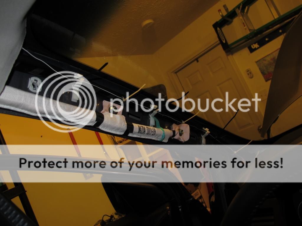

Some pictures of my Homelink mirror install....

Does the headliner un-snap to run wire under it? Any chance that you could include one picture from outside looking in along edge of headliner?
No way to get a picture up under there. The installation kit from Mazda says to use a "fiber stick" to tuck the wire in there. Basically there is tons of room. I just pushed the wire between the windshield and the headliner with my finger and the wiring dropped into the recessed area inside the headliner, really really easy. The hardest part was both removing the A-Pillar trim due to the strangely designed clip that pops out 1/2 inch and then has to be slid upwards, and then finding the correct blue/red wire on the 16 pin connector was a slight challenge.
