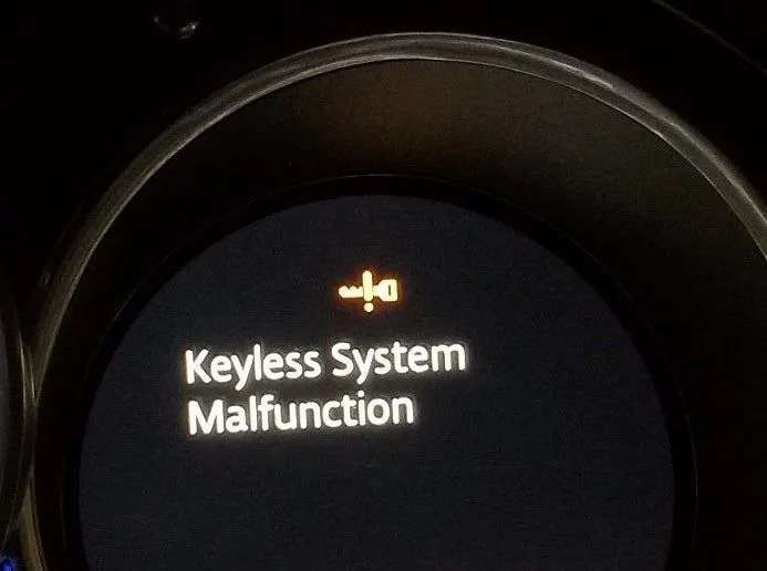

The dash lights up and I don't get any errors except for the keyless system malfunction, as shown in the picture. I did try to move the shifter and ran it through P, R, N, D by overriding it. I even tried to start it in Neutral and tried all possible combinations, including what you suggested, still same issue. If the anti-shift switch was faulty, at least it should start in Neutral.
