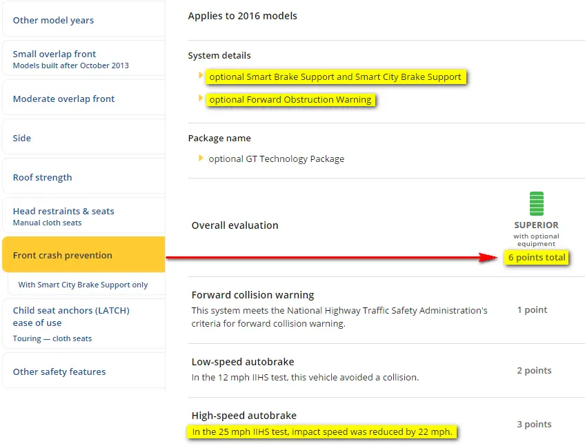

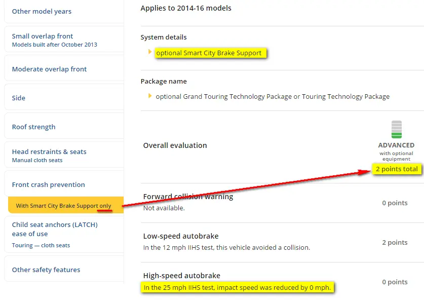

Not sure I agree - IIHS posted the results on their website for this - see my attached screenshots.
IIHS raised the rating for the 2016s:
2016's equipped with the forward obstruction warning (IE - I-Activesense) - reduced the speed by 22mph from 25mph in the test.
2014 - 2016's with ONLY SCBS - stopped vehicle at 12mph, but failed at 25mph.
