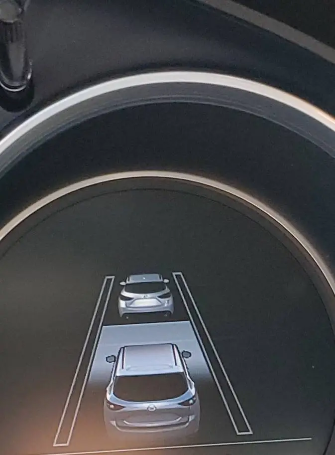

In normal driving, do you see the indicator in the dash/HUD that shows a vehicle ahead? If so, the DRSS is working correctly, which is one of the systems SBS works with to determine if emergency braking is necessary. The DRSS is a complicated system.. here's a snippet from the manual:
The Distance Recognition Support System (DRSS) measures the distance between your vehicle and a vehicle ahead using a radar sensor (front) while the vehicle speed is about 30 km/h (19 mph) or faster, and if your vehicle approaches a vehicle ahead more closely than what is appropriate for maintaining distance between the vehicles according to the vehicle speed, a notification in the active driving display is indicated to advise you to keep a safe distance from the vehicle ahead.
My takeaway from this quote is that along with the speed requirement of 19mph or faster, the system will trigger SBS earlier or later depending on the situation. I.e. depending on how close you are to the vehicle in front, how quickly the vehicle in front slows down, the speed both vehicles are traveling at, etc. At lower speeds, SCBS does the emergency braking.

You got the flashing pre- warning on the dash long before the smart brake kicks in either audible or HUD warning.
The white area flashes when you are too close. Before the smart brake system.
Not to mention a diligent driver can spot when too close is too close.
Think we are mixing up pedestrian system vs cars warning system. The radar system shows the distance to the car in front. When too close then icon flashes as a visual pre-warning. When the system actually triggers then its the big "brake warning" with audible and eventually car slams brakes second after.
Not sure what system we are talking about here. My 2019 CX-5 GT/PP gives me the "Big brake Warning" with the audible warning every time I drive up on someone exiting the highway and I have never had the brakes applied. I just get the warning.
