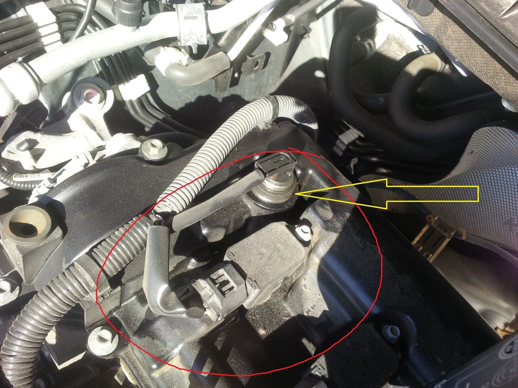

I just changed the oil of my 2013 2.0 CX-5 and notice oiliness on the engine head. First time I am noticing it, 57K miles.
It seems like the leak comes from a sensor of some sort (See image attached).
Anyone knows what this sensor is called?
Is it common problem?
Will dealership fix it under warranty?
Thanks.

I doubt that this is a common problem, but then I doubt that very many DIY owners here pull the engine cover off when they change the oil (I know I don't). So the area of concern will largely remain unseen by most people. What you show appears to be more of a "weeping" situation than an actual leak, but if you are still within warranty, I can't see how a dealer could deny a warranty claim.
I doubt very much that a dealer would qualify this as a leak. Maybe it is just some lubricant they use to install the sensor. Leave it and forget it, is what I would do. ed

Good strategy to be super-vigilant as your warranty expiration approaches. It's saved my ass a couple of times. I would get this seepage taken care of while you still can. Looks to maybe be just a case of replacing that rubber collar at the base of the sensor. Probably take 10 minutes!
Is it one of the Camshaft Position Sensors? I've had one of those with a small leak on a former vehicle. PCV looks to be on the other side of motor according to FSM.

that looks like the Oil Control Valve:
Looks like replacing it is not the easiest thing in the world (you have to remove the cylinder head cover). I think it would be a good idea to show the leak (seep?) to the dealer and see what they think. It's definitely an "Internally Lubricated" part of the engine so it should be covered under the power train warranty.
The dealer said it is VVT actuator valve or sensor (didn't pay much attention). It will be covered under warranty. Waiting for parts. Will update the thread with part # once I see the paperwork.
