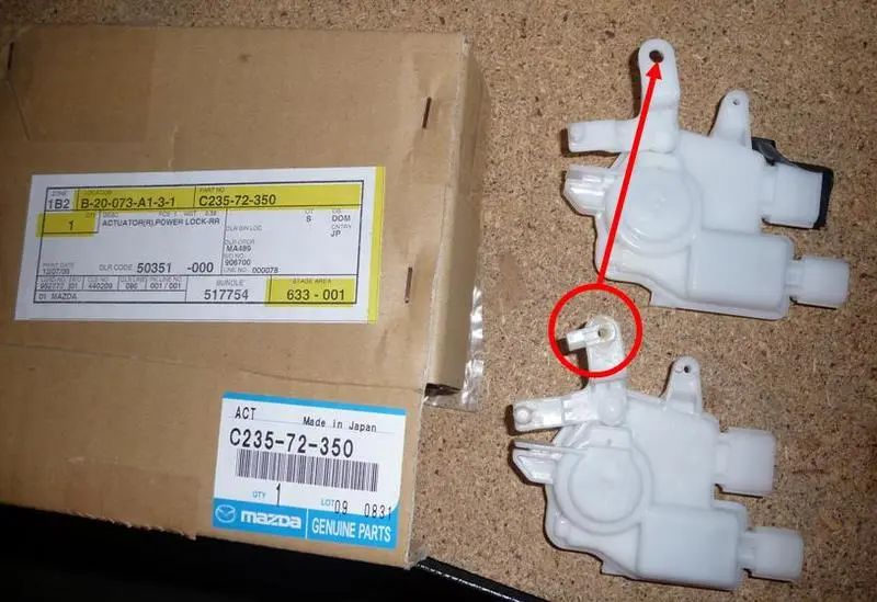

Parts:
C23572350 - Passenger Side Actuator
C23573350 - Driver Side Actuator
Each actuator retails for about $56, but you can find it online for $40 or less.

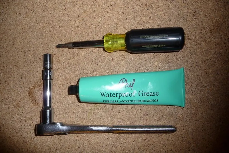

Tools:
Philips Screwdriver (I recommend a 6-in-1 screwdriver)
10mm Socket with extension
Grease and Paper Towel (for cleaning)

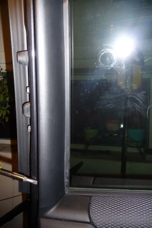

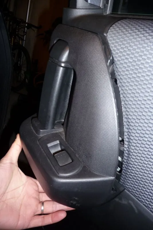

Open the sliding door halfway. Pull out the cover by the window.
Step 2
attachment.php

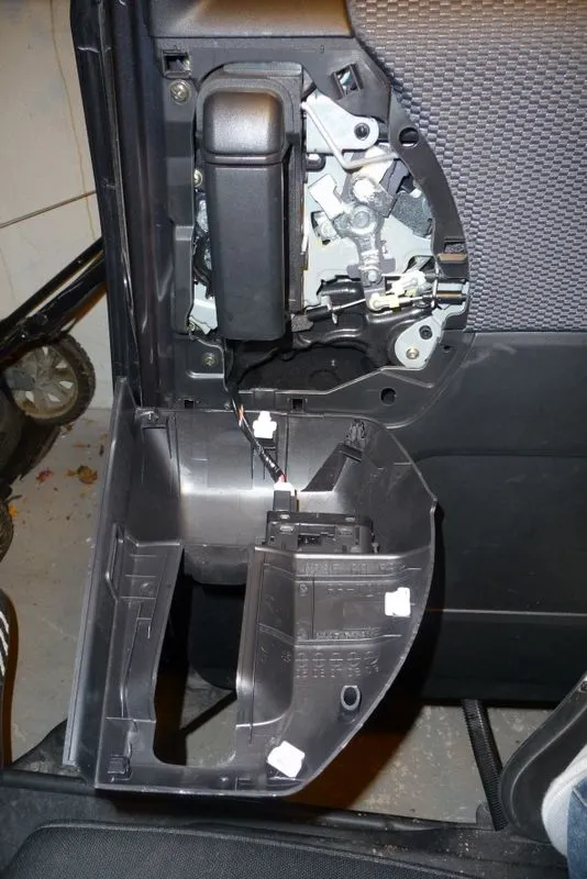

Next, remove the cover surrounding the handle. Make sure the lock lever is in the locked position. Otherwise, the lever will be in the way. Start pulling out the cover on the lower right side. The cover should pop off fairly easily. Do not pull too hard, the window regulator wire is connected.
Step 3
attachment.php
Here is the cover off. You can see the window regulator wiring. Pull out the window regulator wiring connector. Press on the connector tab and pull. Also remove the cable guide attached to the inside of the door panel.

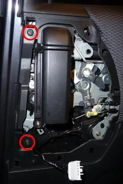

Unscrew the two philips-heads circled in red

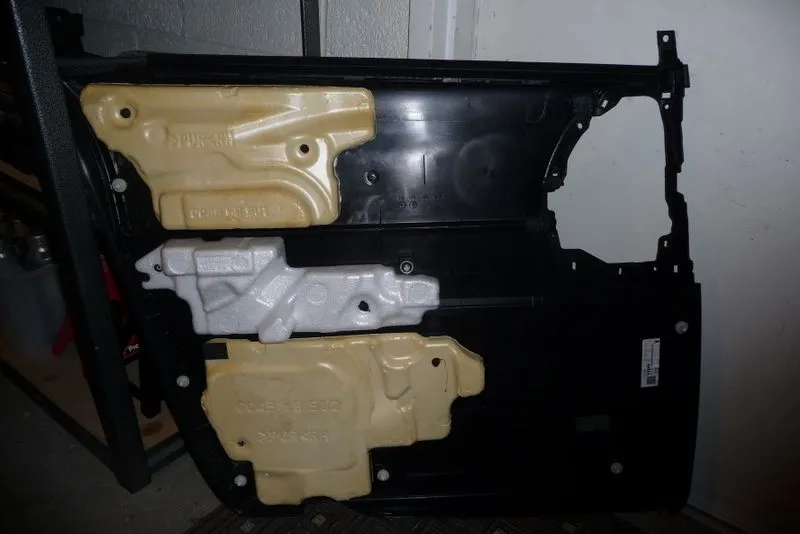

Now you're ready to remove the main door panel. There are two holes on the bottom where you can get your hand inside the panel and pull outward. Start on the bottom and work your way counterclockwise. The top of the panel drops into the window sill. Once the panel is free, lift the entire panel up to free it from the door frame.

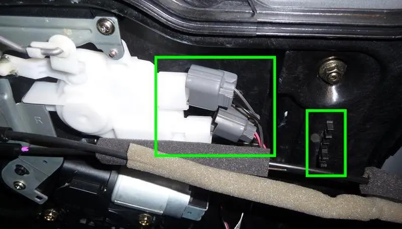

Unplug the 2 connectors on the actuator. Free the two cables from the cable guides.

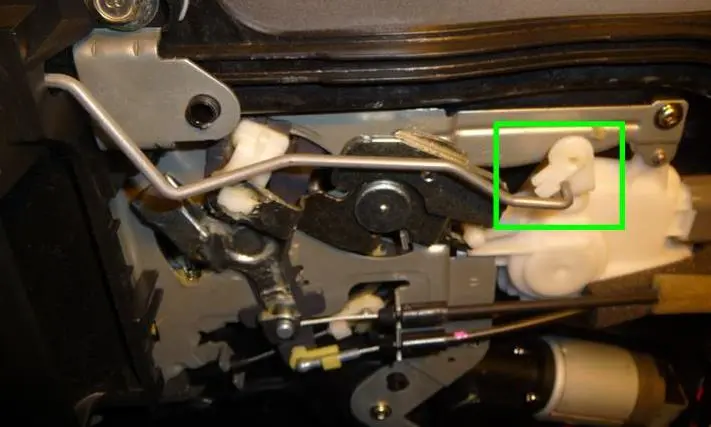

Disconnect the lever connecting the lock lever to the actuator. Pop out the lever from the holder in the green square.

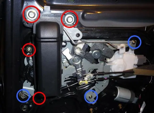

Remove the door handle/lock lever by unscrewing the 2 bolts and 2 screws marked in red circles. Ignore the blue circles for now.
Step 9
With the door handle removed, refer to the Step 8 picture again. Unscrew the 2 philips-heads and one bolt holding the metal frame (blue circles).
Step 10
attachment.php

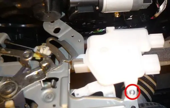

Now pull off the metal frame. You will not be able to completely take it out because there are cables attached to frame, but you will be able to get access to the screw holding the actuator in place. Uncrew the philips-head in red circle. You can now remove the actuator.

Transfer the plastic lever holder from the old actuator to the new one. Apply grease to the new actuator's exposed moving parts.

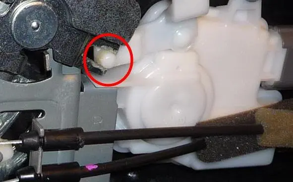

Install the new actuator onto the lock frame. Make sure the actuator arm goes inside the U-shaped bracket. This is the connection that locks the door to the car's frame.

Reverse of Step 6, reconnect the 2 connectors for the actuator. Place the 2 cables back in the cable guides. At this point, you may want to test out the installation. Try locking and unlocking the door with your remote.

Reverse of Step 3. Take the door handle cover, put back the cable guide for the window regulator wire. Reconnect the window regulator wire on the back of the door handle cover. Place the cover back on the door
Step 20
Reverse of Step 1. Put back the cover by the window.
Thank you very much! Both of them on my 2006 are been not working for months... this will be my project after the new year. Thanks!
FYI if you have the factory alarm, the part numbers listed above are inccorrect.
they should be:
C24572350 - Passenger Side Actuator
C24573350 - Driver Side Actuator
