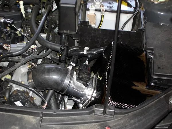

Upon opening the box, the intake looks really nice. Nice, shiney and lightweight, the main front edges had a type of edge trim to finish it off. The holes were nicely drilled and it came mostly assembled. Some of the corners werent 100%, but nothing I couldnt overlook. The main box does have a fiberglass backing for added strength. There were no instructions with the kit, but that will change (at least for the kits from Xtec USA)
The supplied hardware was of good quality. The filter assembly itself was nice, bright blue in color, about an 8 diameter at the base with chrome accents and a nice T-bolt ring seal. Gaskets are supplied for the filter and for between the aluminum piping parts that mount to the box.
Install Issues
The supplied aluminum piping parts both came threaded. Since these parts sandwich the CF box, one part had to be drilled out. We chose to drill out the MAF part and install the bolts from the outside in.
The kit failed to supply a section of hose to connect the OEM breather tube to the CF box. 3/8 ID is needed.
The kit also failed to supply a bracket for the Barro Sensor. I chose to use the OEM bracket and mount it to match the OEM distance and location from the MAF. This made for a near perfect match in placement.
The lack of instructions had me stumped on where the supplied bracket would go.that is until I looked more closely at the hardware that was supplied.
Post Install Impressions

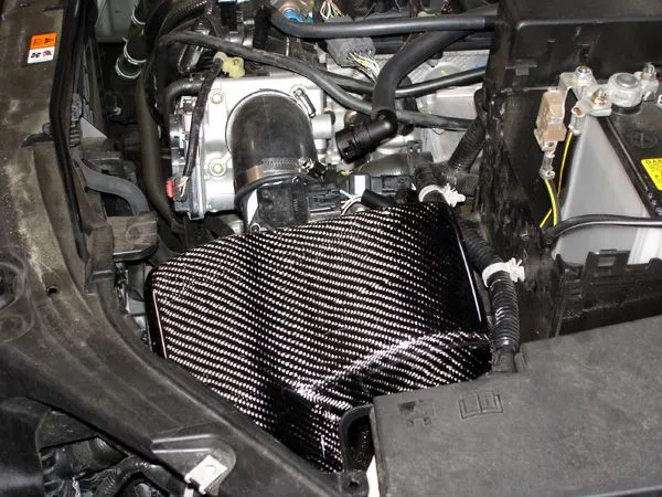

The box quality was good, fit pretty well. I would only change one small part to have it fit 100%, but its nothing that inhibits its performance, mainly for looks. Its the part that fits around the fuse box. Seems they made it to fit not taking into account the wire loom coming out of the fuse box. But it also sits slightly offset when installed anyway, so i dunno. A small change to the shape and it would be 100%. As is, I see it as 90%.
The supplied hardware is your standard intake hardware. The support bracket was nice, thick and beefy with crisp, clean bends. I would have preferred a silicone elbow rather than the rubber elbow supplied, but it does the job.
I chose to retain the battery air scoop for a stealthy OEM look. Its a 99.9% fit, as 1 tab used to attach the small plastic filler piece above the headlamp would need to be shaved off for a 100% fit.
The final product is a preliminary well performing and good looking intake thats very easy to install.

Here are a few teaser pics...more to come...
