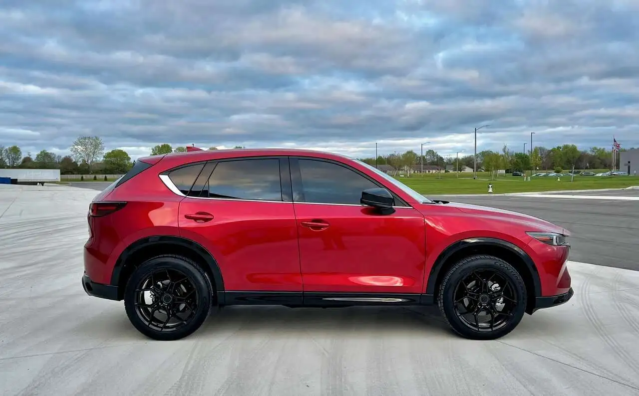

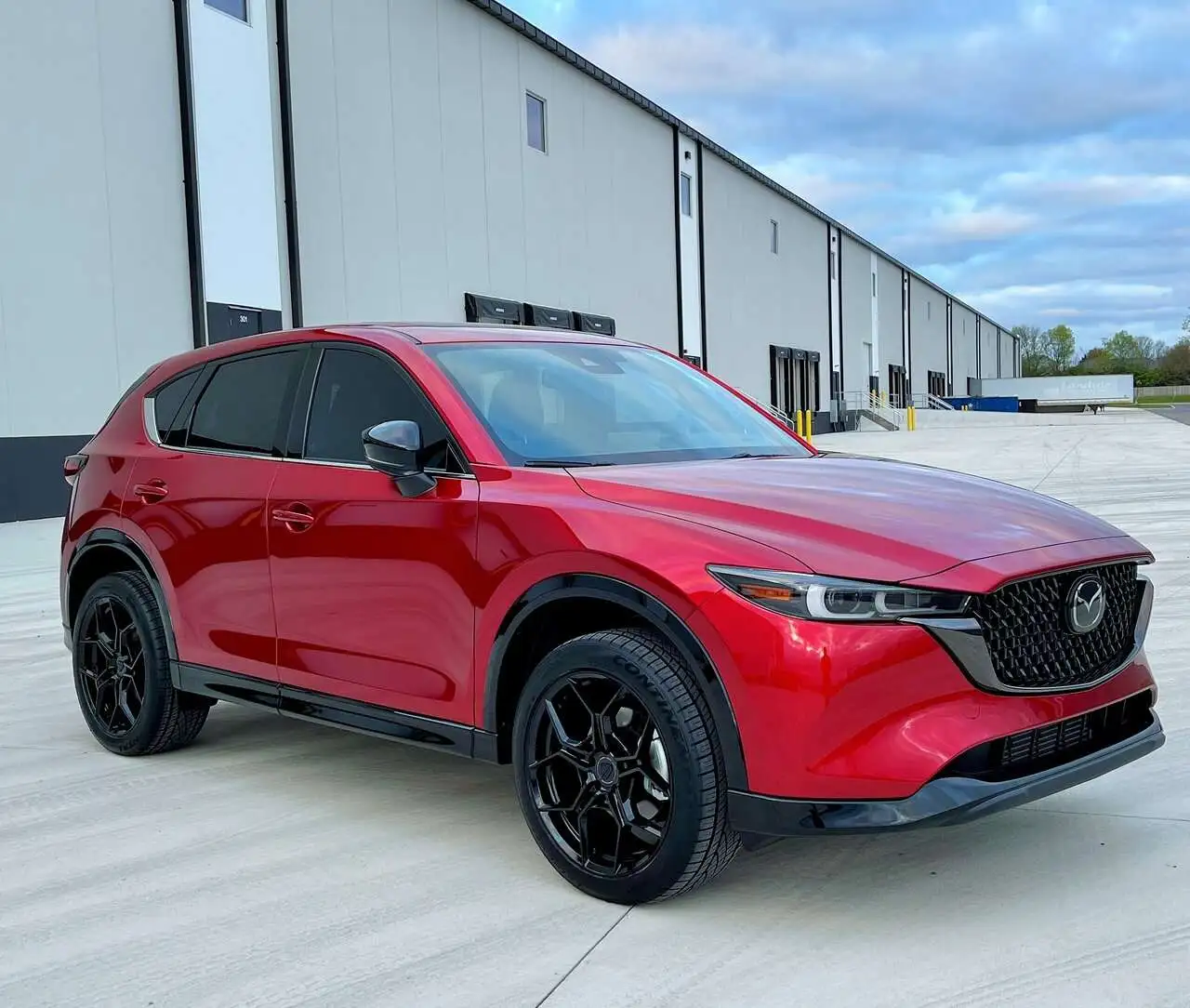

I wanted a flush fitment. I thought about using +45et in a 20x10 but decided I didn't want the extra weight or trying to make them fit.
255/45 +35 isn't flush though, it pokes beyond the fenders. We all have different preferences through, and I'm especially anti-poke :)
When I measured with a string from the fenders, it would take +28mm for the wheel face to be flush with the fenders. Therefore going to a 9" wheel (1" extra on the inside and 1" on the outside) at stock offset will get you very close. Then you have to select a tire that is also appropriately sized.
Further supporting my research was this post from @ziggi testing 20×9 +35.
When I measured with a string from the fenders, it took +28mm to be flush with the fenders. Therefore going to a 9" wheel (1" extra on the inside and 1" on the outside) at stock offset will get you very close. Then you have to select a tire that is also appropriately sized.

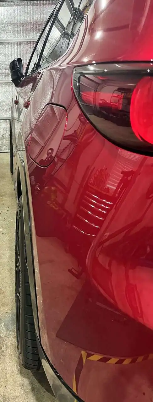

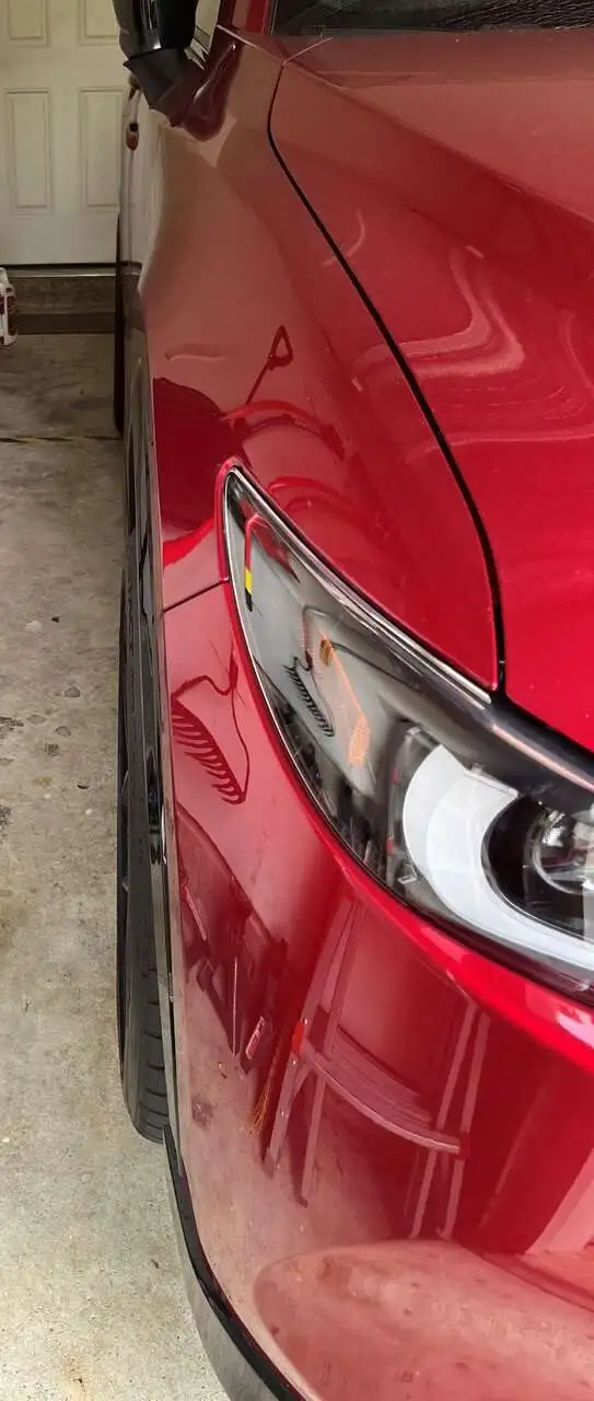

Looks like he test fit at full droop where the camber curve goes positive causing the wheels to stick out more. I wanted my wheels flush with the bodyline, if the tires poke 3mm NBD. I did my own research and it resulted in exactly what I wanted as this is not my first rodeo.
View attachment 328151View attachment 328152

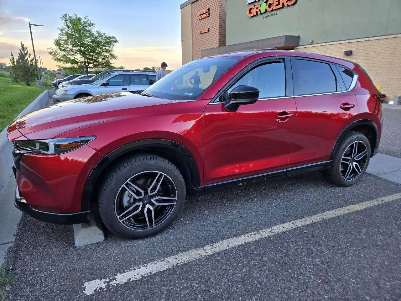

Looks good. Reminds of another setup using 9.5 et40 wheels and a 275 tire. Had about the same amount of poke as you.
Does look good. PlusarKF, you're probably right, I hadn't considered the suspension being unweighted. I read every post on this thread at least three times trying to find someone running this setup and showing the flushness like you have. Couldn't find it and I ended up going conservative with an 8.5 width. I really do wish I'd gone wider as even the 255s on the 8.5 still feel a little skinny to me. Like N7Turbo, I didn't want any poke. Congratulations to you both though. Enjoy your purchases!
IMO that is poking out a little. If it takes +28mm to get flush, and you add 1" (25.4mm) of wheel width plus another 10mm from the offset, plus about 5mm from the tire, you would be out a total of ~12mm. That's why I kept to the stock offset.
But regardless, you're the only one who has to like it! And it looks ok.

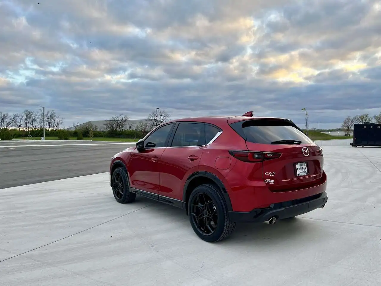

I'll find out in a couple of days what mine look like on the car. As I was doing the ceramic coating the other day I started to think 255/45 might have been better than 245/45, but there's a fine line between perfection and overshooting, plus there's no going back now. Here's hoping you don't see a set of new DWS06 Plus for sale due to OCD.
Using stock wheels I installed 25mm front and 30mm rear spacers to reach the effect I wanted - a few mm of poke at the wide point near top of the tire when on the road. Be aware the front and rear are different by about 5mm so wheels with the same offset will look different on each end of the vehicle.

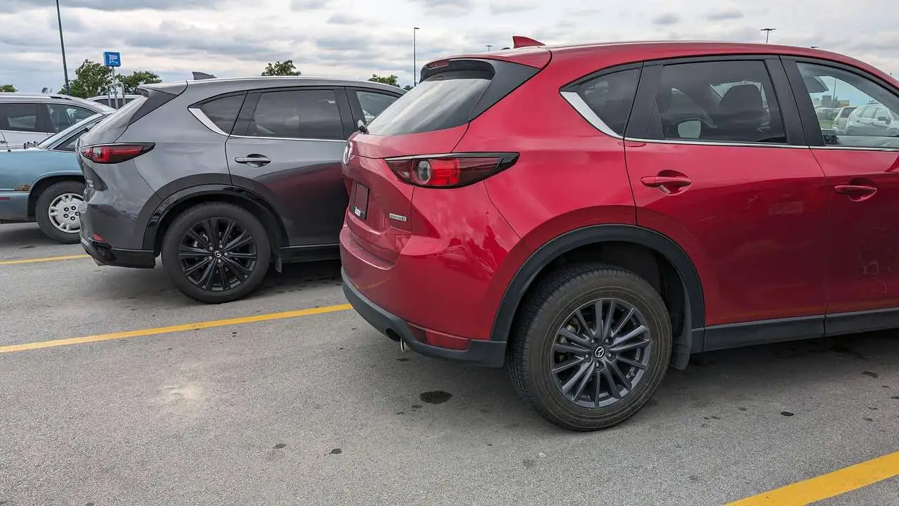

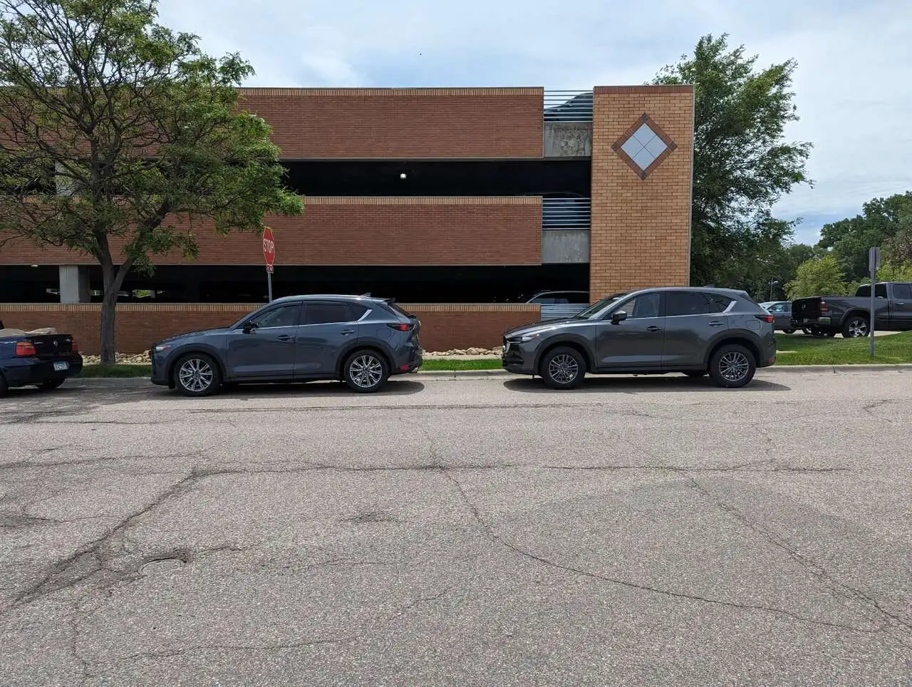

These aren't aftermarket but they are wheels and it's an interesting picture :)
In front on the Soul Red Crystal car are 17" wheels and 225/65 tires with stock suspension.
In the back is my Machine Gray Metallic on 19" wheels with 225/55 tires and 2" Corksport lowering springs.

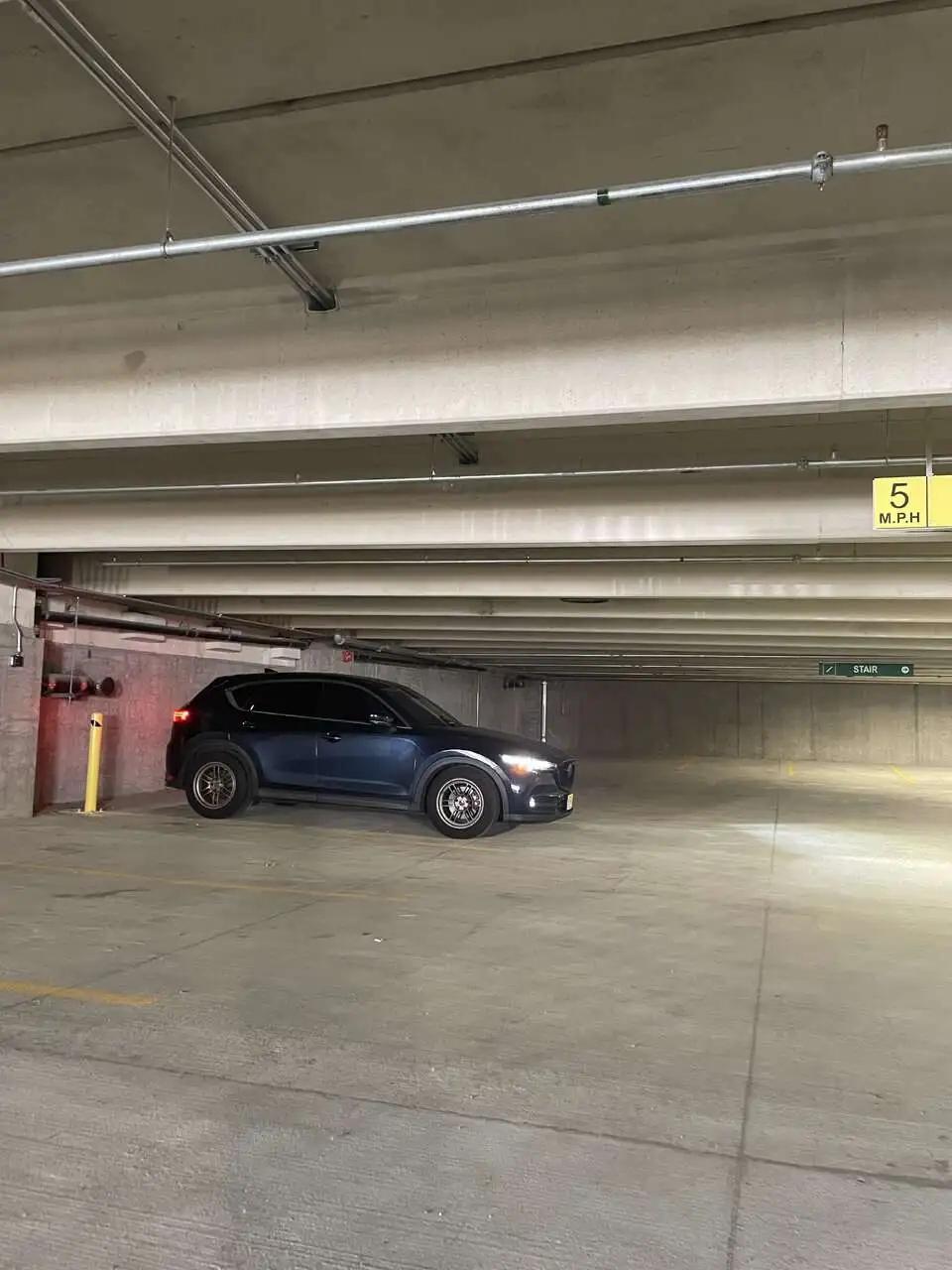

Similar comparison
