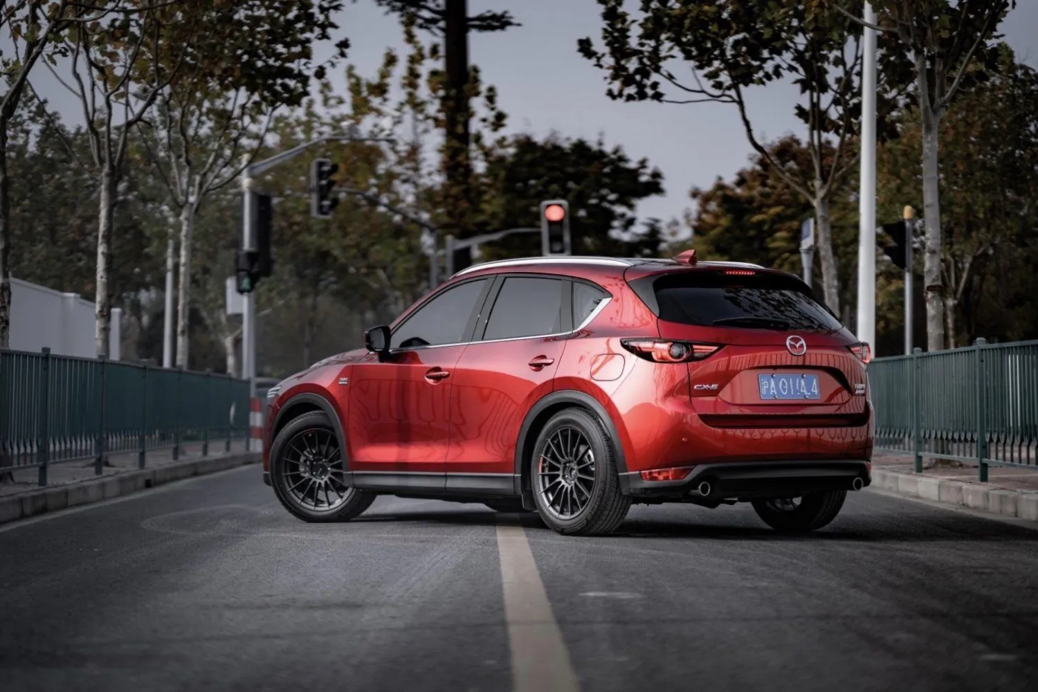

Why are all of the pictures with the car blocking other people's space? Is it like the dripping caramel, jam, or sauce in food pics?
Probably (meaning it's just for presentation). I'm sure @zolo0727 doesn't actually park the car like that 😁

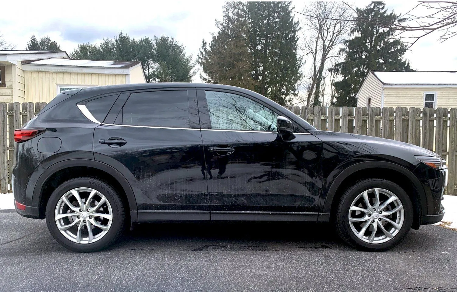

Hey Gang,

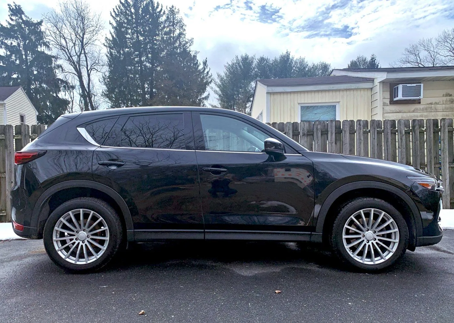

New to the forum as I just picked up this 2019 Grand Touring Reserve in January. I love this car so much, the only thing that I did not love was the "twisty" style 19's with the narrower 225 tire. I went ahead and ordered the M011 wheels from Canada along with 245 / 50 Continental DWS06 tires. When I got them they were dark gunmetal and out of the box I loved them. However after putting them on my Jet Black Mica CX5 they were too dark personally for my taste. A friend of my has a wheel repair shop so we powder coated them Prismatic BMW Silver which I think gives a nice contrast off the black paint. You can see this in the image.
Fast forward about 4 weeks and the same friend gifted me a set of TSW Mallory's that a customer didn't want and left them at his shop. They were black, but we powder coated them in the same BMW Silver. The TSWs are much lighter than the M011 by about 5 lbs each. The one thing that I did notice is while handling and acceleration are better on the TSWs I can definitely feel way more bumps in the road almost as if I went up to a larger rim with a shorter sidewall, but the wheel is a 19 with the same tires that I had paired with the M011 wheels.
Has anyone ever experienced feeling more bumps in the road going perhaps from a heavier wheel to a lighter wheel and keeping the same tire? Handling is definitely better, and I guess that's a tradeoff, but wanted to get some opinions. I am thinking that if I can't get over the harsher ride, I might sell the TSWs since they didn't cost me anything, unless there is something else that I can do to alleviate the change in ride quality.

Hey Gang,

M011 wheels look better in my opinion. The harsher ride has always been a trade off with sharper steering, when going with a wider tire in my expierence with previous vehicles. I'd be curious if you notice a gas mileage difference with the heavier wheels, 5lbs. sound like a lot when talking about rotational mass. BTW hold onto that friend that will gift you a set of perfectly fine TSW wheels, always good to have a friend in a wheel repair shop. Congrats on the car also, looks great with whatever wheels you choose!
Hey integ3,
Thank you for your opinion and response on this. I like both wheels, and like I said the M011 in the gunmetal was beautiful, it's just that when I put it on the black car, they just looked too dark, not quite the look I was going for and I think the silver actually shows off the lines and details of the wheels nicely. I am not 100% sure about the look of the TSWs myself yet, so we'll see what happens — especially if I can't get used to the ride difference. I think it has a little bit more of euro vibe maybe with the TSWs. The friend I am referring to is a childhood friend so we go way back. Definitely a good friend to have.
TSW lists that wheel at 25 lbs, and I think the UPS listing for each box of the M011was like 31.6 lbs, so I'd guess they are about 30 lbs minus the box and packaging. Both wheels are 8" wide, an I am using the same tires on both. The TSW is a 40 offset, where the M011 is a 45. I didn't notice any ride quality difference from the stock wheels to the M011 so this is only with the TSWs. Wasn't sure if the weight is the difference, material of wheels, or possibly the design even — 15 slimmer spokes vs 10 chunkier spokes. I suppose there are many variables at play.
Hey integ3,
I 100% agree on the color choice, I have always been a believer that the wheels should contrast the color of the vehicle, if you had a white or silver CX-5 maybe the gunmetal would have been better. But the silver looks great on your black one! Another few things to consider might be cleaning those TSW wheels might be more of a pain in the butt compared to the M011 wheels. Also that slight difference in offset might give the wheel and tire more of a flush look when looking down the side of the vehicle, but 5MM is not that drastic of a difference.
Because there aren't a lot of Jet Black Micas in this thread, and the M011 is a popular wheel choice, I am also posting a lateral shot of the M011 here on black before I powder coated them silver. This is the original gun metal color on Jet Black Mica.
Thanks for watching.
Those pictures was made on Saturday early morning in an area by the river and no one will be blocked at that moment LOL.
