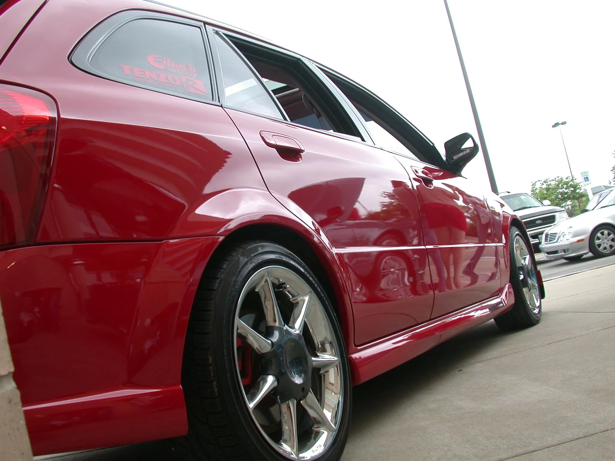

yes, you can see my pic in my sig. we took some welding wire and ripped the molding right off. then took what they call and adhesive eraser on a drill and got the glue off then buffed the car and it looks so much cleaner.
here is another pic of mine with no side molding

Most definately do it. It looks much much cleaner and is something anybody can do. Just make sure you have the patience to sit their and scrub the glue off. Here is a before and after of mine. I have also removed the dx decal since that list pic was taken.
it took me about 30 minutes from start to finish. i had help from a buddy of mine that works at a body shop. it literally took less then 10 minutes to pull the molding off and about 20 with the eraser to get the glue off
It took just a few minutes to remove the molding, but for me it took a couple of hours to get the glue off. I guess because my car is a few years old and it had stuck on their real good.
did you use a drill and the eraser? it would have taken me forever without it.
I just peeled the molding off with my hands. And scrubbed the glue with a rag and an adhesive remover I bought from Wal Mart.
