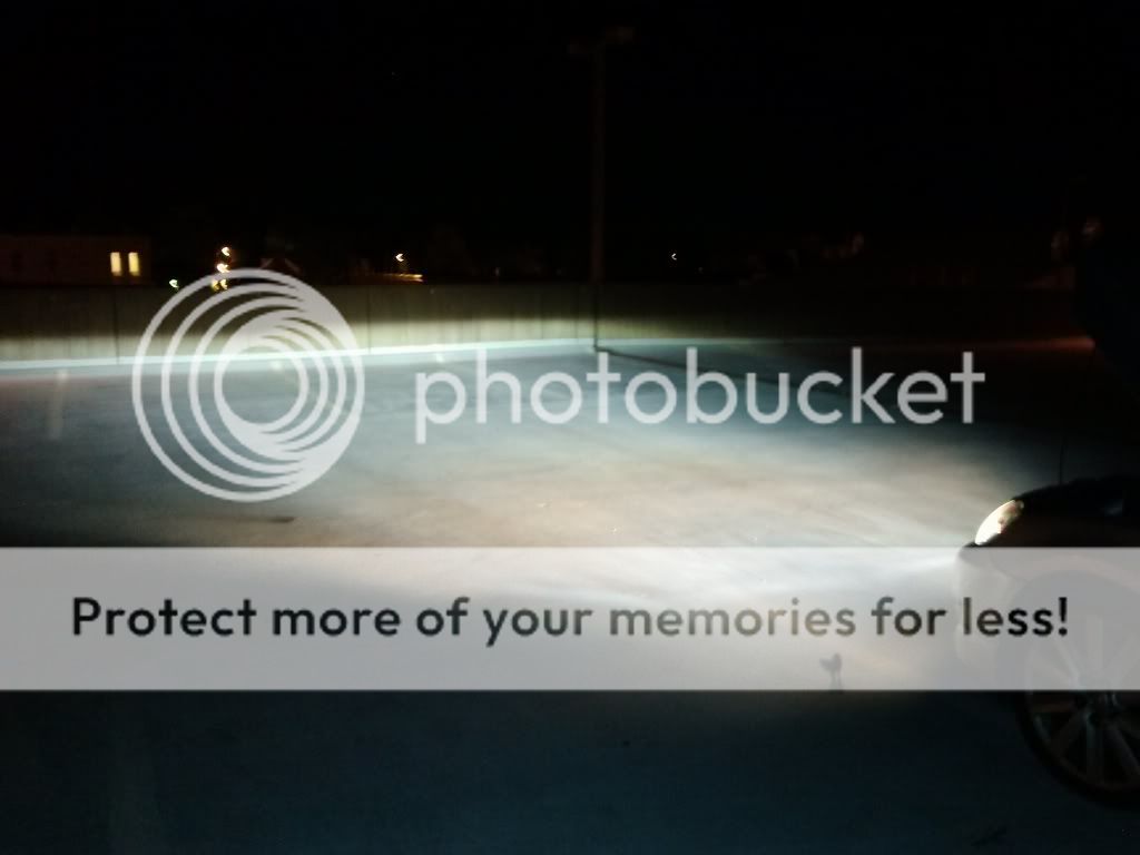

So from the factory, the headlights on most every ms3 are aimed dangerously low. I aimed mine last night using a guide from the HID Planet forums, and now i can see more than 10ft in front of the car at night!
nice ms3. but doesnt yours have the auto-aiming light switch on the left head side of the steering wheel next to the cluster light dimmer? just wondering since my boy has a 08 ms3 GT also and he has the aiming switch to lower or raise the headlights
Yes, at the highest setting the beam ended about 12 ft in front of the car on flat ground, and at the lowest setting, they were about 4-5 ft in front of the car. The pic above is after correct aiming and with the switch at 0. Now the switch actually has a use, i can bring them down if i have a ton of weight in the back. Before, it didnt matter since each setting was way too low to begin with!
I always thought that switch was totally useless as well.
oo ok gotcha. damn, that sucks lol. but good thing you were able to get them aimed correctly.
Yep, without adjustments to aiming...it really was totally useless before!
Yup, mazda did a good job making it a pain in the ass to pop the covers for the aiming screws off...but otherwise it was simple. Took maybe 10 minutes to get everything lined up properly!
