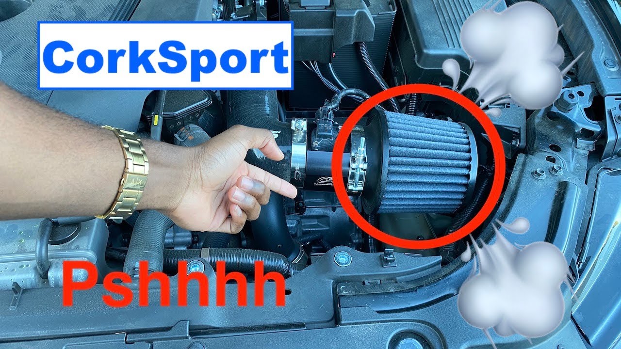

I have the CorkSport short ram intake on my 2019 CX5 turbo and I have noticed that under load it will whistle like when you blow over an open bottle. It's actually quite annoying. I might swap back to stock if I cannot think of a way to make it stop. I have double checked to make sure all the clamps are secure and there are not leaks as well. Anyone else having this happen as well? I saw someone mention in a youtube video before, I will have to look it up again because he does get the car to make the sound with the CS intake. Any ideas?

The sound is more prominent with aftermarket intake and a lot of people actually like the sound (including myself). The sound you hear is from the wastegate or blow off valve to bleed some of the positive pressure off.
I figured that sound would be more of a hiss than a whistle though. If that it what it is then I could be alright with that. As annoying as it sounds. The guy captured it in the video pretty well around the 7:30 mark.
Hm, I have the intake on my CX-9 and it only sounds like suction and hissing. No whistle sounds.
Has it always made this noise since you installed it? Or did it just recently pop up? I assume the filter element is clean? ... Wonder if there's maybe a hole or a defect in the AEM Dryflow filter itself.

It’s been doing it since install. I removed the filter and reinstalled it making sure there are no leaks and it still does it. The filter is very clean as I have a hydro sock on it. Wonder if it’s making that noise because of how clean it is? I read someone else saying the sound lessened once it started getting dirty. But that shouldn’t be the reason for it. Maybe the filter is defective.

Anyway the noise I’m showcasing in particular is what I’m trying to diagnose as either a normal noise to intakes with smoother bends or if it’s the filter or something making the strange noise. As it’s not normal a induction sound.
I watched the video and I think I know what you're talking about now. Its the noise that starts around 7:34, when the "Hear it?" text appears in the video, right? To me, it sounds almost like an electronic beeping noise.
I do recall being able to hear that beep/whine ever since I took delivery of my car. It's only audible when I floor it, and I have everything in the car as quiet as possible (windows/sunroof closed, radio muted, HVAC off). It's also a LOT quieter in the CX-9. The CS intake may have increased the whine very slightly in my car, but it's honestly hard for me to really tell. Maybe there's just more insulation or cabin dampening in the CX-9 that makes the whine less audible overall?

Yes! The sound at 7:34 where the text pops up is what I’m talking about. I do hear it only when I’m at WOT or even 75% throttle when in manual mode in a single gear. It’s almost like the boost cuts and then that sound happens. You can hear the turbo spool up but then it stops completely around 4200 RPM and that sound comes on. Maybe a valve is closing or the waste gate is cracking open to let out some boost because it’s at max by that point? I don’t know it’s strange.

That may be possible. It just sounds like the turbo doesn't spool anymore after that rpm range. instead I get that noise in the video. I am in california so 93 is non-existent out here unfortunately. I could try 91 and see if it makes a difference.

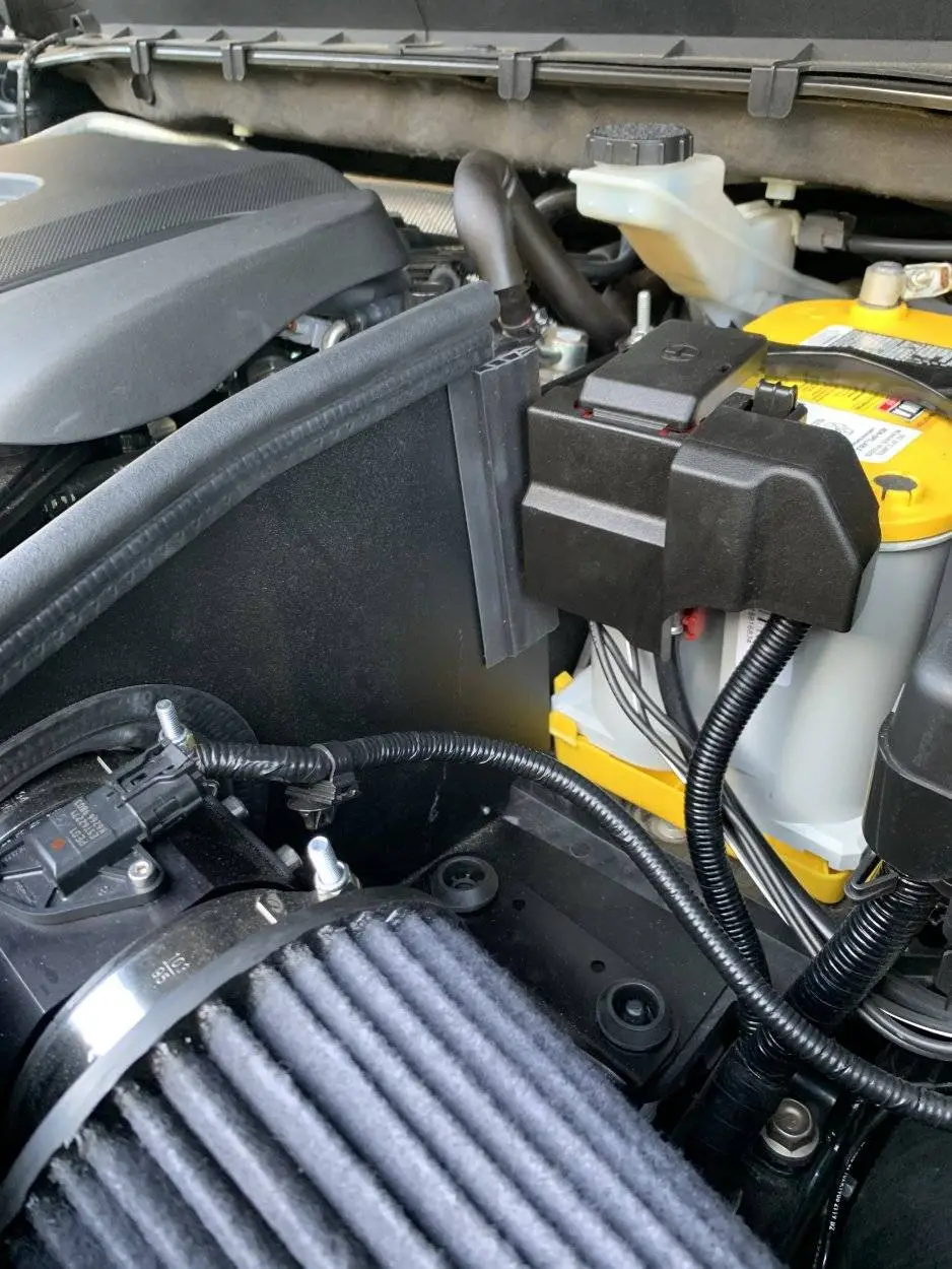

Lmao. I don’t like it. Still have really figured it out either. Are you running the heat shield on your corksport intake?
Yup got the CS heatshield also, even modded the heatshield with some extra weather stripping 😅
Did your snorkel not fit flush on it? Mine doesn’t fit completely into the bottom hole for it. I read it’s a cx5 thing as the Mazda 6 and cx9 snorkel fits in there just fine.
Yeah it doesn't fit completely flush with the heatshield, but after almost 4000 miles it's running fine!
Yeah it just bugs my ocd sometimes. Almost want to just take the snorkel out completely lol.
Go for it! No reason to have it on there since the OEM filter box isn't used.
The OEM box is sealed, so any air being pulled in comes through the snorkel. Since the CS intake doesn't have a sealed box, it pulls air in from the area surrounding the filter only.
