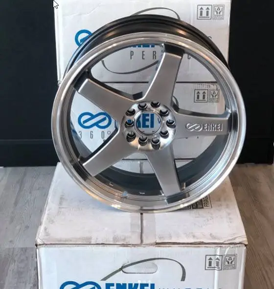

Looking forward to purchase Enkei EV5 Hyper Black with Machined Lip Wheels . Not sure if to choose 17"x 7.5" or 18"x7.5". Also, unsure of the offset that I need to choose. Any recommendations? I am looking at a racing look. Attached is a pic of the rim. Please your guidance is much appreciated.
I believe the OEM Mazdaspeed wheels were 17x7 +42 offset? I was able to fit 16x8 +47 wheels on my Protege sedan back in the day... I would go with the 17x7.5 +45 and a 215/45-17 tire.
Would it have an aggressive look?
Do you have any other suspension mods? The +38 version will push the wheels out a little bit more. In theory, they should fit OK with 215/45-17 tires, but you should be prepared to roll fenders or add more camber if needed.
