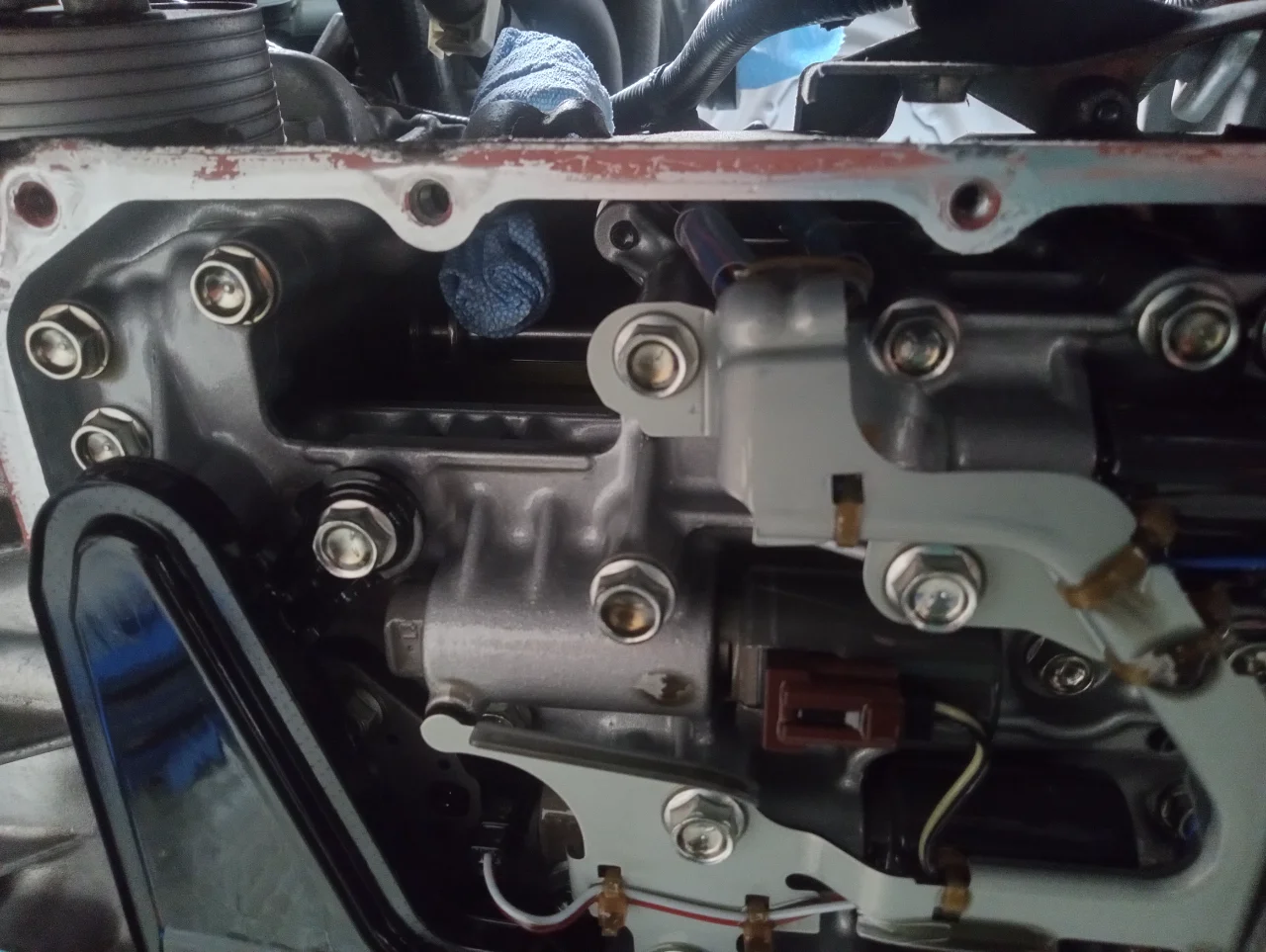

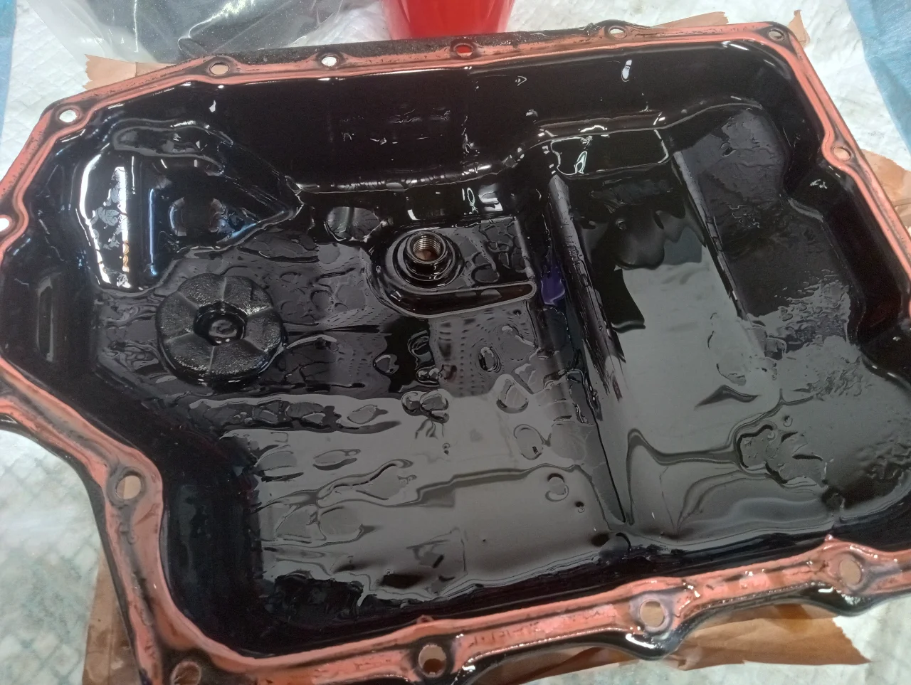

Yeah so I've done drain+filter+fill for the transmission fluid on all of the vehicles I've owned, I've also head those arguments. A drain, trans filter change+ cleaning the internal magnet, and then refill gets ~40-50% of the old fluid in the transmission. Less of a shock than doing a 100% flush, I would not recommend a 100% flush personally. If you perform a TCU relearn after replacing the fluid the computer with automatically adjust the engagement points to shift safely. My understanding is that you need to replace the filter+clean the magnets as those elements are catching the wear/debris. If you just do a 100% fluid flush you have the possibility of disturbing the same wear particles which can cause issues. That's just my 2'cents. I disagree that transmission fluid is lifetime fluid but 2 of my cars had over 180,000 miles when I bough them and they shifted fine (Lexus), so if the software update fixes your issues then up to you.

According to these guys' experience, it's fine:
