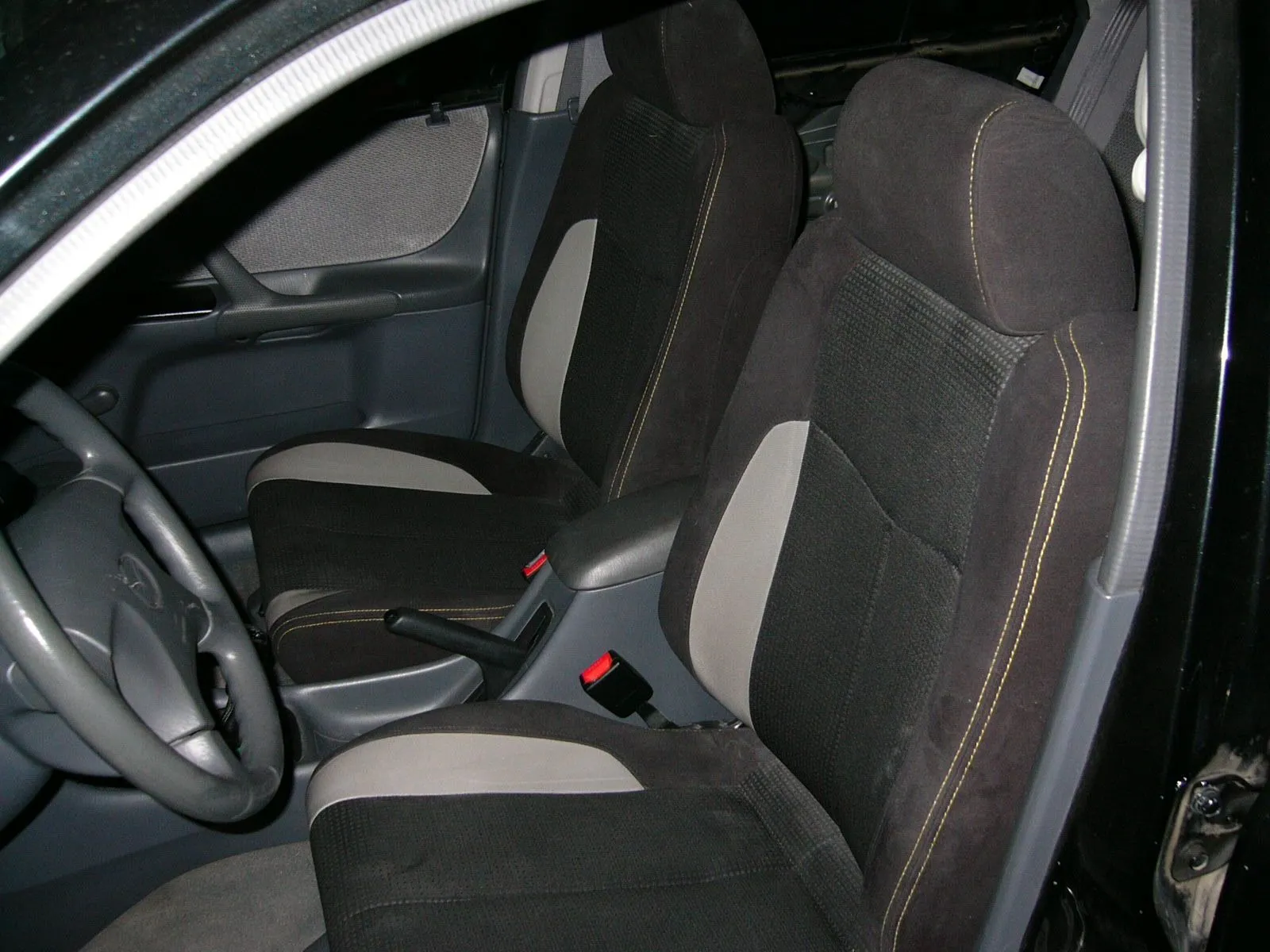

I got the stock grey interior. I plan on getting some new black Mazdaspeed floor mats and also painting the fabric on the door panels black. Maybe that would make the seats not stand out so much? I just really think the LX seats suck....no support at all, and they look kinda plain as well.

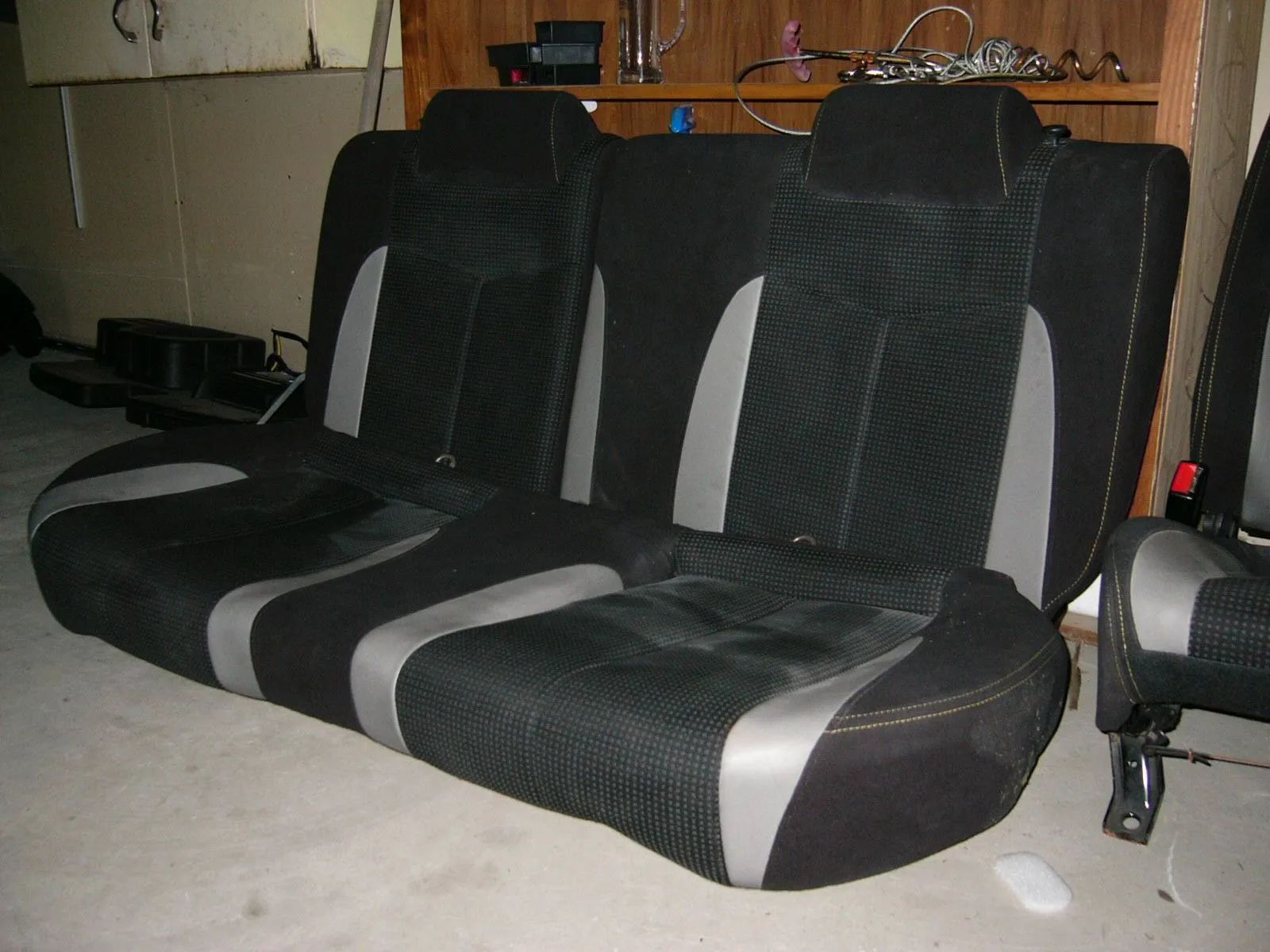

I'm not sure, but I think I paid $275 shipped for the fronts that I bought from Fast Lane and $350 shipped for the rears off a guy on Ebay. He charged me that much for the rears because he was selling the fronts and rears as a set and I didn't need the fronts, so I had to convince him with more money to break up the set. I REALLY wanted those rears.
The rears don't bolt up directly so be sure to take the brackets off your stock rears before you get rid of them and mount them on the MSP rears. I got rid of mine before I realized this, so now I have to go to a junkyard. I don't know why they don't bolt up, it's the same frame. The fronts bolt up just fine.

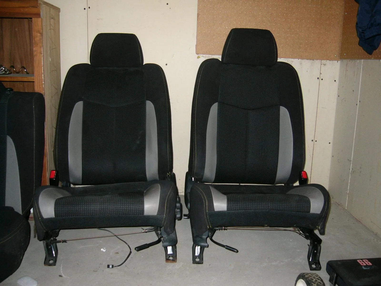

Bought a set of used 2003.5 MSP seats from a guy in Canada yesterday. Should be here in about a week or so. Really looking forward to this swap. I'll post pics when done.

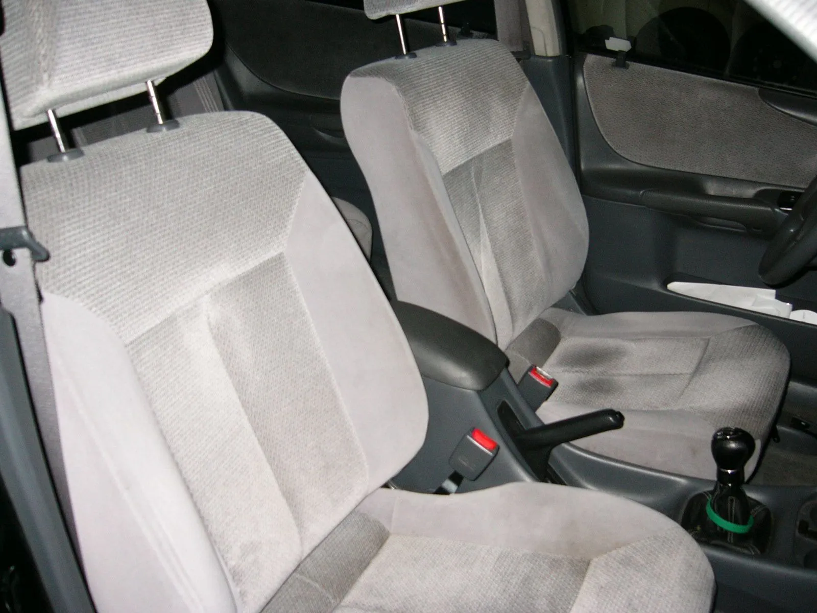

I put P5 seats (F&R) in my LX. I was very happy with the swap, even if it did look a bit odd. Yours should look fine with the Grey interior, mine was tan!

Everything bolts right up. Here are a couple pics......more to come later:
