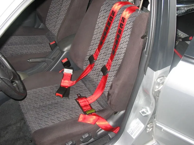

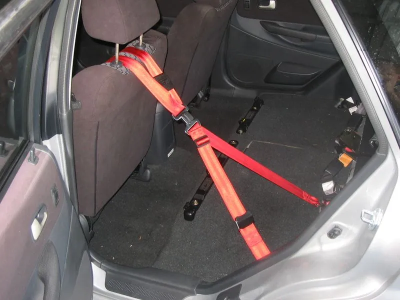

Well I decided on getting a Schroth Rallye 4 harness until I can spend the big bucks on a bolt-in Autopower roll-bar and 5-point harness. As long as I don't roll my car it should be just as safe (if not safer) than my stock 3-point, since I only hot lap my car and don't race. After spending a few hours I finally got it installed!
Some things I learned along the way:
1) Lowe's doesn't stock grade 8 7/16" x 20 x 1.5" bolts arg! The middle-seat rear anchor point didn't come with an OEM bolt long enough (Schroth recommends at least 9 full turns of the bolt), so I went out and bought 3 bolts that are not grade 8 (don't know what grade they were), because according to a guy at Advanced Auto Discounts "he thinks" it should be as safe as grade 8. Anyway, after buying the 3 additional longer bolts I did not end-up using them. It turns out only the middle-seat rear anchor point needed a longer bolt, which Schroth included with the kit. The other 3 anchor points took the OEM 7/16" x 20 x 1"
2) I tried to avoid taking out the seat to get to the right-side front lap anchor point by removing the console, however I ended-up having to remove the seat
3) Disconnecting the airbag connector underneath the front seat was the most frustrating and time-consuming task of all!
4) Great resource for others: http://trackaddicts.net/index.php?option=content&task=view&id=21&Itemid=48
It makes a huge difference for my lapping days. Now my left foot doesn't have to be braced up against the "dead pedal".
