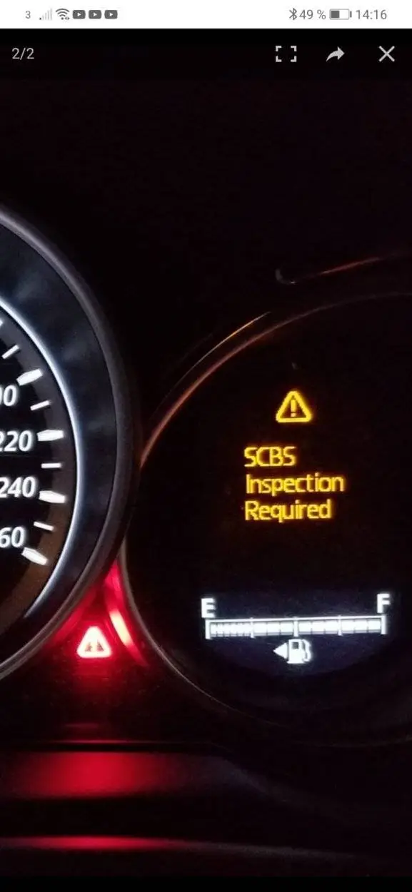

SCBS Inspection Required. What does it mean?
This is showing up on my dashboard. What does it mean?
Solution
SCBS = Smart City Brake Support. Most likely, the sensor(s) used for this system are obstructed. Check to make sure the sensor array at the top-center of the windshield is clean and clear. This notice can appear if the glass in that area fogs up as well.
If that area is clean and clear, and the warning does not go away after turning the car off and on again, you may have to bring it in to the dealer for further diagnosis.

The Smart City Brake Support (SCBS) system malfunction is occurred. It might clear itself but if it stays on, take it to a dealer.
