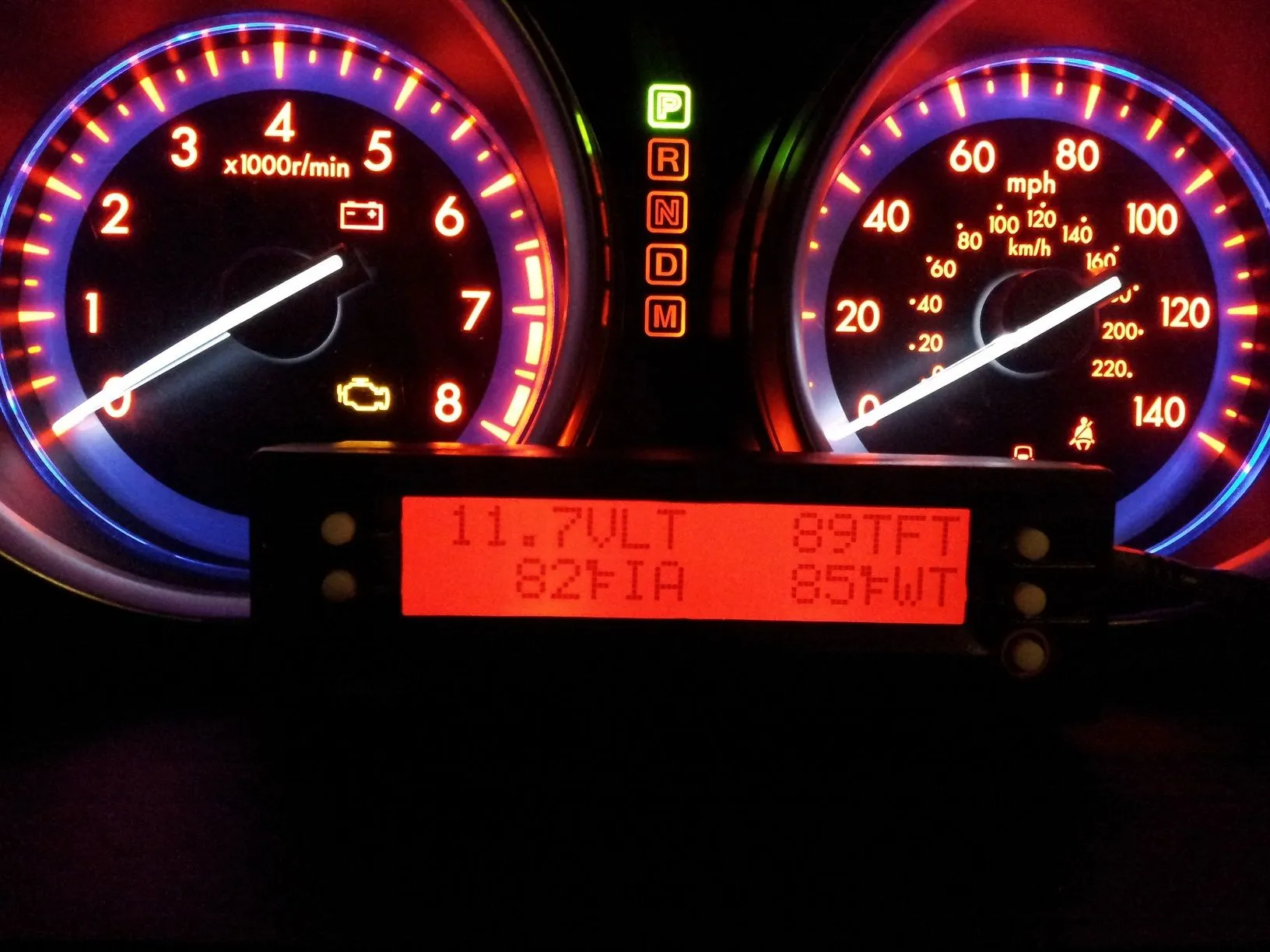

Good News,
To those who have a Scan Gauge II, I think I have figured the X-Gauge code to display the transmission fluid temperature. It took quite a bit of research; Scan Gauge's website code did not work accurately/properly. I did some beta testing today, and it looks good. I'd like others to try the code and report back their results.
TXD
07E1221E1C
RXF
0462051E061C
RXD
3010
MTH
000900500020
NAME
TFT
NOTES
Degrees F
The picture shows the car in the off position, completely cooled, and not started in a couple of days. You will note there is a slight variation in the air intake temperature, water temperature, and transmission fluid temperature. I believe these figures are accurate and the differences are immaterial in nature.
Greg

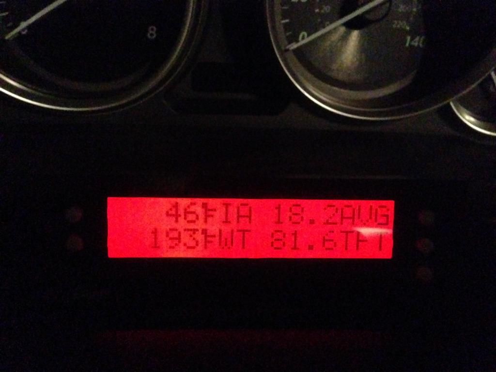

Figured I would revive this thread some, as I'm running across the same issues getting trans temp to read on my 2014 GT AWD. As far as I can tell, none of the earlier codes have worked for me yet (the 6 listed in the thread are also listed on scanguage's website: http://www.scangauge.com/support/x-gauge/mazda-specific/).
However, this Australian code seems to do something. Plugged the numbers in and it read "42.3 TFT". Now, converting from deg. C to deg. F we get 107.6... This was done after the car had been sitting for three hours after a full warm-up commute to work (I was bored today ;) ) . So, at the same time fWT was at 125 and fIA was at 89... Because the fluid in the trans is cooled by the main radiator assembly, this actually seems reasonable. I will report back with more testing, as I should expect under normal load the trans temp should pretty much match the fWT after a normal drive.
Full details:
2014 CX-9 Grand Touring w/ Tech Package - Build date 02/14 (according to door placard)
LinearLogic ScanGaugeII - purchased in 2010, software Version 3.17
Ambient temperature at time of reading: 40 deg F with light breeze. Temp change from 30 deg F to 40 deg F over three hours, parked on concrete pavement.
Used the "Australian Code" for the past couple of days and it seems to be legit. Starts out cold, then warms up with the engine, but slightly lagged.
81.6 C --> 178.9 F
25 minute drive home, stop/go traffic
Ambient temp around 40 deg F.
I guess I'll need to get better at converting deg. C to deg. F in my head! (doh)
Voldsom, thanks for chiming in! I have continued to use this code and remain convinced (now even more so with you input) this is indeed the TFT.
No problem @cpb406! Thanks for finding the code in the first place! Trying to give the CX-9 the love it deserves on this forum. I'm still looking out for a Fahrenheit code, but until then, this one seems to be quite reliable.
