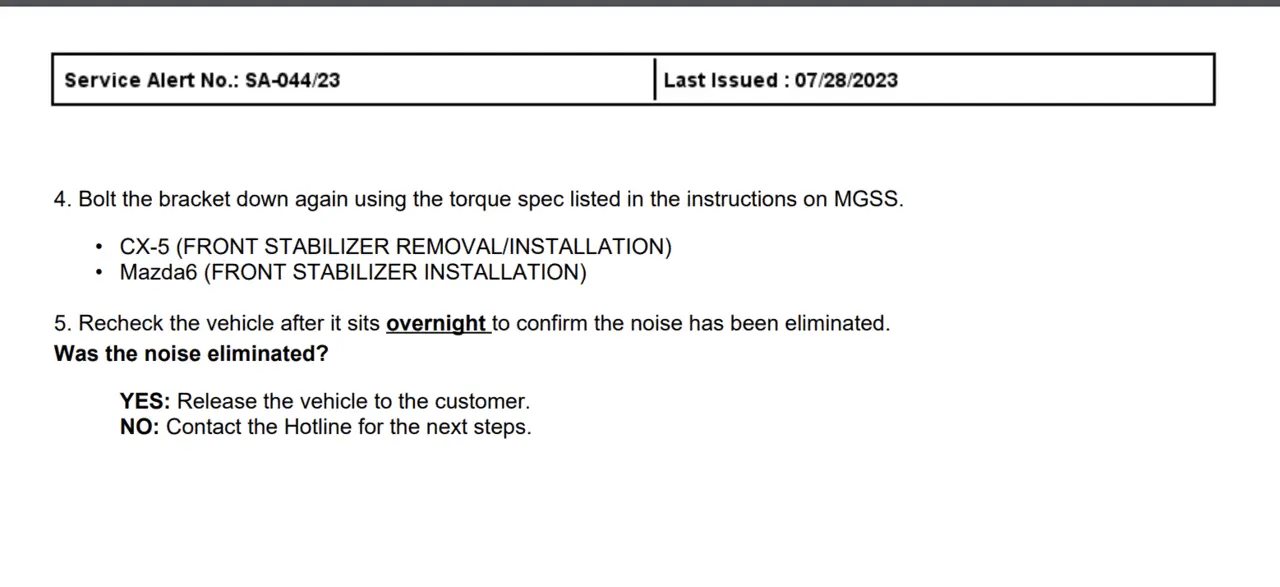

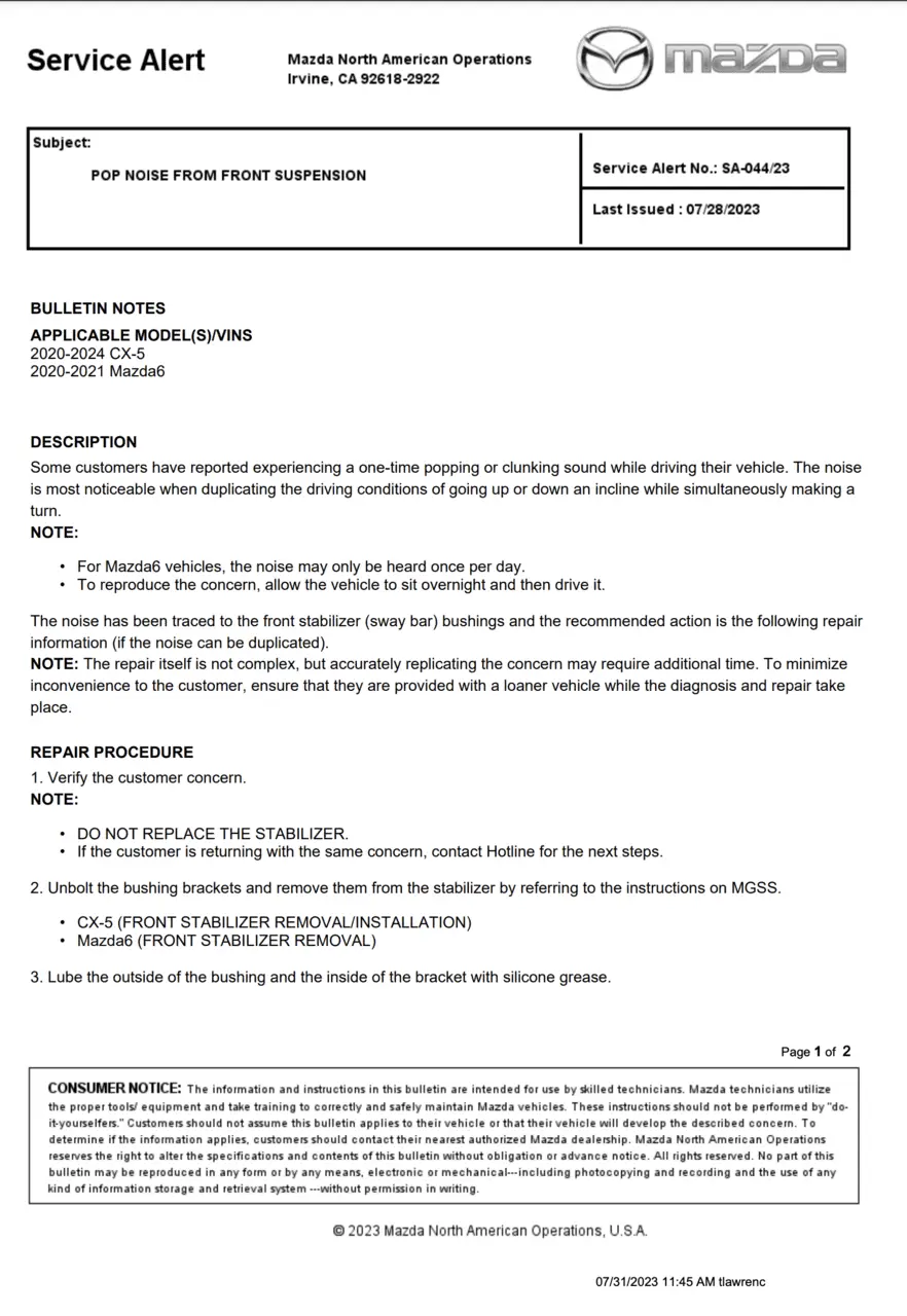

Thanks for posting this! Our 2021 has been doing this for a while going into our inclined driveway. I was dreading struts, but at 31k, struts shouldn't be an issue one would think.
Reading the bulletin, they do NOT lube the sway bar bushings in the sense which is the inside of the bushings which contact the bar. Mazda has stated in another bulletin that the bushings are to be installed DRY onto the bar as lube will cause squeaking in this location. The above bulletin states to lube the OUTSIDE surface of the bushing where it contacts the inner surface of the bracket, not the inner surface of the bushing where it contacts the bar.
