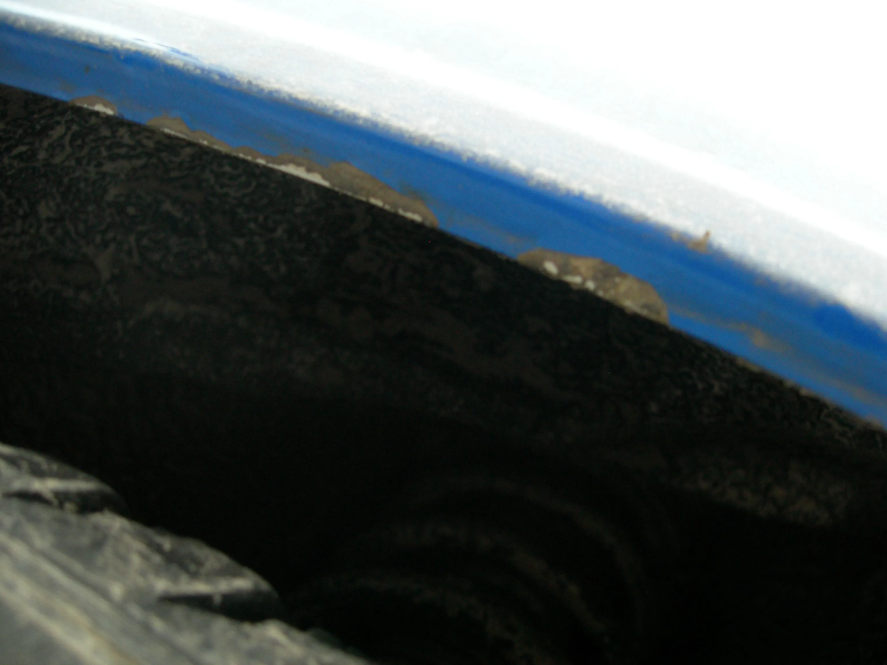

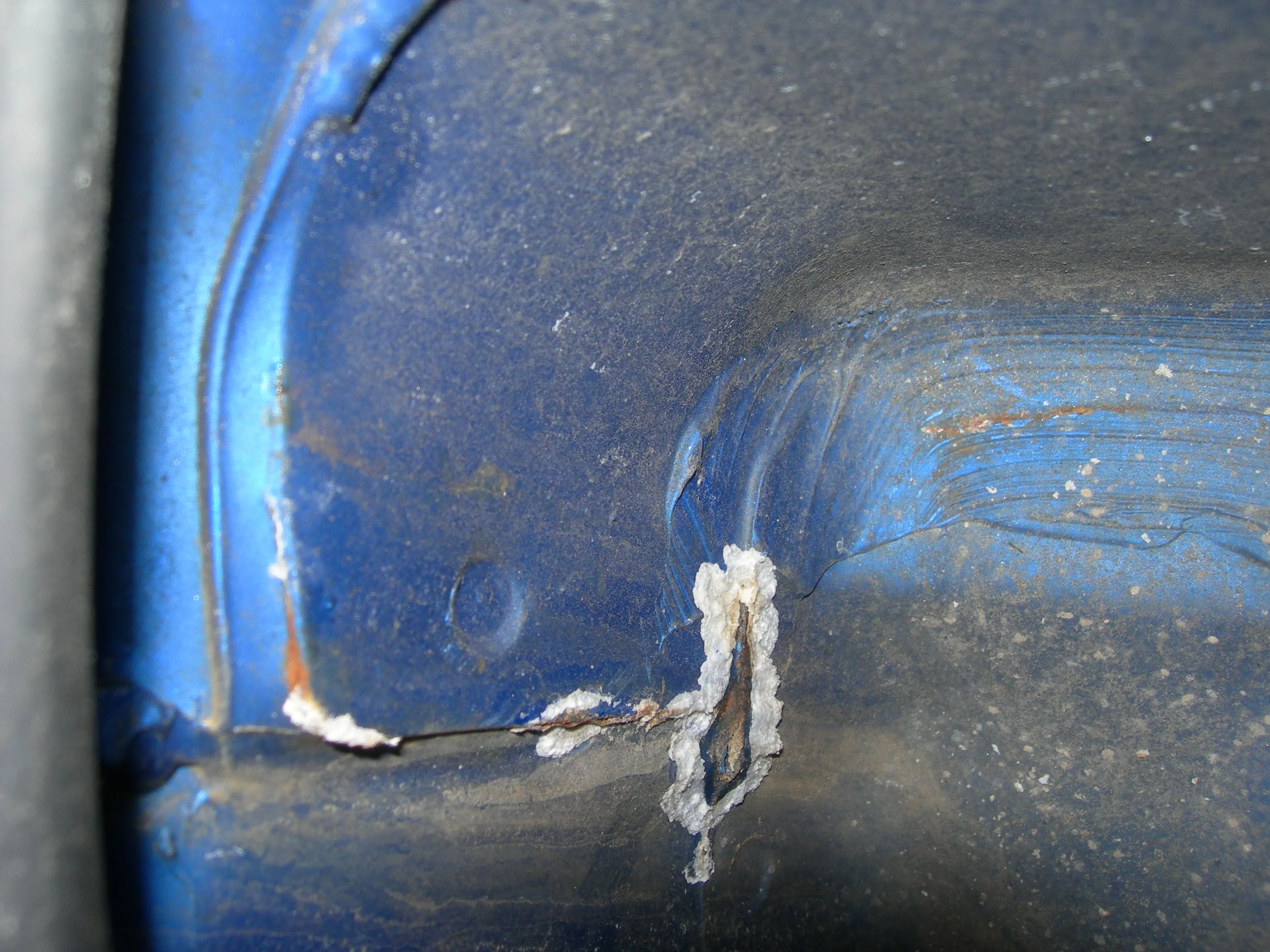

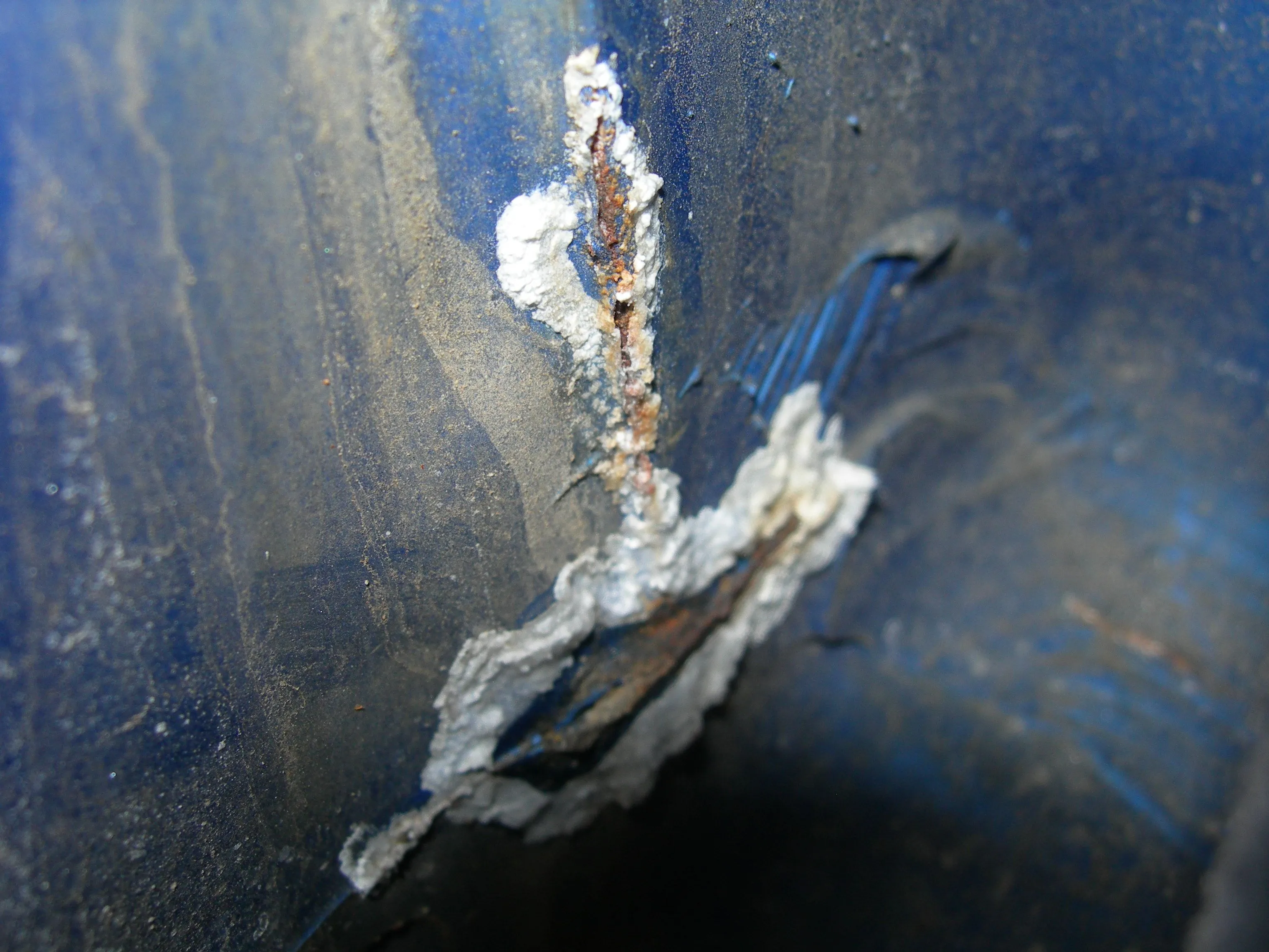

I washed my car last week ...and found some interesting stuff in my engine bay.
There is at least 4 spots like this in the engine bay. Plus the rear fender lips that are starting to chip.
I bought this car to get away from the rust issues with older car, and now look what I have (notcool) :'(
The car was supposebly rust-proofed by www.diamond-kote.com. But its obviously not working well. The D-K stuff has a 10 year warranty against rust. I have a appointment with the dealer next week, so we'll so how this turns out.
So to everyone that drive their P5 in the "Rust Belt"... please...make sure to get the car rust-proofed .

That doesn't look like something a dealer would be effective in getting rid of to me. Maybe covering it up to get you back out the door but eliminating? I'd be real skeptical. Good luck, hate to see it, post up what happens..........

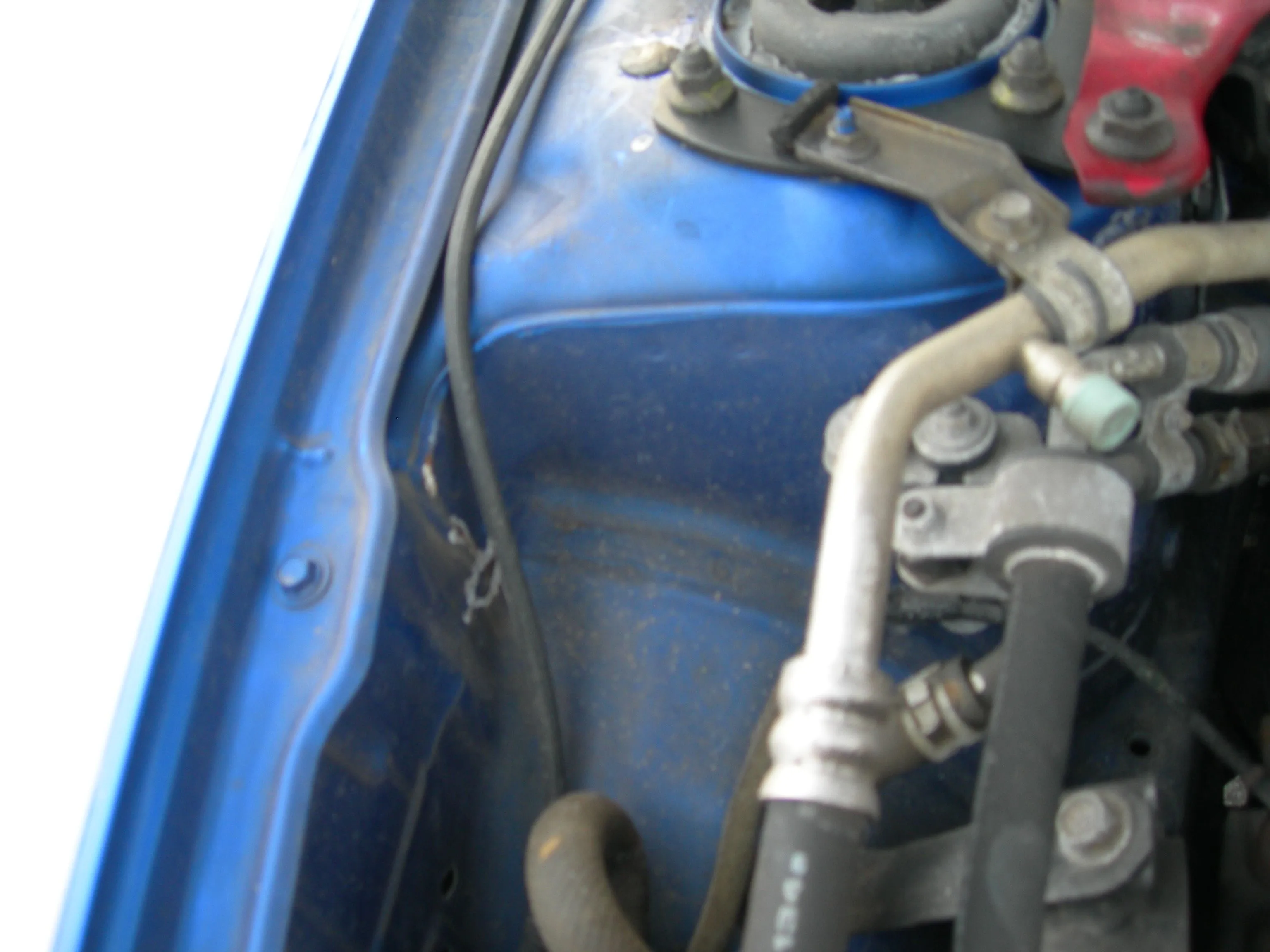

Firewired, my MP3 has similar rust issues. Its in the seam in the same area and the driver side from what I can see has some mild rust issues as well. A body shop guy told me its from the manufacturing process, moisture in the seams. Nothing can be done to fix it, i asked out sand blasting it out but he says all that will do is remove what you can see. There will be rust on the inside of the seam too, kinda makes me wonder how safe it will be in years to come...I don't want my car to break apart at that seam. You will also want to check the rear wheel wells on the rear inside portion, mine had some surface rust from the rubber coating being worn off, I remedied that myself.
I see you also have the salt deposits in the strut towers. When I bought mine last year there was a bunch of crusty salt there, just carefully clean it out with a blade screw driver and a vacuum then spary some Krown all around the tower.
Your friend will be Krown from now on, I get a can every few months and touch up spots.

Cars aren't supposed to rust after 3 years there, whether you clean the engine bay or not. His clearly has a manufacturing defect.

That frame stuff is just surface rust. Wire brush it and spray it. Seriously though dude, judging from the level of filth in your wheel wells it would be well worth your time to get in there and clean your baby out if you want to quit finding cancer. Since they quit making these in 2K3 it isn't really "brand new" anymore, and neglect during the winter can take it's toll quickly. These pictures make me so glad I don't live where they salt the roads, but if I did I would probably be hosing the thing down daily.
Also, "moisture in the seams" during manufacturing is a lame way to explain this problem. What are the odds of that? Anyone ever seen a car factory? They're not very damp places, and any body shop guy that tried to sell me that line would not get my business.
