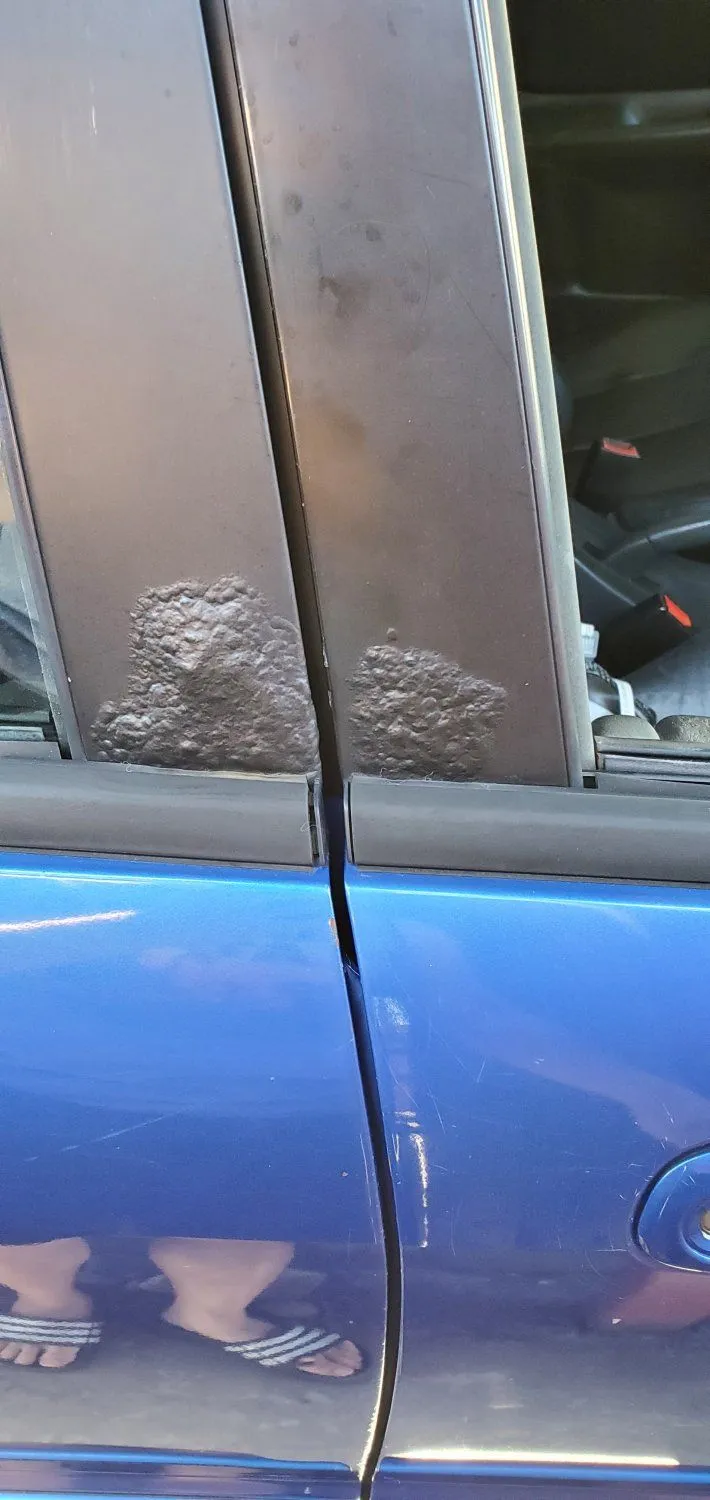

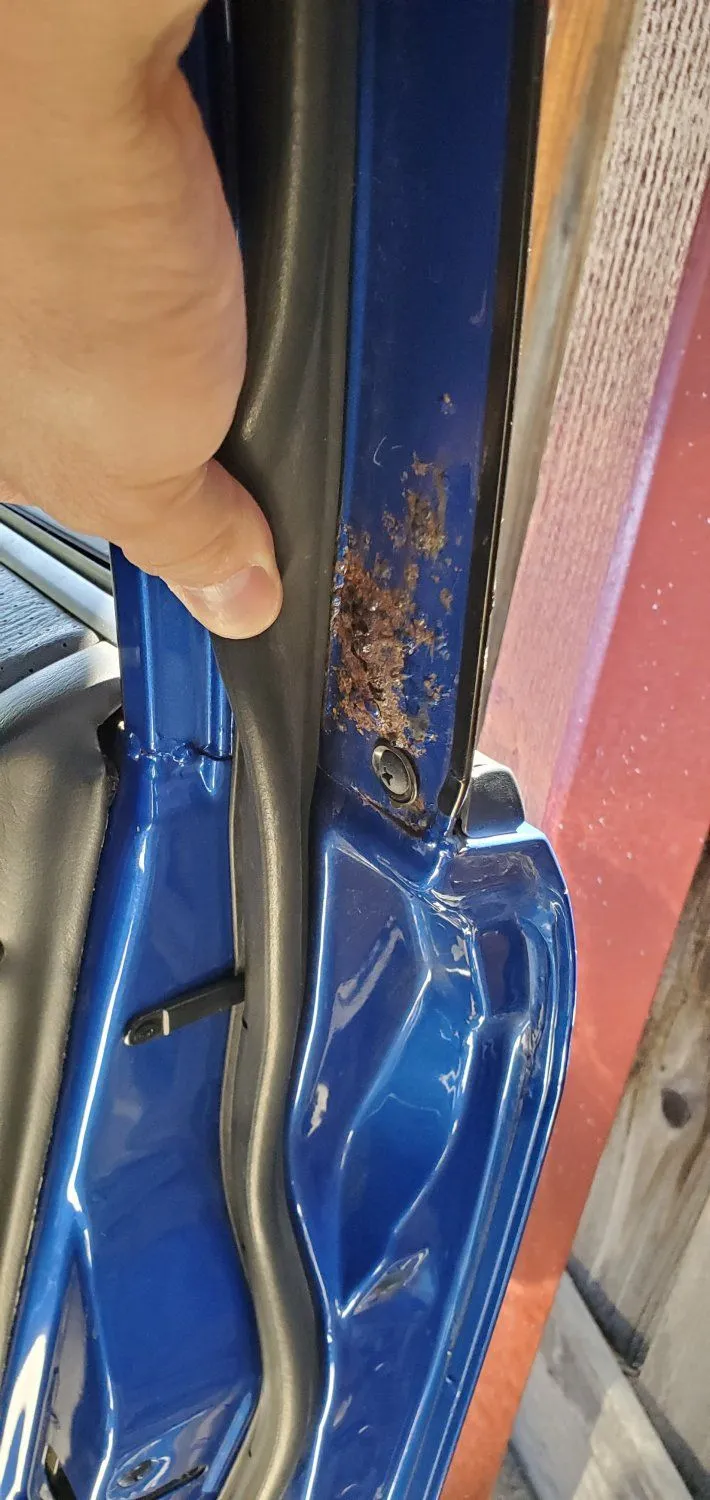

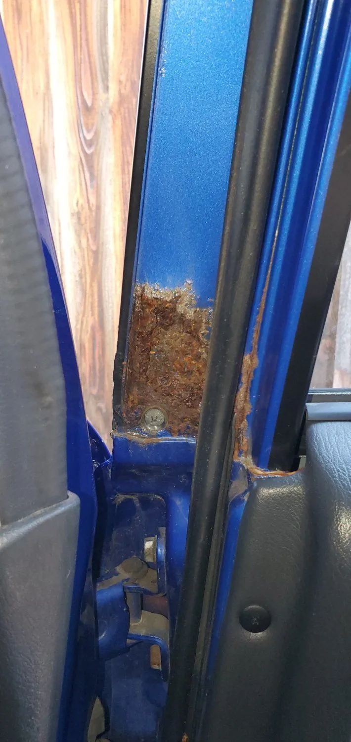

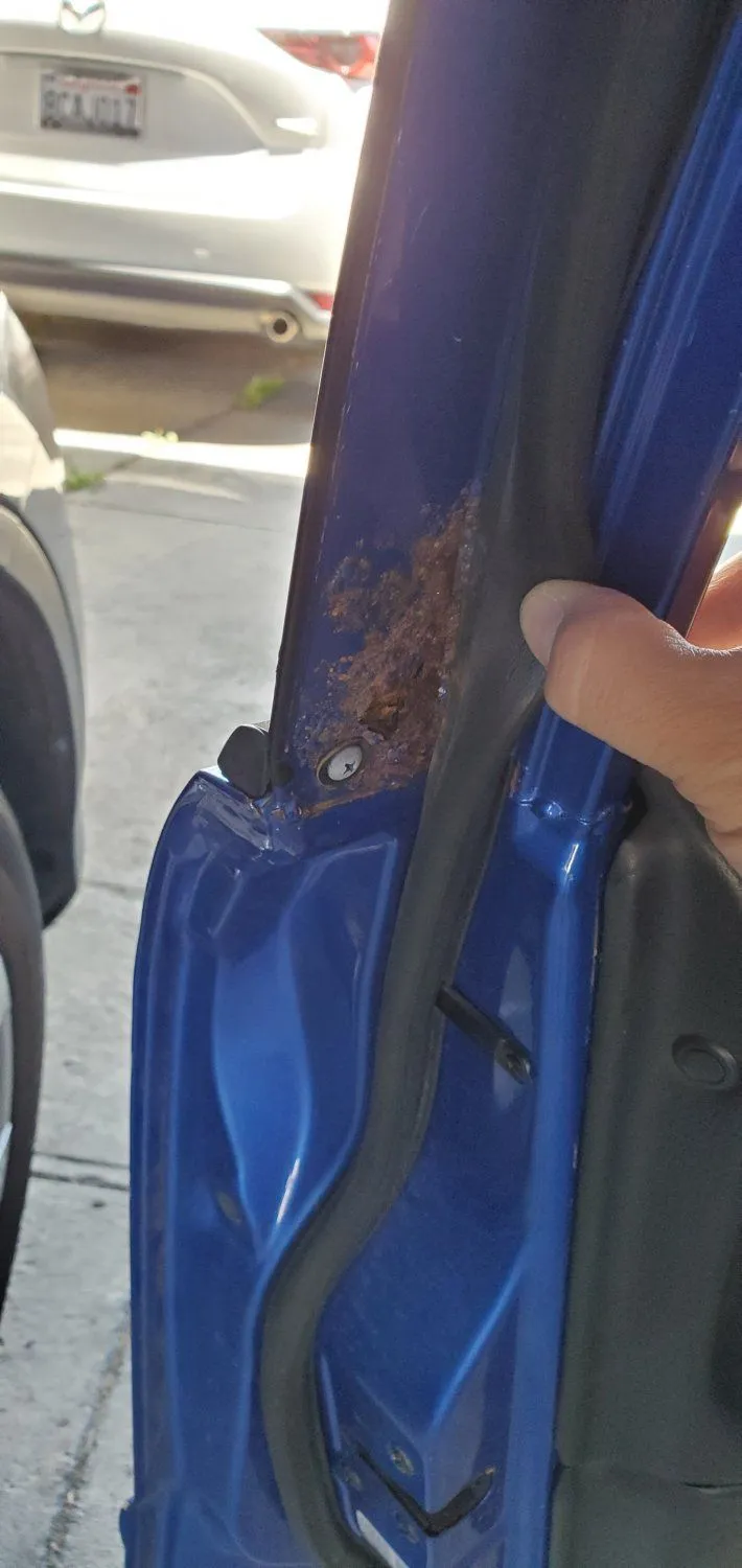

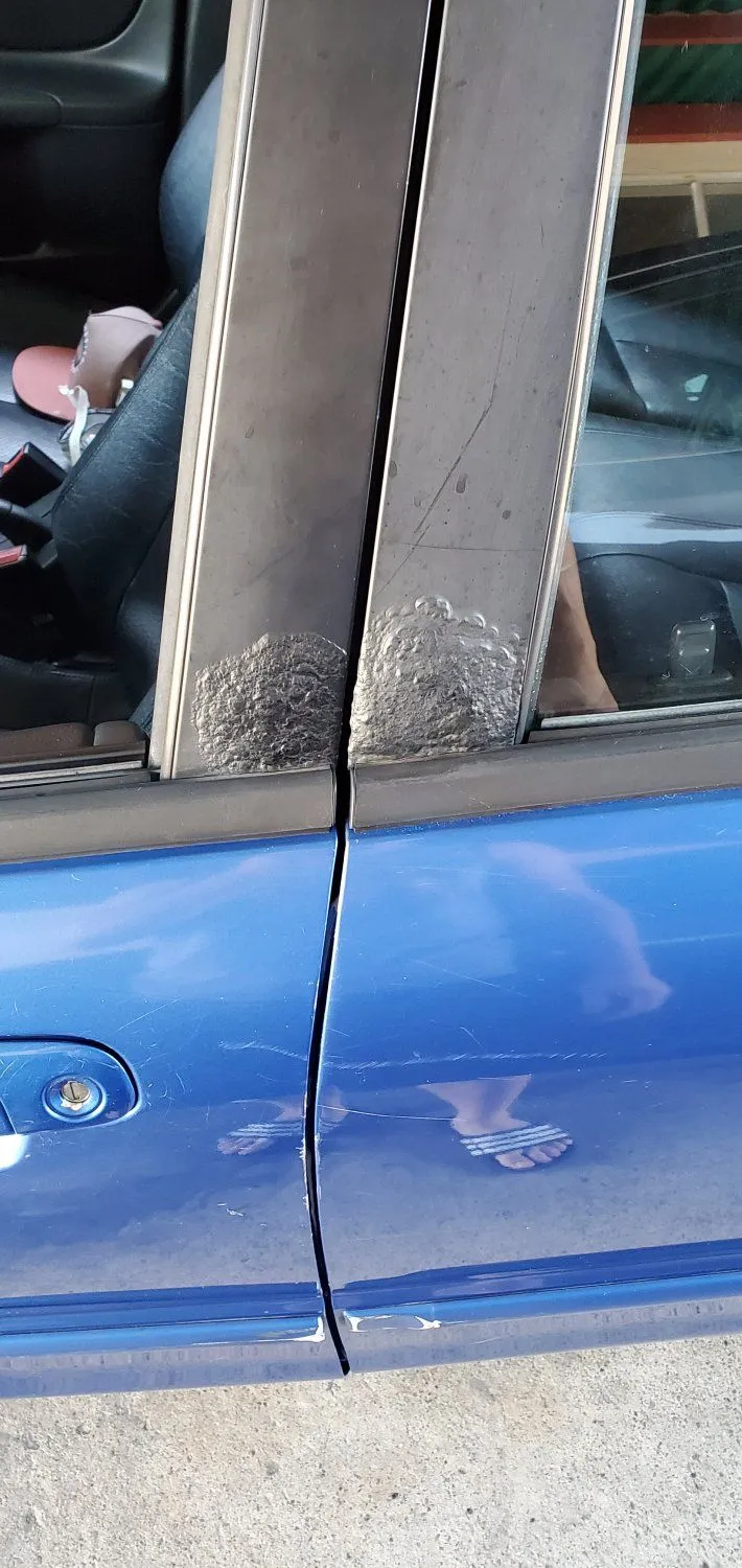

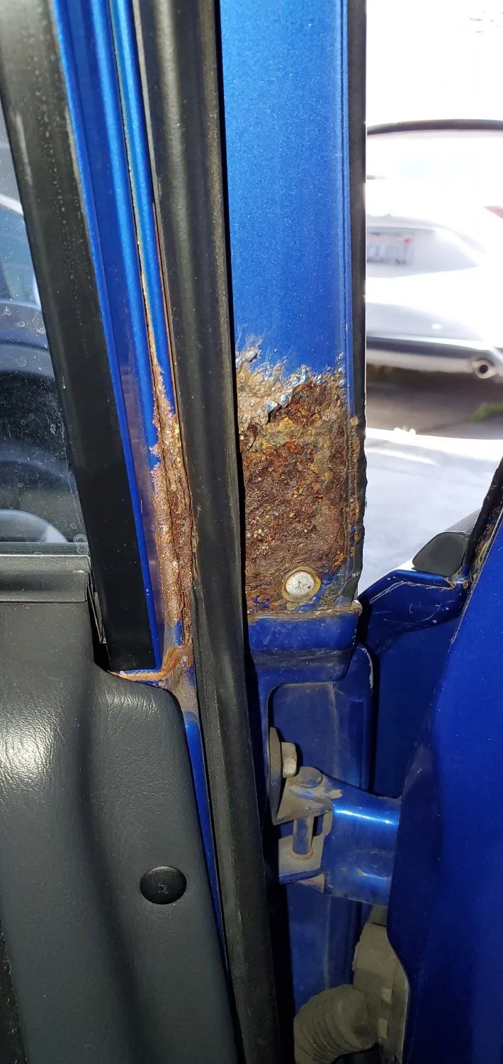

Wondering if anybody had tips regarding rust on door trims. See pictures below. I was looking at the video from Chris fix as a guide and do it as a learning experience. My onky concern is if I sand too much the whole thing may break off. Is it even worth it to attempt the repair ?

If that was my car, I would just scrape off the loose rust then spray it with rust converter, then topcoat.
It would still be rough but it should look better and be sealed up to help slow down the rust.
Yeah, that's pretty bad, good thing that bit isn't structural! My old van had the same trouble in that spot.
Cheapest/ easiest repair would be to replace the whole door, as it'll be a whole bunch of work to cut and replace that section properly. Next best solution would be scrape the loose stuff off and brush some converter/ inhibitor on it.
Yea. I been looking at my local pick n pull to see if i can find one with the same color that doesn't have any rust. I think what I can do is just to do a little sanding and see what happens
Having seen and owned many rusty cars, (including my current Pathfinder), I can tell you that door rust is deep into the bones of the structure.
Scraping/sanding the loose surface rust and touching it up is cosmetic at best, and will not fix the core problem unfortunately.
Like others have stated, your best best is to see if you can find a donor door at a wrecking yard.
