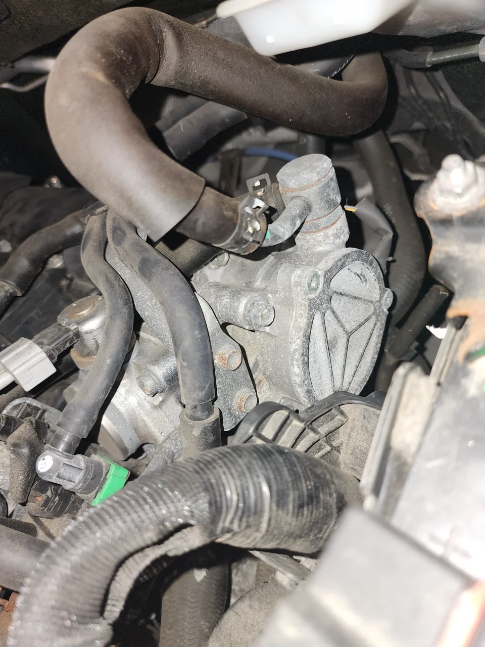

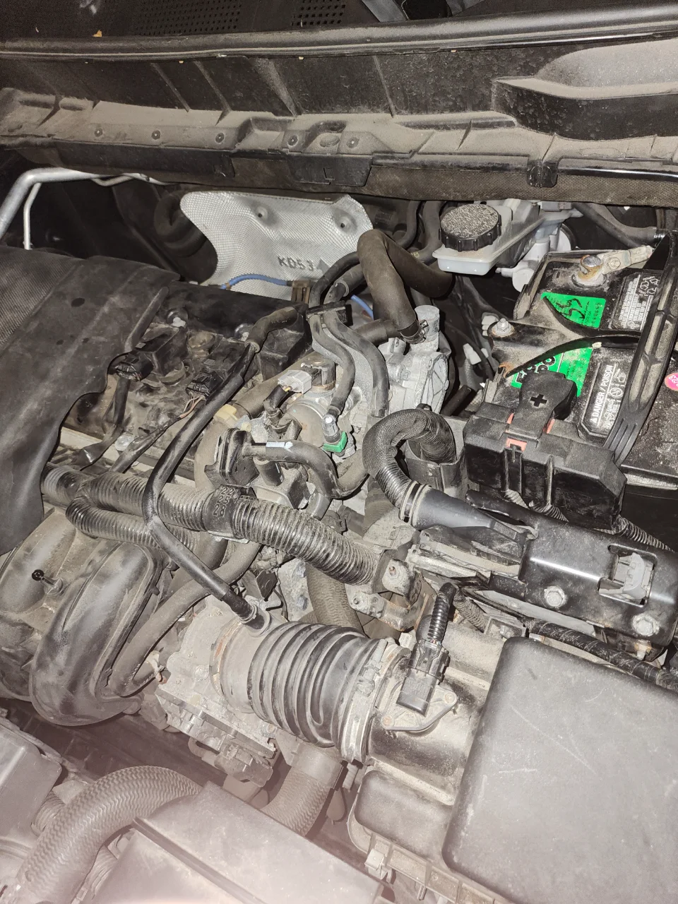

Just to give a update I tested the altinator and battery needed a altinator did that . Vibration was still their checked transmission mount it was dead so changed those thre now I have the vibration all the time now it's sounding like a grinding noise looked at it I think I found it looked the part up but all it says on mazda is rear assembly can anyone help me with this and if they have ever replaced it attaching photo and a video.

Looks like the vacuum pump that supplies vacuum to the brake booster for the power assist. You may find some youtube videos on how to test or change. No instructions in the shop manual?

Not really it is one of the only things that is very vague that would exsplain why I originally was putting around at idle if I turned the wheel all the way the car would stop not stall just stop . That's why I originally started with power because of the steering being all power . I'm just thankfully everything I have replaced so far needed to be replaced
Here is a link to a discussion that contains service manual links. In there, for the manual for your model car, you can find the "vacuum pump" chapters -- click.
"Vacuum Pump Inspection"
"Vacuum Pump Removal/Installation"
