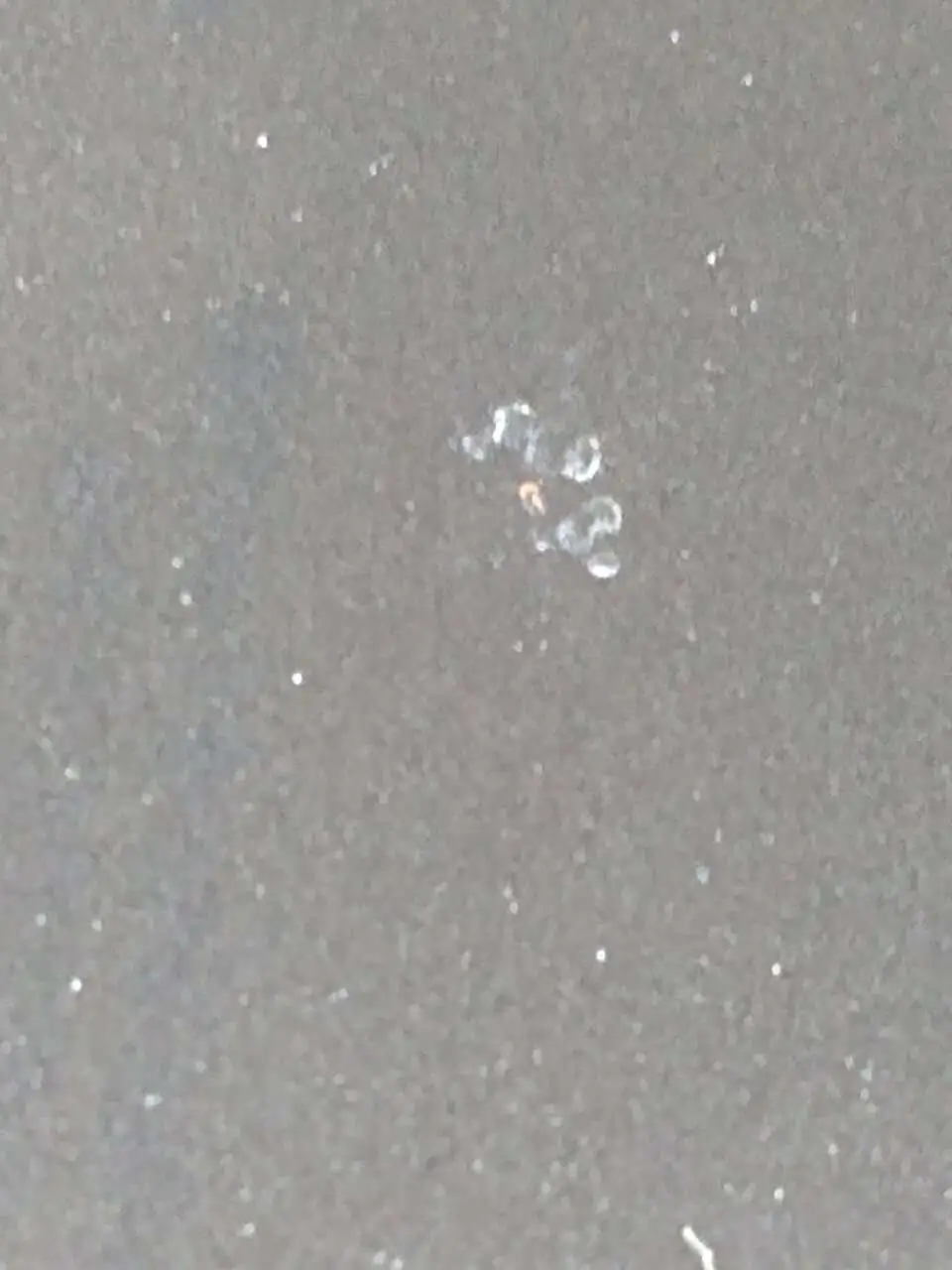

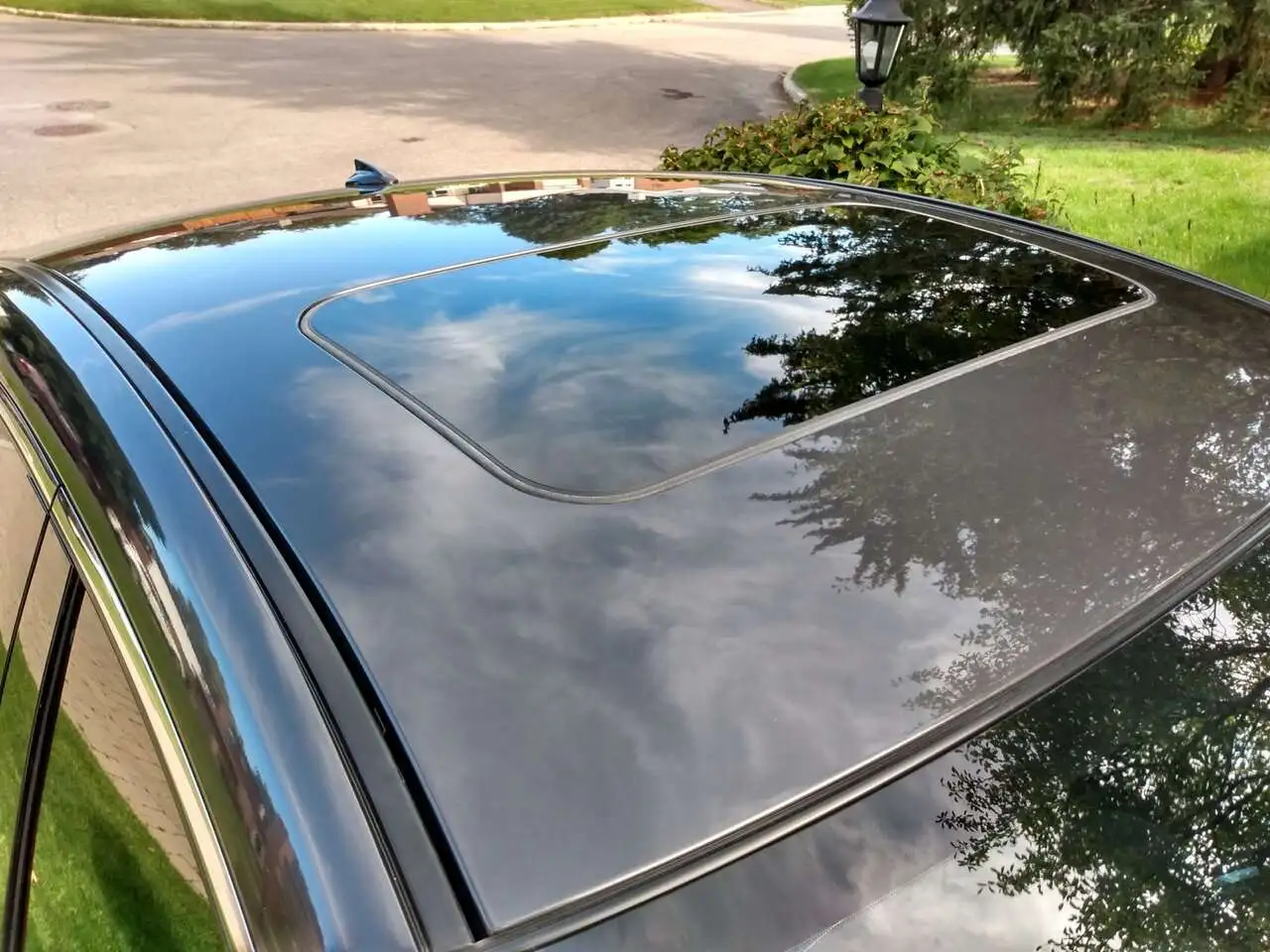

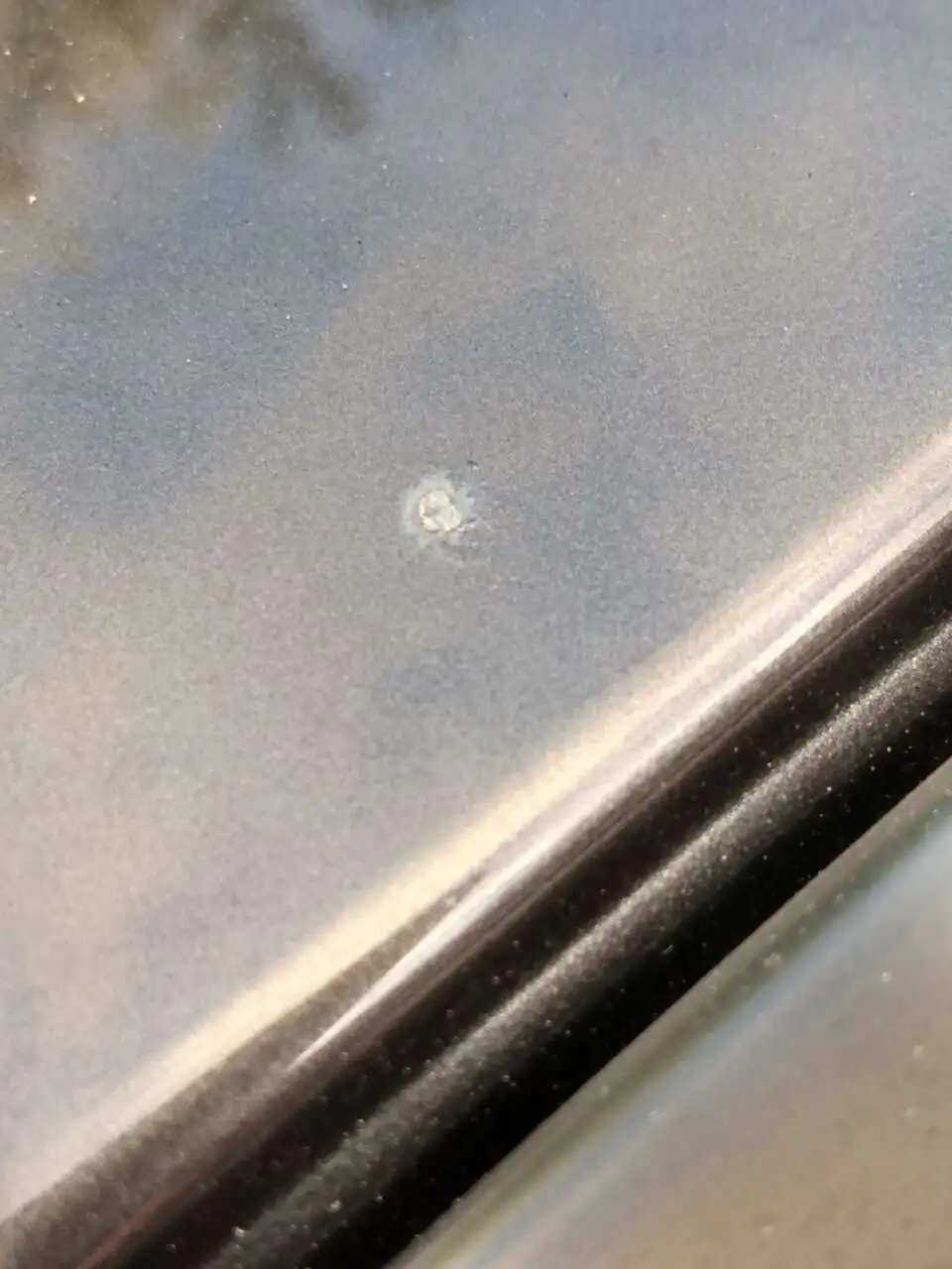

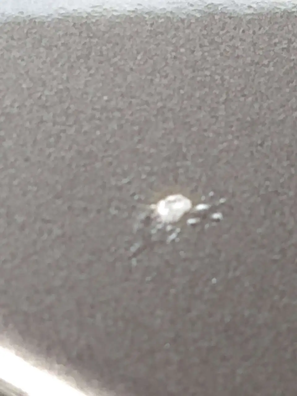

Here are a couple of pics from my roof, 2001.
