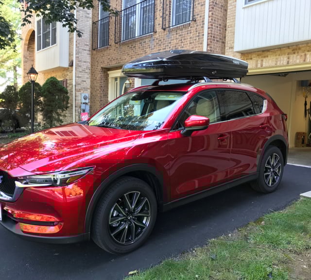

I have a Thule Force XL on my 2017 with the factory crossbars. Sorry I don't have a better picture than this. It is setup about 1.5" aft of the max forward position. It is stable up to 75 MPH loaded that way. I adjusted the rear hatch opening to be about 8" lower than max, and I have almost 1" of clearance between the hatch and the roof box when that is open.

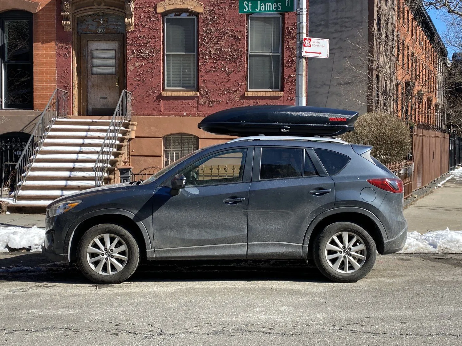

Here’s my CX-5 with a Yakima Skybox 16 on factory rails. I think this is the biggest box you get get without any fit or hatch clearance issues. It fits up to 180cm skis.

I have a Thule Force XL on my 2017 with the factory crossbars. It is setup about 1.5" aft of the max forward position. It is stable up to 75 MPH loaded that way.

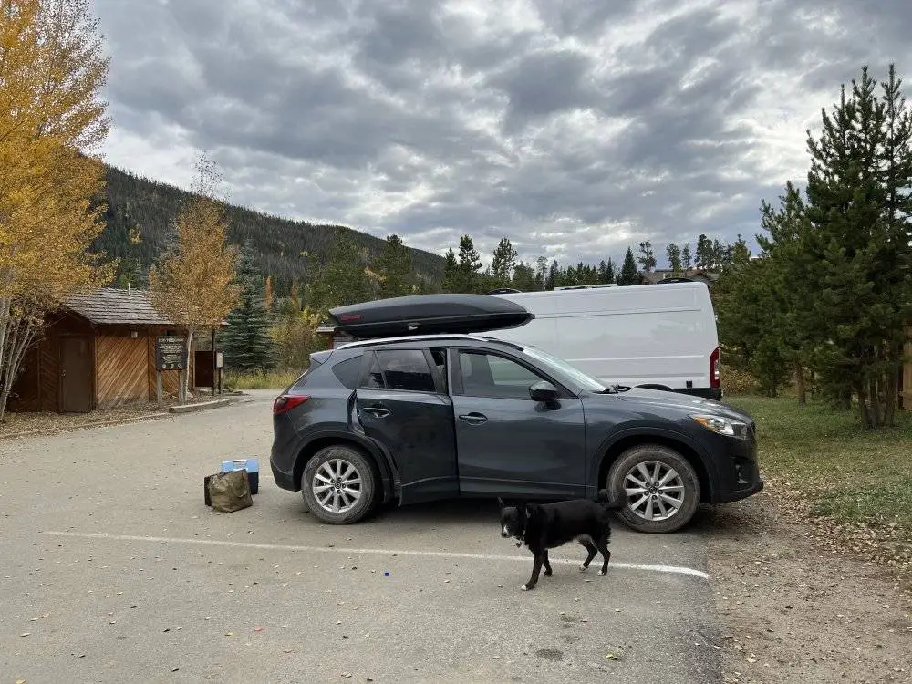

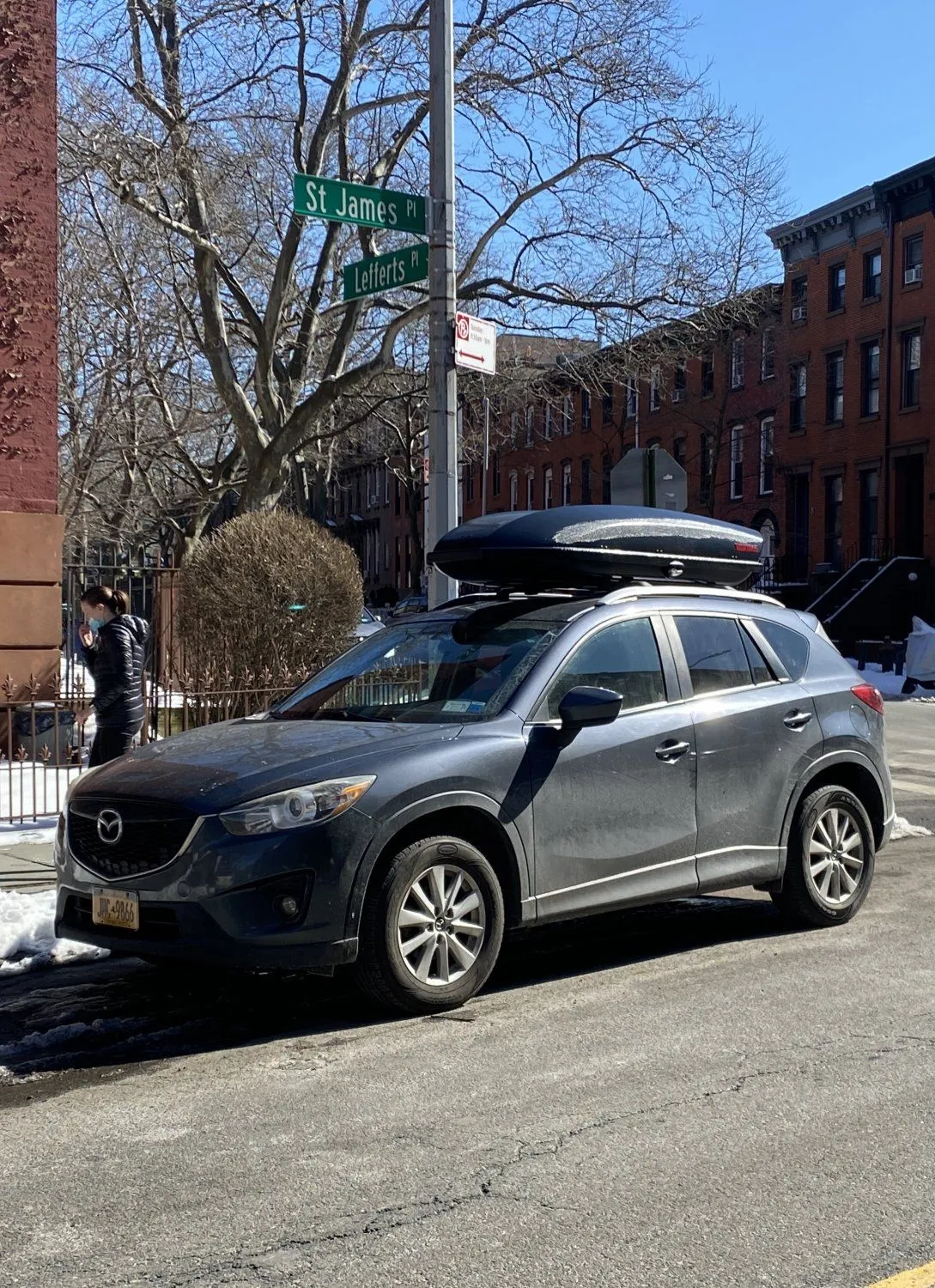

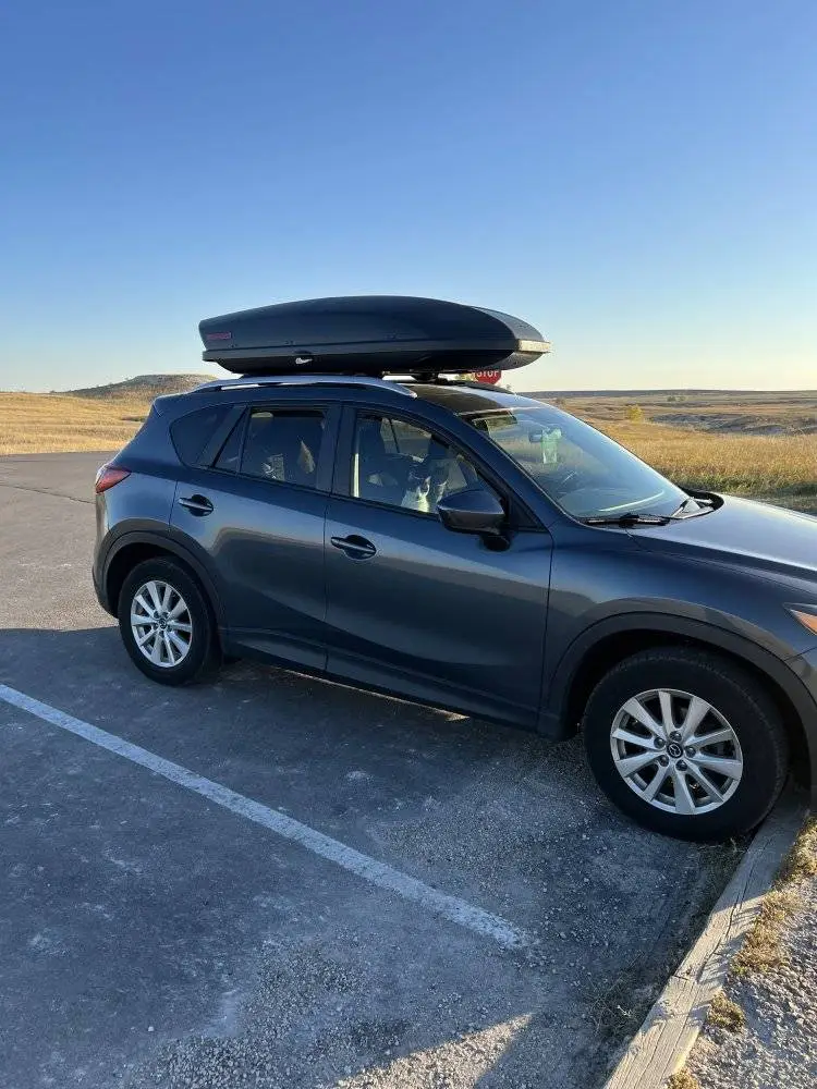

Skybox 16 can fit on CX5 factory crossbars but the hatch WILL NOT FULLY OPEN. I repeat it would not. Limited , a lot
I wish I knew.
Yakima Skybox 16 WILL fit on the first generation CX-5 with factory rails and bar. You just have to install it PROPERLY. I just took a 4000 mile cross country road trip with it. Had it for over 2 years. See photo :) Hope it helps whoever is thinking of getting this set up.

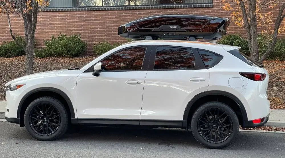

Here’s my 2019 with oem rails and crossbars. Box is the Thule motion XT L. We mounted both the large and xl and the large fit better. No adjustments to the rear lift gate and I have it mounted about 2” from the maximum open position for the rear lift gate. I hope this helps but feel free to ask anything.
Edit: one thing to mention is the motion has the angled back where the force is straight. I also liked the locking system more on the motion than the force.
