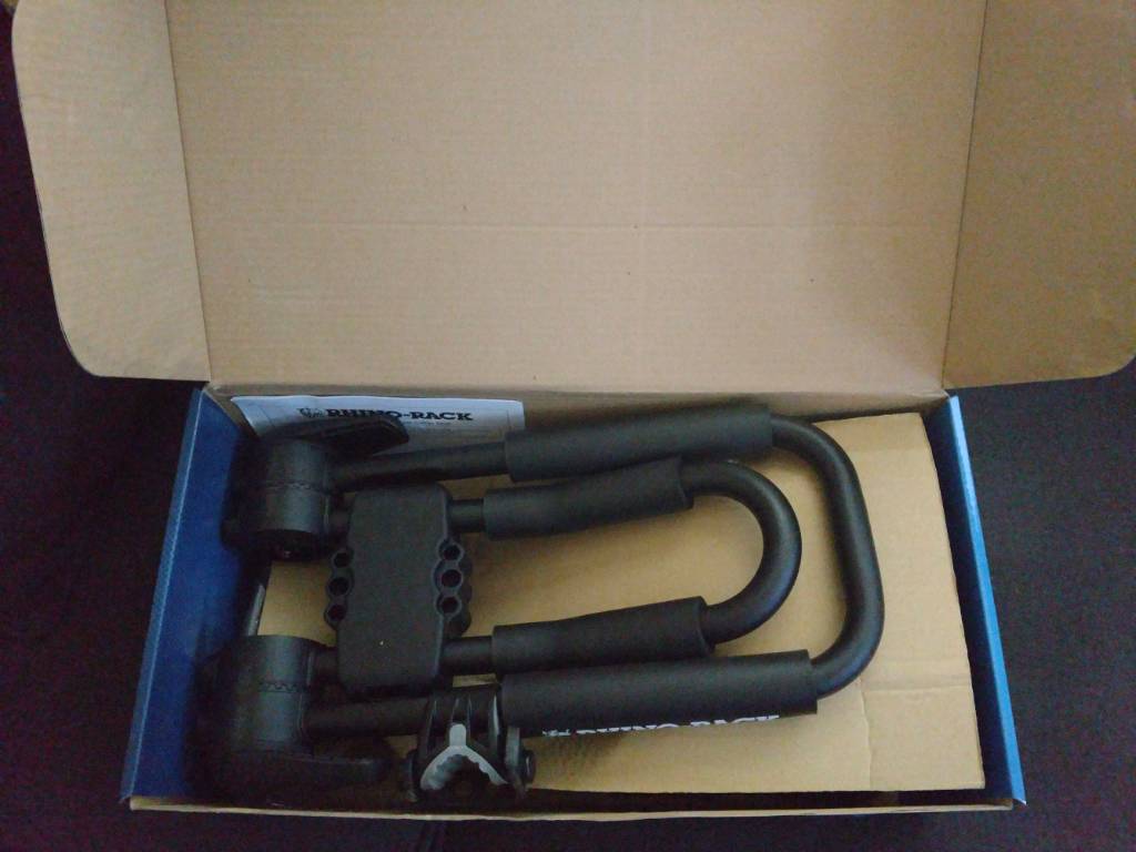

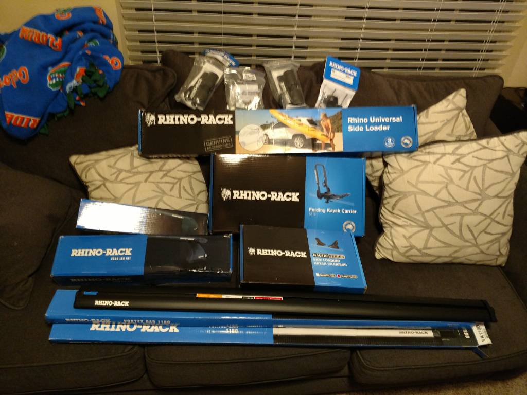

Here is the full breakdown for reference.
Rhino Rack Vortex 2500 Black 2 Bar FMP Roof Rack JA7748
Rhino Rack Nautic Kayak Carrier Side Loading 580
Rhino Rack Folding J Style Kayak Carrier S512
Rhino Rack Euro Fitting Kit KC-FK8
Rhino Rack Bonnett Anchor Strap RBAS
Rhino Rack Universal Side Loader RUSL
Rhino Rack VA Underside Tie Down Point Roof Rack S606
And the fun begins soon!
