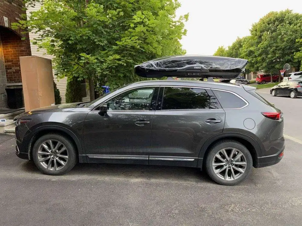

Funny thing though, as expensive as the mazda rails and bars are, they were still cheaper than the equivalent from thule and yakima when i was shopping around. So i went with the mazda rails and bars.
Also the mazda bars are curved, so not ideal if you are looking to carry large flat items.
