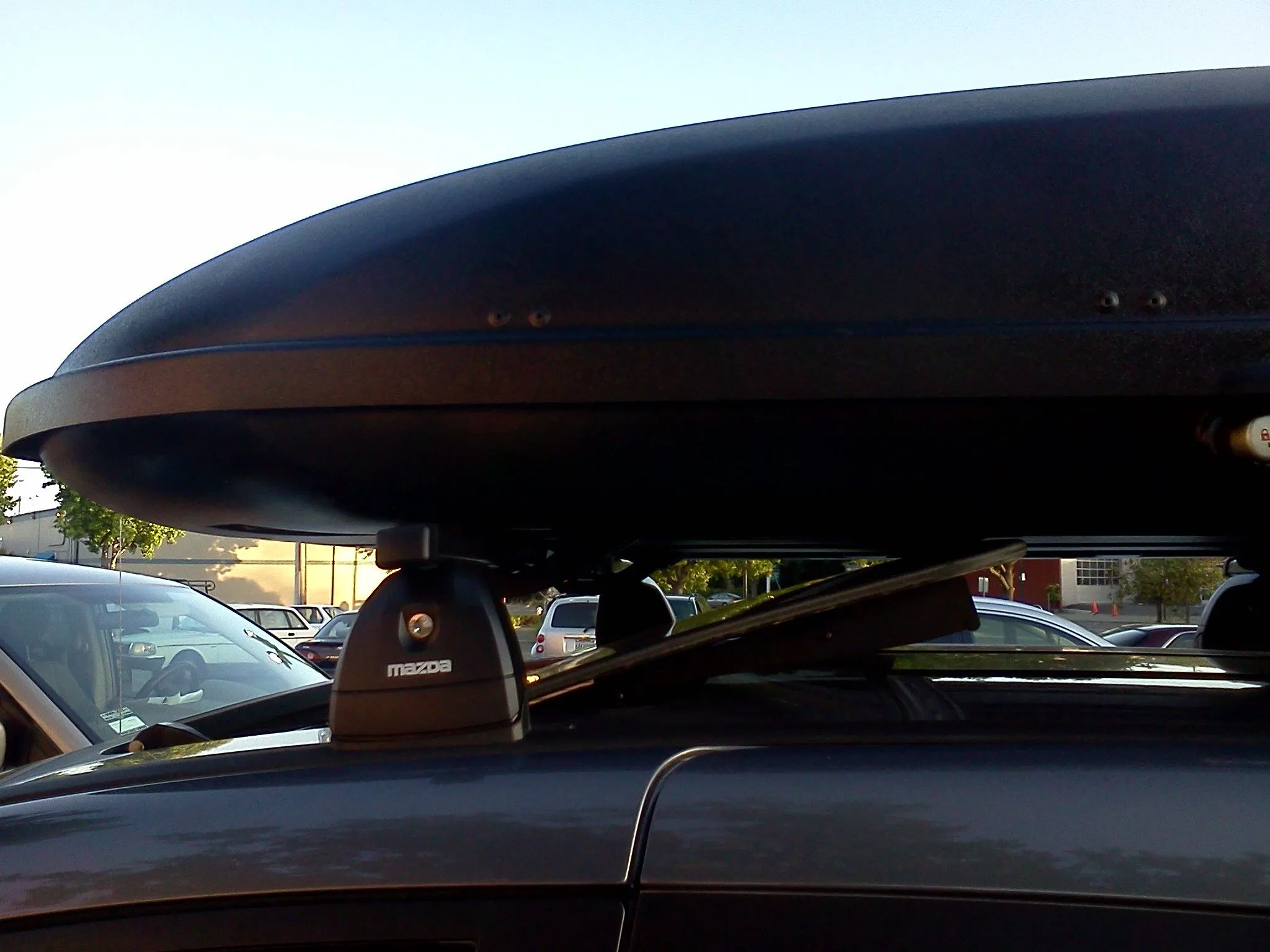

Opening moonroof with a cargo box installed on the new OEM rack
I installed the new OEM rack with a Yakima box (16S) on my 2007 touring. As you can see in the attached image, The moonroof touches the bottom of the box when it is completely opened. I don't suggest you to slide open it while moving. Tilting it has no problem.

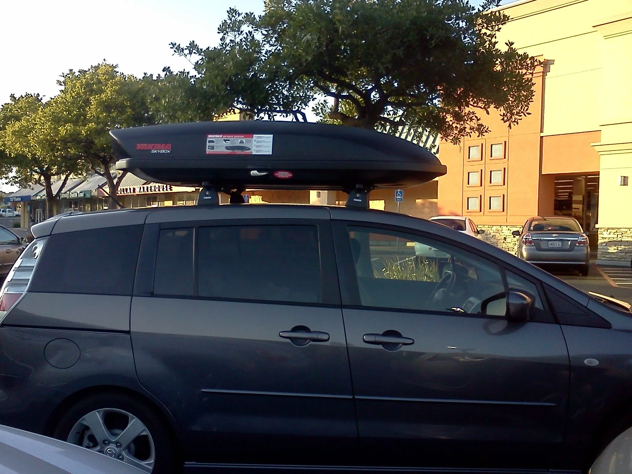

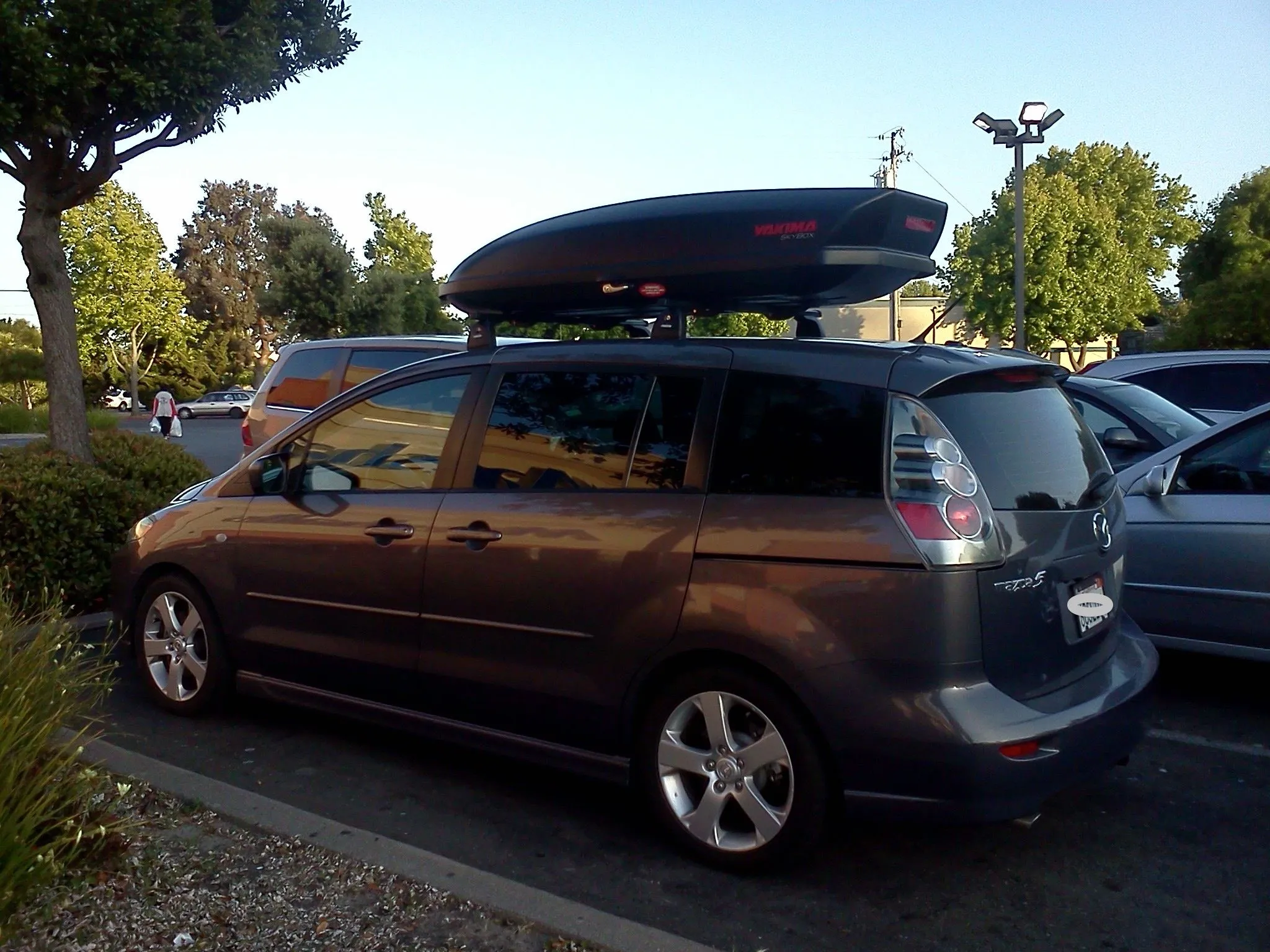

Yakima Skybox Fit
For those who may be considering a Yakima cargo box, go with the Skybox 18. I installed a Skybox 16S because Skybox 18 is too long for my wife's hatchback. As you can see in the attached image, Skybox 16s looks a bit short on the roof. I tried 18 at my local REI and it looked better.
