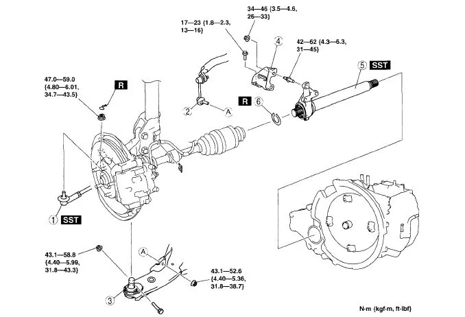

Do you have any write-ups or videos of the change? I know they are fairly easy to do but I just need to know which bolts exactly to take off so I am not taking bolts off I don't need or ones that will make my life a living hell putting back on. Any help?

If you did the tie rod ends (correctly, with correct parts), then the wobble is more likely ball joint or tire-related. The wobble could also be a wheel bearing, but you'd likely hear it howling all the time with the frequency changing as you speed up or slow down.
It's really hard to screw up tie rod ends and over tightening them is a bad idea. They should be torqued to around 40 ft-lbs as shown in the image below.
attachment.php
Good luck on your sale and move.
