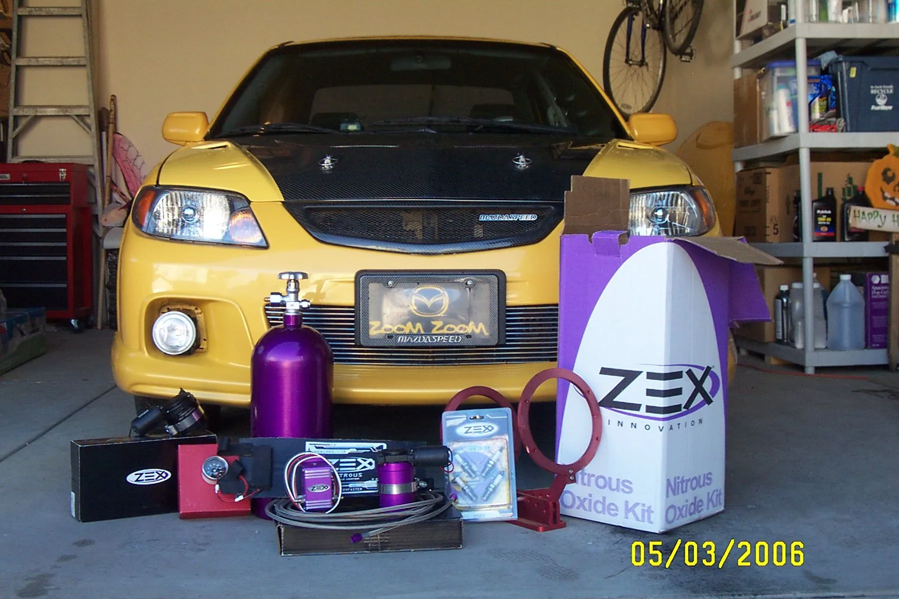

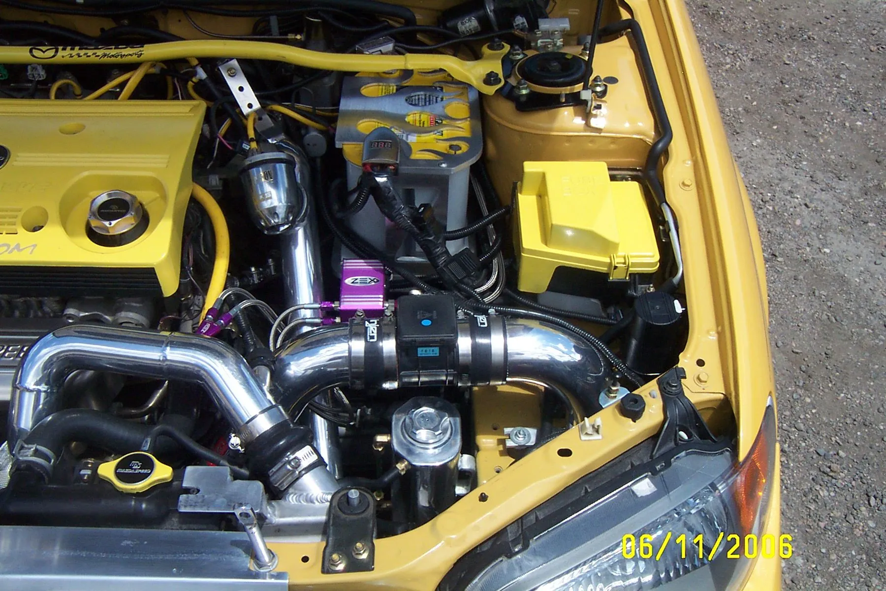

I'm with you. I got a Nitrous Express intercooler set-up and a Zex Wet Kit with single fogger 55 shot.

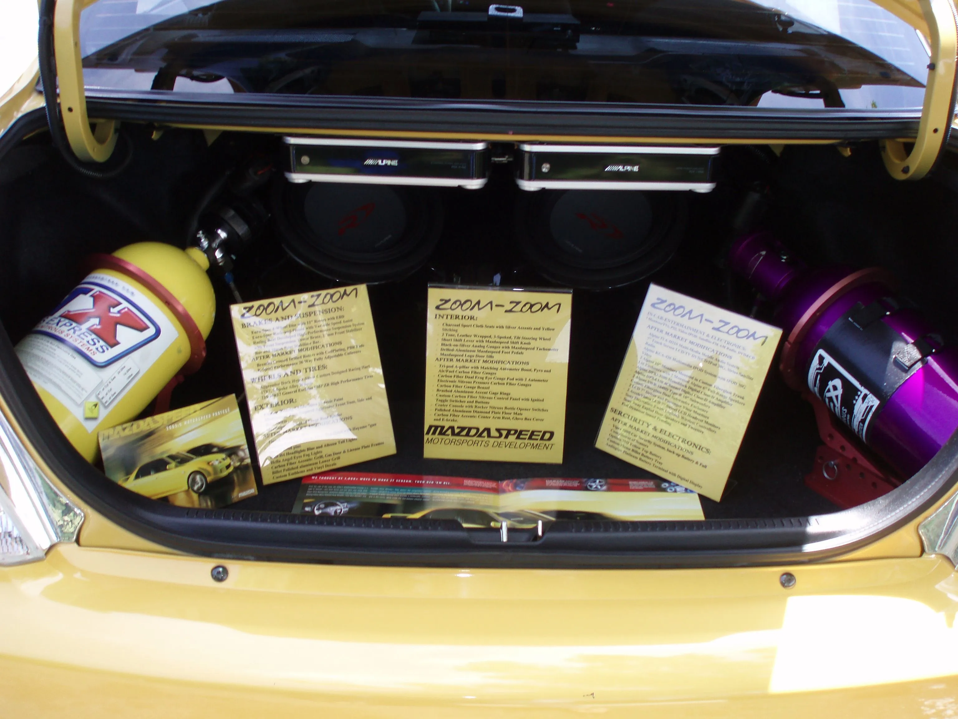

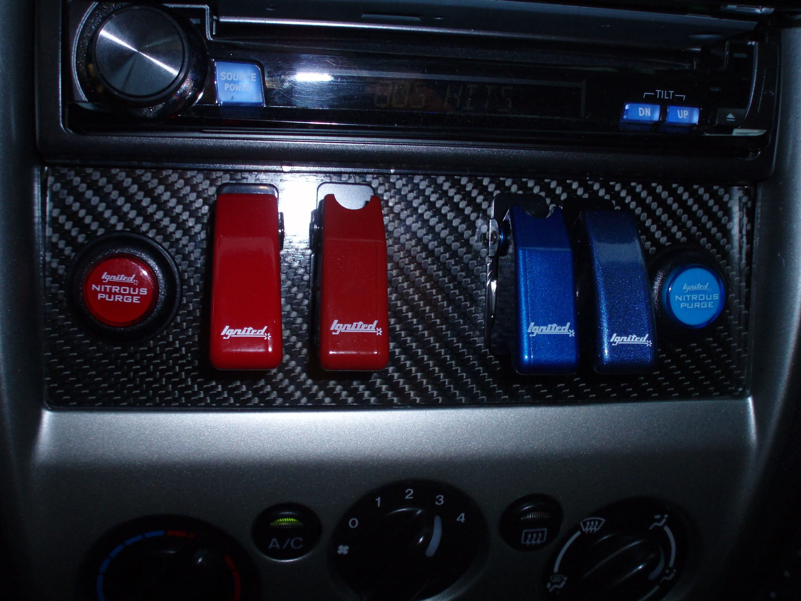

Mine is a long and agonizing story. ZOOM ZOOM BOOM!!!! A local performance shop that was doing the install blew my stock engine with a combination of over boosting and nitrous. After a fight with the shop and their insurance company we settled and they ended up paying $6,750.00. Took nearly a year to settle. Needless to say the Performance Shop went under soon after my settlement.
I used the settlement money to purchase a forged engine from SU. I got the new engine installed and decided not to re-install the nitrous until I got some miles on the new engine.
With a little over 500 miles on the new engine, I purchased Microtech LT10s engine management system. It goes in next week to complete the install of EMS and tune. I'll planning on putting on another 500 miles and then re-install the nitrous set-ups and tune again.
Stay tune.
