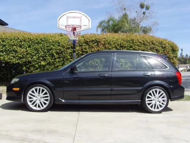

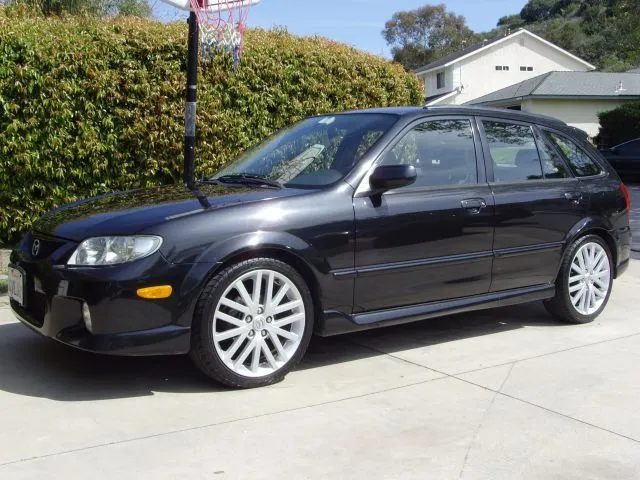

I was thinking of putting my stock Speed6 18" rims with 225/40 tires on my P5. So, looks like it not going to work... right? Thanks for the advice...
Check this out!
JoshP5, check this out... It Fits!!!

maybe, what tire is it? If it something that runs a little wide, it'll probably rub.
Really? That's surprising--but not impossible!
No rubbing against the rear fender? Have you done the speedbump test with a full load of occupants?
There's no rubbing and since it's not as offset, it's still has enough clearance to the inside of the fender. I haven't tried the speed bump test, though... Will try it this weekend.
