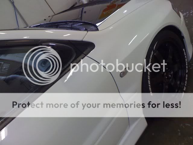

Not hard at all. Just make sure its CLEAN, that means any blackness on it take it away (even on the back of the wheel, I used paint striper on the back, and took most of it off, also had a degreser) Then Rub the whole thing with paint thinner, (well after you tape it off, make sure u tape off the valve stem, the tire, adn the center cap) and then get some Dupi-Color High temp paint, and start spraying like it says to on the can (2 light coats and a Medium coat, then how many other coats you need) then lay some Clear (they make high temp clear) over that and wait over night and BAM, its done.

did u doi these yourself? they look real good.
Yep! took a whole day to do all 4, It was kinda funny, while doing them a car crashed infrount of my house.... well it really want funny... it was just... "wow did that really just happen?"
But then I let them sit over the weekend to cure some. I have like 4 layers (atleast of gold) and atleast 4 layers of clear, all spray boomed. lol. Came out better then what I thought.
Me? I bought black paint and a brush at a art store, and i did it letter by letter with black paint.
