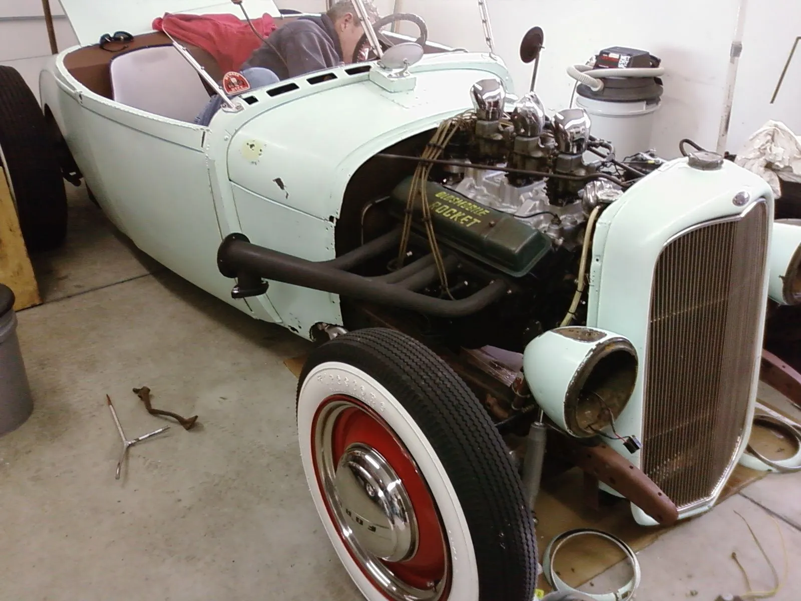

In case anybody was curious, here are 2 of my dad's weekend cars. We have slightly different tastes haha.
