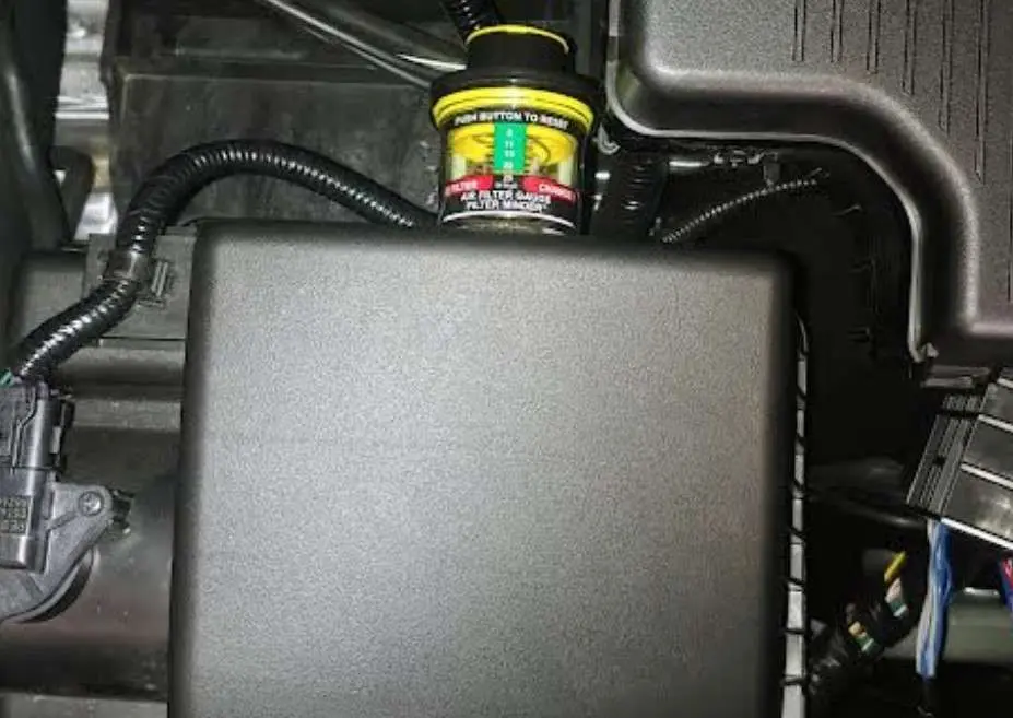

I added a "filter minder", air filter box differential vacuum gauge to our 24 CX 5 turbo. At WOT the turbo pulls -15" WC on the filter box, according to this vacuum gauge.
Under normal driving the gauge rarely moved.
I bought a spare lower part of the air filter box. This is where the dust laden air enters.
First I added a 2.5" inlet. The low end torque went away. It was a DOG at the low end and my FE suffered. At higher RPM the vacuum gauge didn't move.
Next, I made an inexpensive variable flow CAI device and attached to the 2.5" inlet stub. Low torque was restored. WOT the filter box did not move the vacuum gauge. The spring loaded damper does not start to open until the air filter box is under 0.04 to 0.08" WC. That is not much vacuum. I like that it only allows enough air in to maintain 0.04 to 0.08"wc vacuum. Or variable flow.

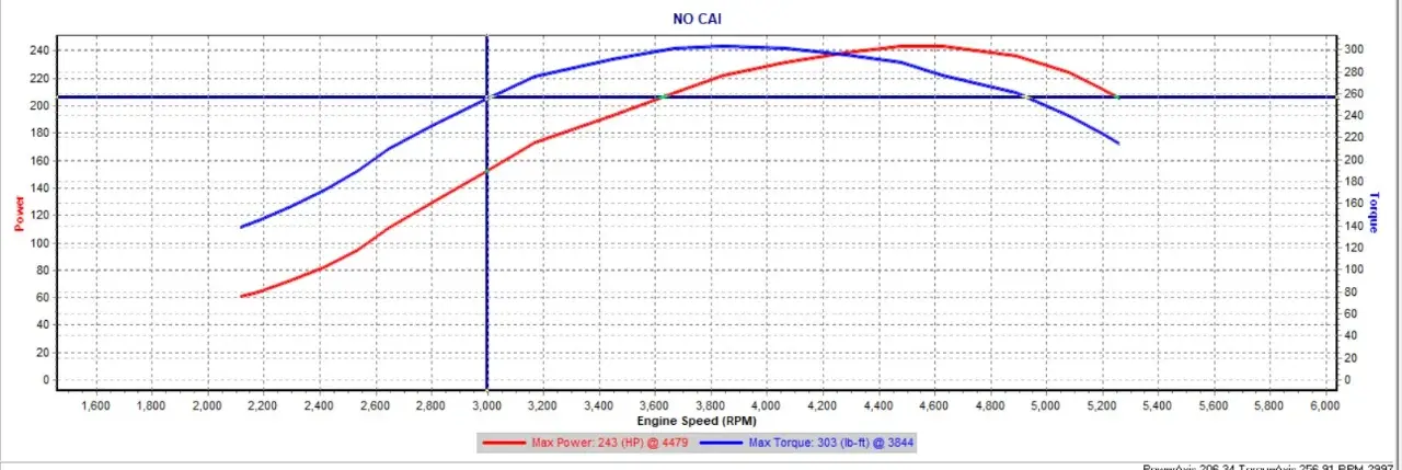

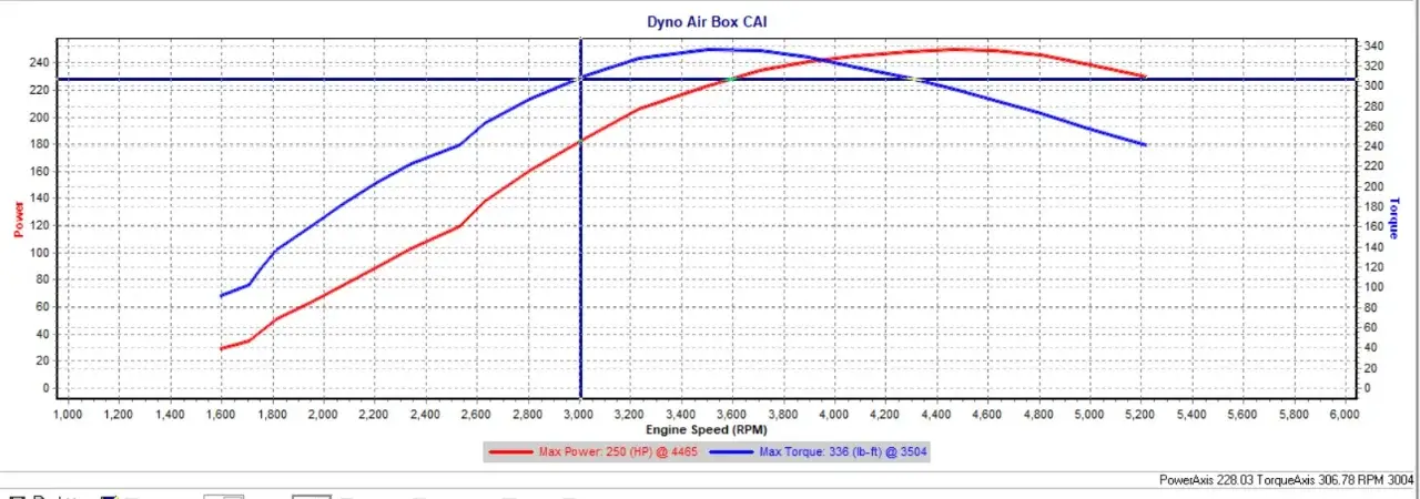

I ran some WOT tests and a couple 0 to 60 MPH tests with and without the variable flow CAI. Of course letting the engine breath made more power. It made about 10 HP at peak HP and moved the peak rpm higher. It gained the most power in lower, mid range, from 2500 to 3500 RPM. Right in the sweet spot. I have about $70 in parts I ordered from Amazon.
Sprinkled through out this thread is a progression of various tests and test results using Mazda Edit to generate HP and Torque curves. I used Torque Pro connected to the ECU to generate 0 to 60 tests.
Here is a teaser, much more info in the link below...

My tests showed the above mod never allowed the air box to go negative using a delta P gauge mounted on the clean air side of the filter. This means it provided all the air the engine asked for.
It's inexpensive and easy to fabricate. Cost $70.
It made the same peak HP and more mid range HP as any of the avaible CAIs AND maintained low end torque.
