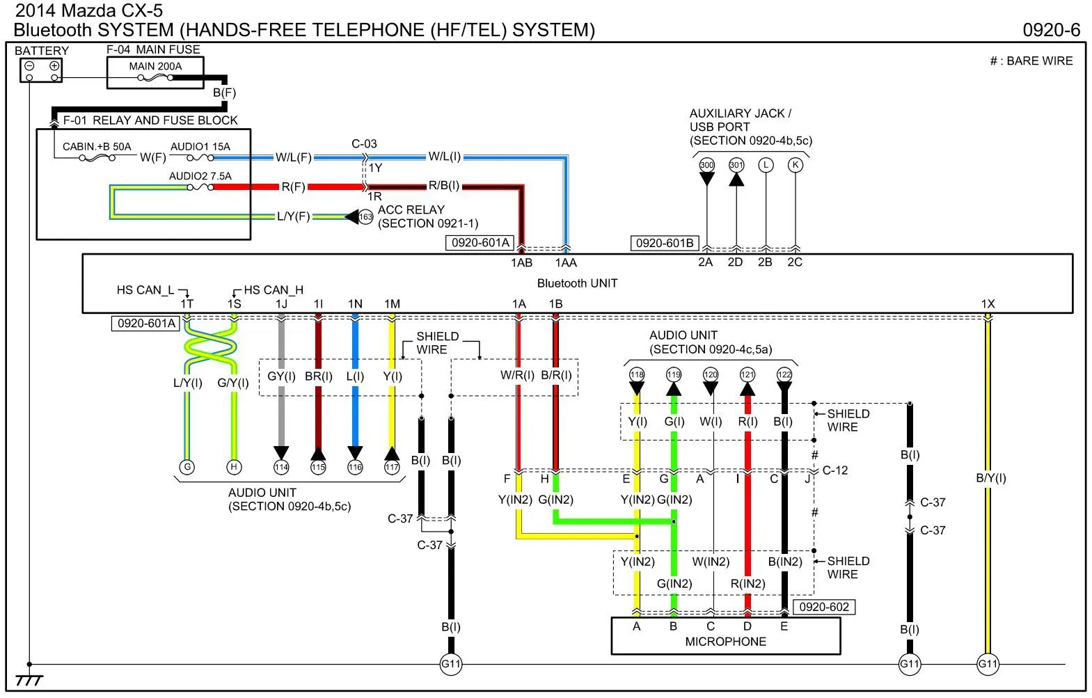

Further to this topic, I'm beginning to think that the radio is not the issue, but rather the Bluetooth module. Based on both looking at the schematics, and opening up the USB/Aux jack box to trace connections (see: Opening Aux/USB box) it looks like the Bluetooth module is actually what handles the USB reading. The Aux jack is wired direct to the radio, however the USB pins are wired to the BT module (conn pins 2A-2C, at top right of schematic) . From there to the radio they would seem to share the same audio signal as the other BT ones do (conn pins 1J-1M at bottom left of schematic).
Based on this, I'm guessing that a software update to the radio, is not the fix. Rather the BT module will require removing and either reprogramming or replacement. THIS might be why this is all taking so much time.
Also, as I said on the other post, this explains why some folks have had the Bluetooth module replaced to cure the notorious USB drive corruption issues.

That would also corroborate other posts I've seen where Mazda from some contries was stating that a hardware, and more precisely BT module, update was in the works...

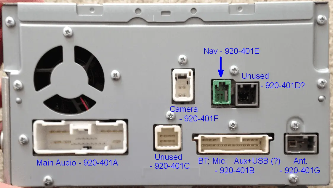

Yet more corroboration.. in ErgoZooms response to this topic on another thread (here: http://www.mazdas247.com/forum/show...k-been-fixed&p=6276595&viewfull=1#post6276595), he says that in the 2013 (working USB) radios, the USB connection went straight to the back of the Radio, NOT to the BT unit. So I checked the 2013 schematics, and sure enough, he's perfectly correct. In that year the BT was not in the way of the USB!
But more, the USB port still exists on the 2014 radio (top right grey connector - marked: "Unused - 920-401D" on the attached pic.) I wonder if anyone has tried (or could try) connecting to that port directly and seeing if the USB would still work there? I would do it myself, but I've already decided on replacing the radio and have ordered all the pieces.

I would try it, but where would I get a harness that plugs into that? Doesn't look like a standard USB jack of any sort.
No, you'd have to get pin sockets that fit, from some other connector and connect individually. :(
I am trying to fit the Commander into my CX5 and I have Headunits from the Mazda 6 2014 and CX5 2013 Models. I can confirm that the USB in the CX5 2013 runs directly to the Headunit, while in the 6 the USB runs through the BT Module. The Software on each Headunit is locked so you can not plug USB directly into the Headunit of the 2014 Models. This is the only thing stopping me from putting the Headunit from the 6 into my CX5 so i can get the commander to function.
Ahh, OK, thanks Chris. I guess that answers that question then.
