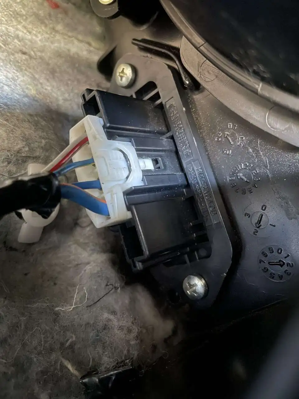

Mine is a 2007 Mazda 5 with manual a/c fan control. The blower resistor is not in the same location as this video. In fact I cant find it at all!
Anyone know where its located?

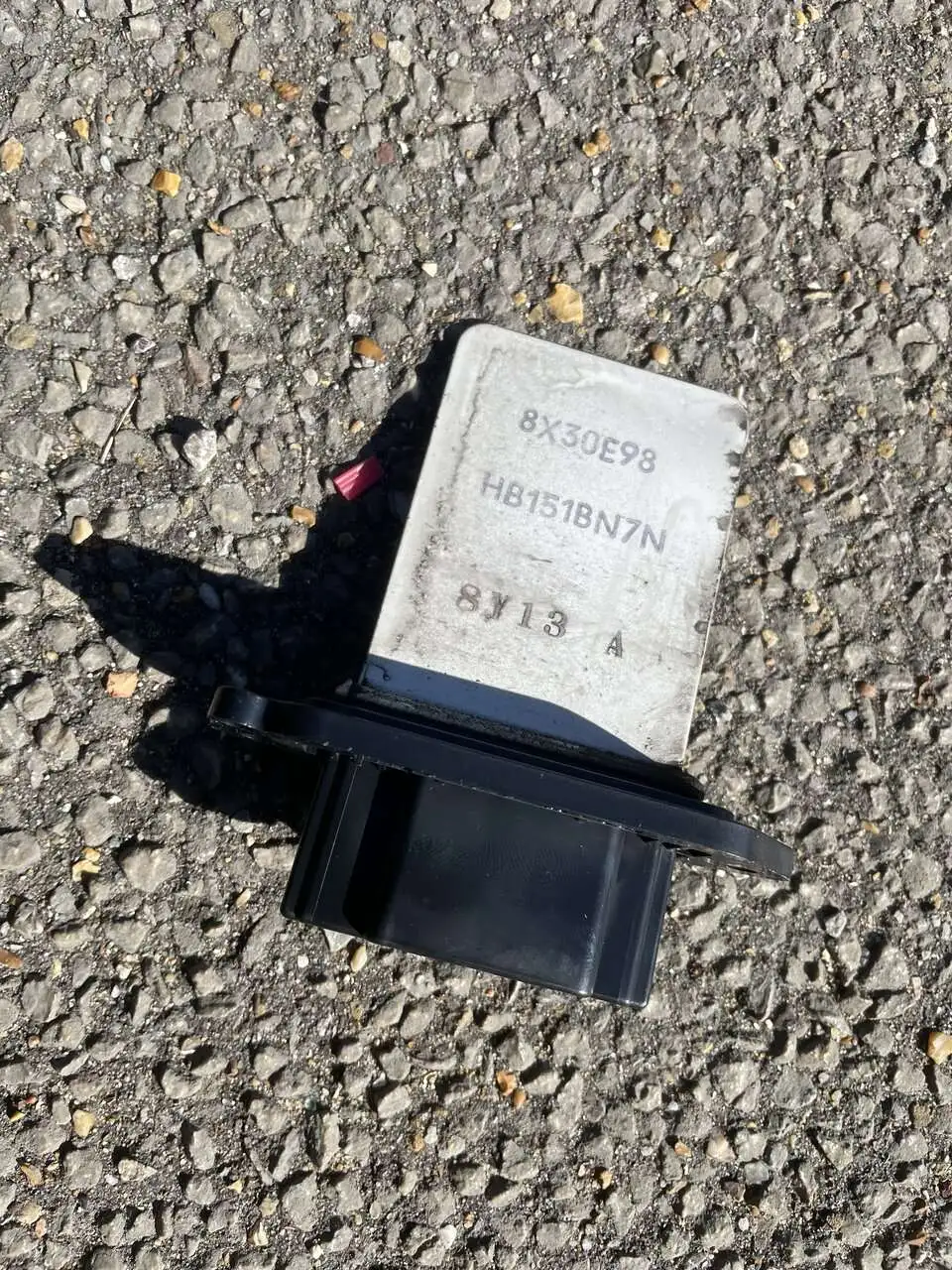

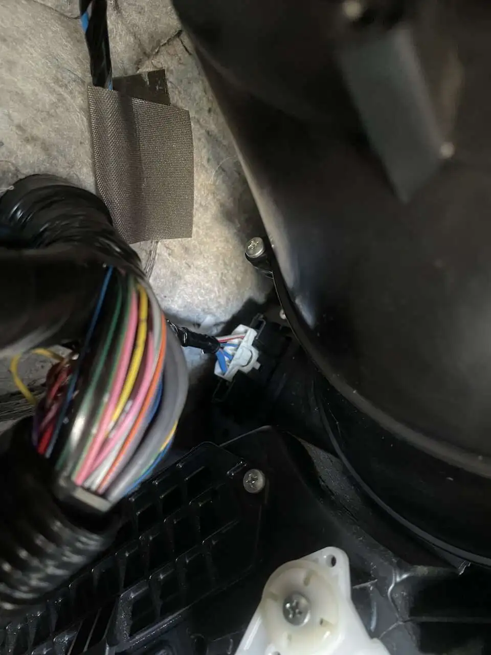

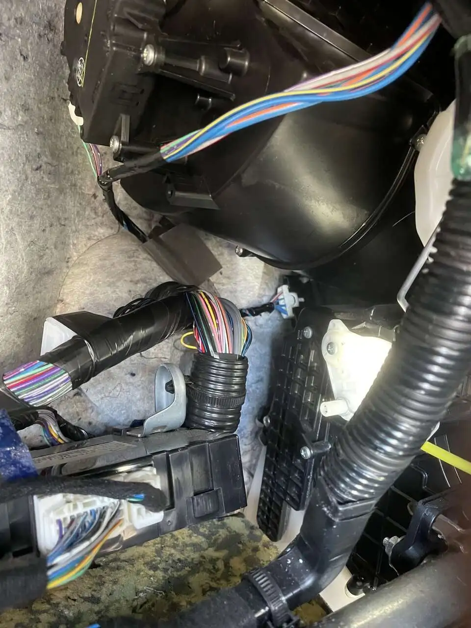

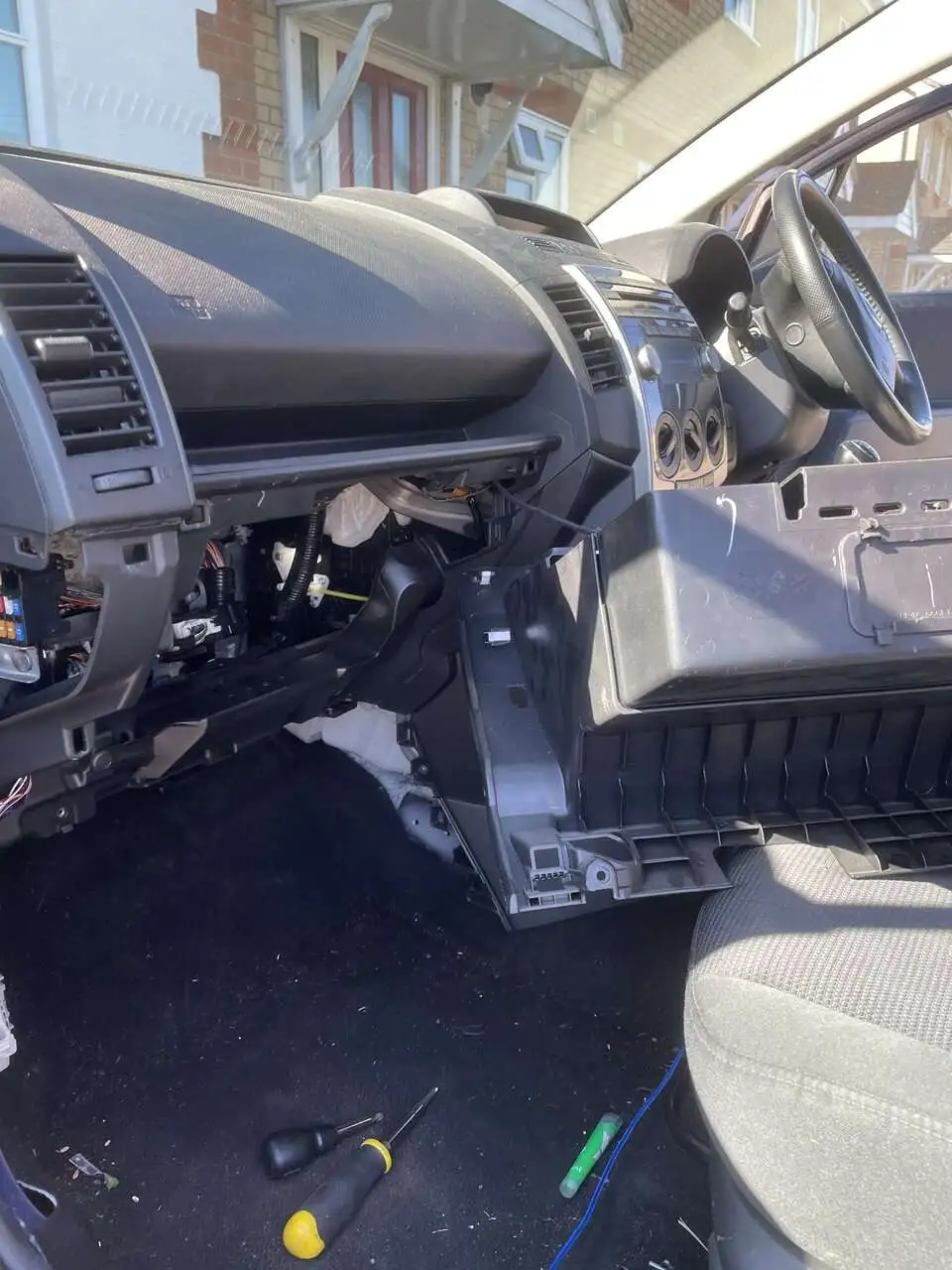

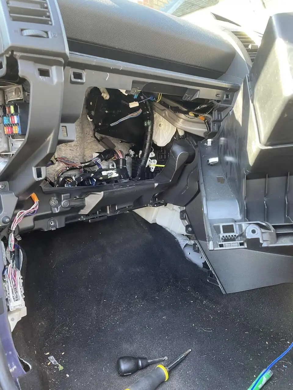

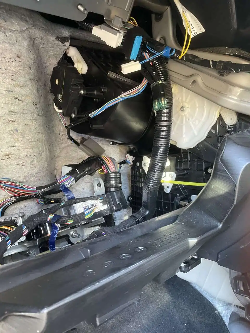

U.K. viewers!! Blower motor resistor is here. Remove glove box and it’s just behind the center. Make sure you have a magnetic ph screwdriver and bendy wrists. I got the part for £20 took about an hour but I couldn’t find any videos or diagrams that helped. Only US stuff.
