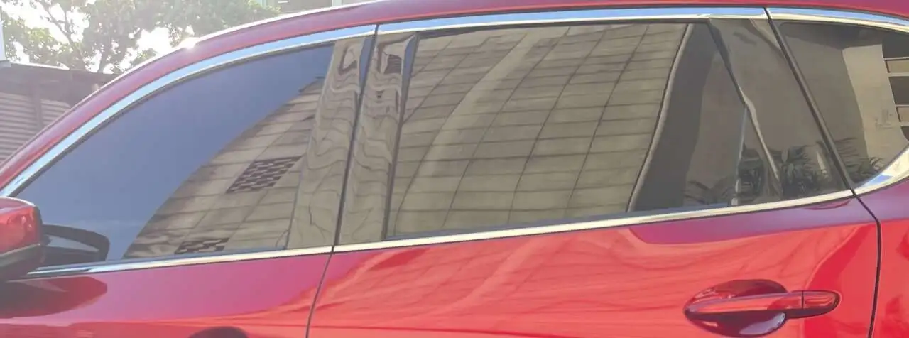

Hi there, did you replace the door applique? I’m having the same doubt. I already had a black pillar post which a 3M adhesive, but now I found the OEM parts and don’t know how to replaced them…
I ending up ordering the two rubber strips (Part# tk4850m15 and tk4850m25) as they were sold separately than the appliques. I was able to just pull on the old rubber strip which is held in with 3m tape and then replace it with the new rubber strips.
