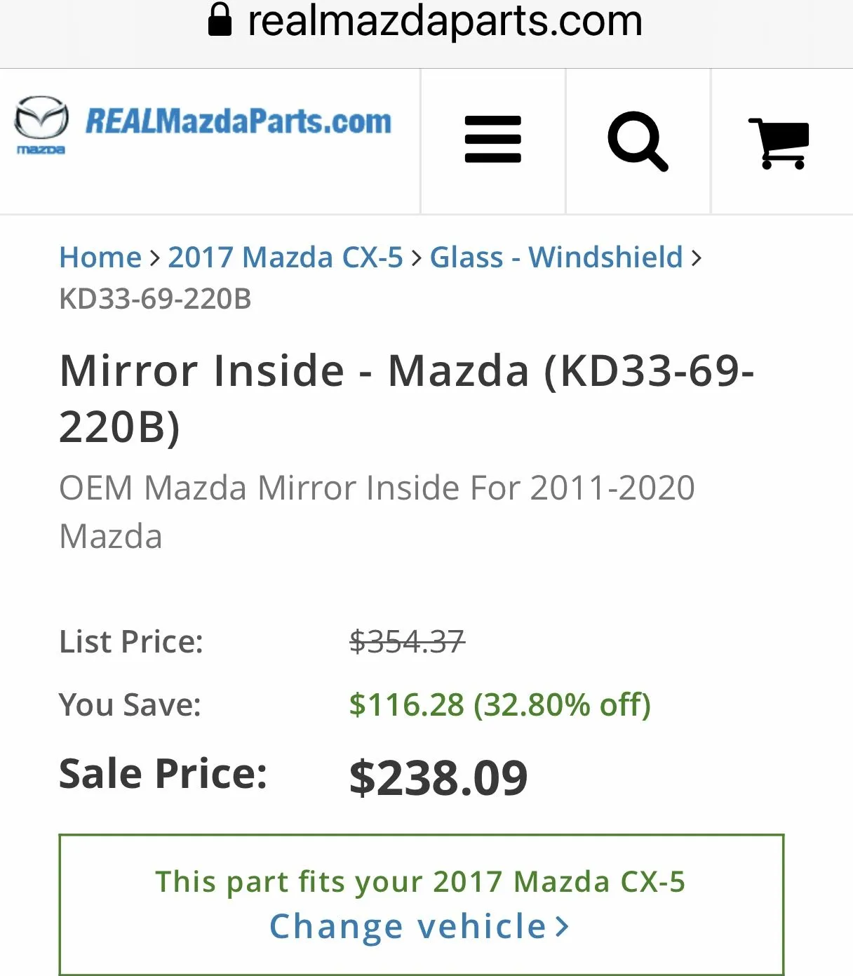

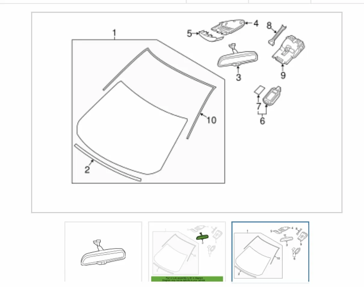

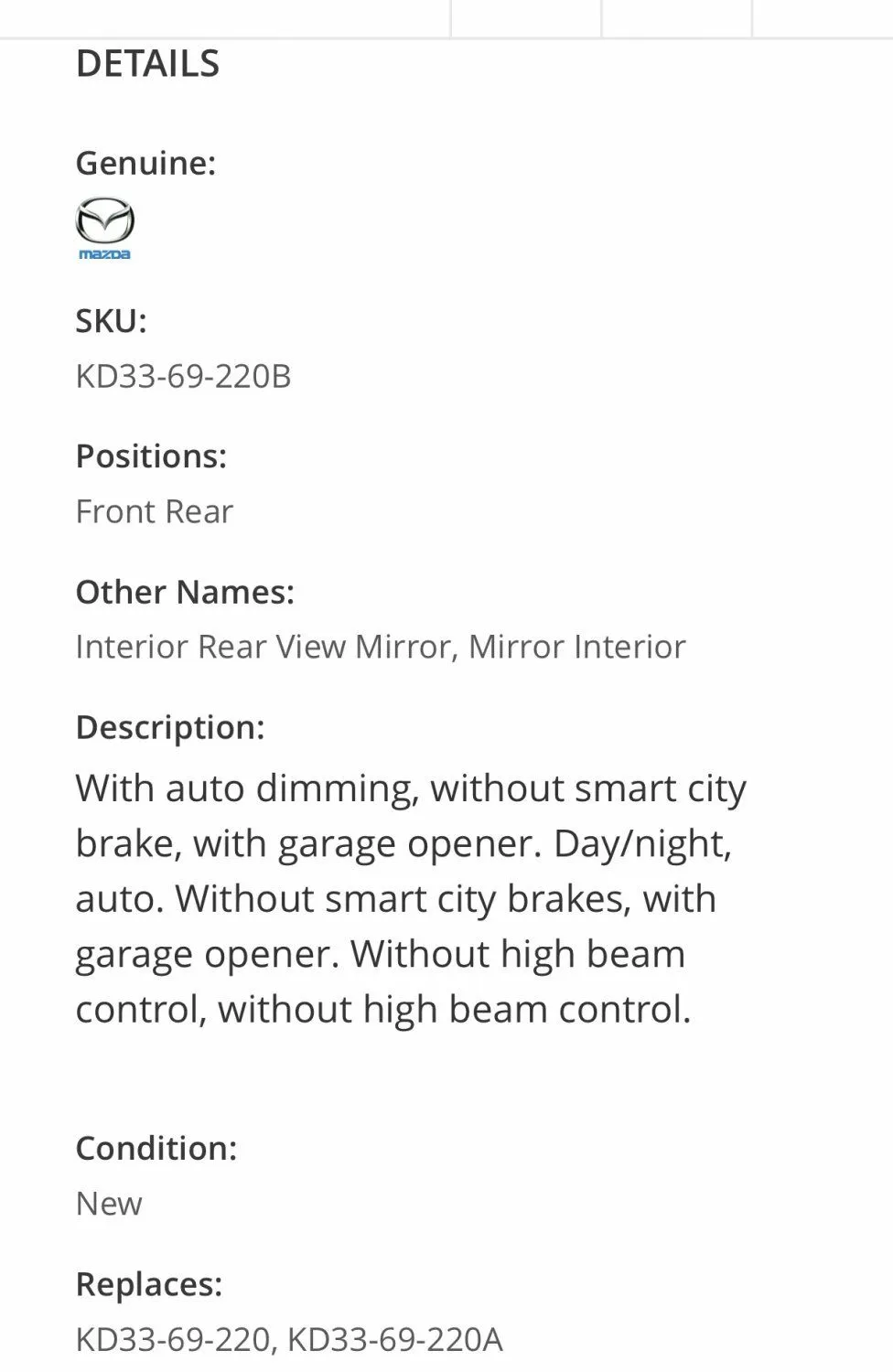

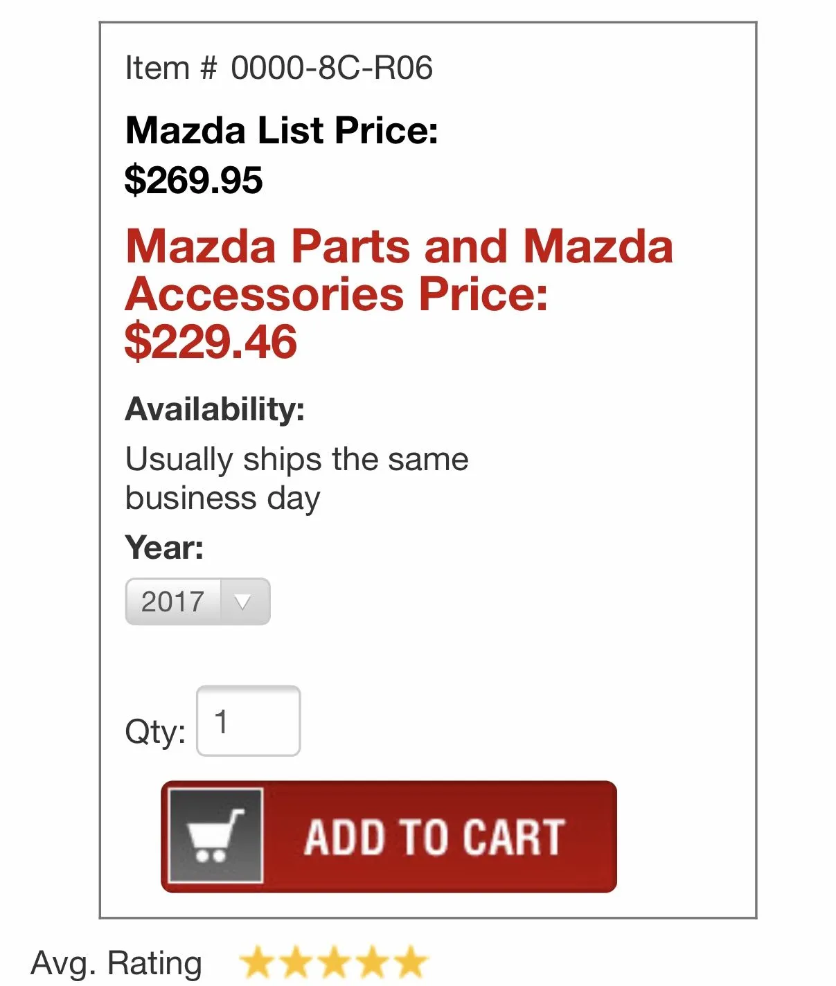

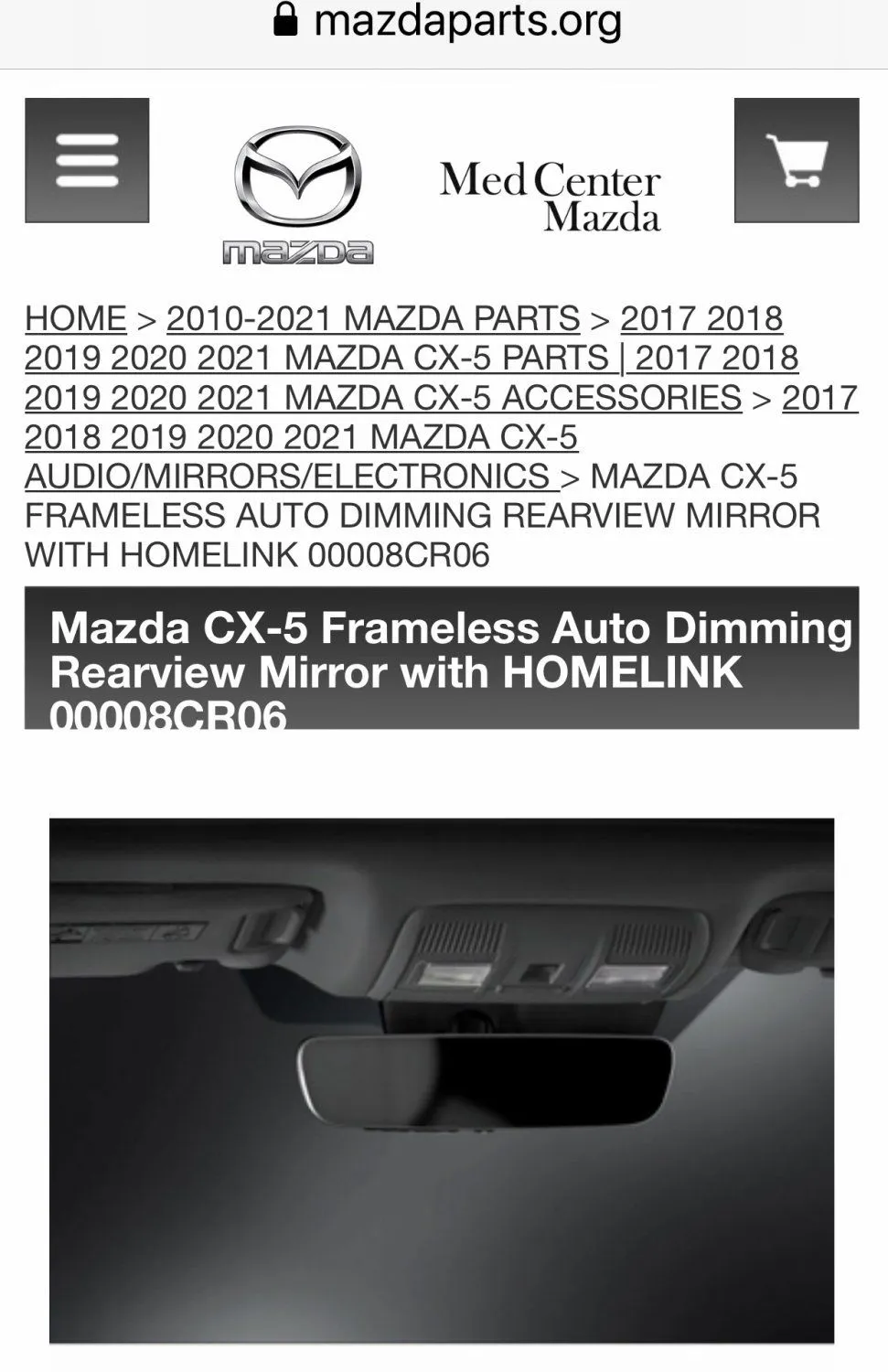

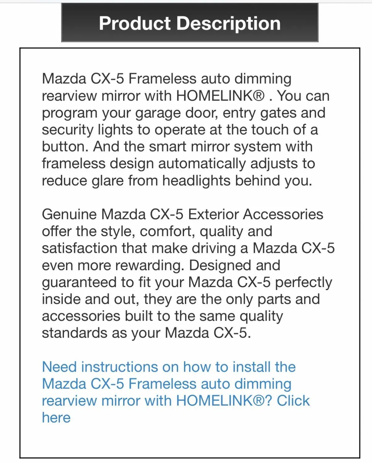

I believe the rearview mirror is a bit curved and it’d be hard to stick a flat mirror on the existing cracked mirror. Besides, your 2017 CX-5 GT has auto dimming with HOMELINK®. It has special treatment on the back of the mirror and that’s why it’s expensive.
You have 2 choices on OEM part and accessary. You can DIY which should save you almost $400, and it’s an easy plug-and-play job. The other alternative is to find a used one in salvage yard.
OEM part:
Or OEM accessary:

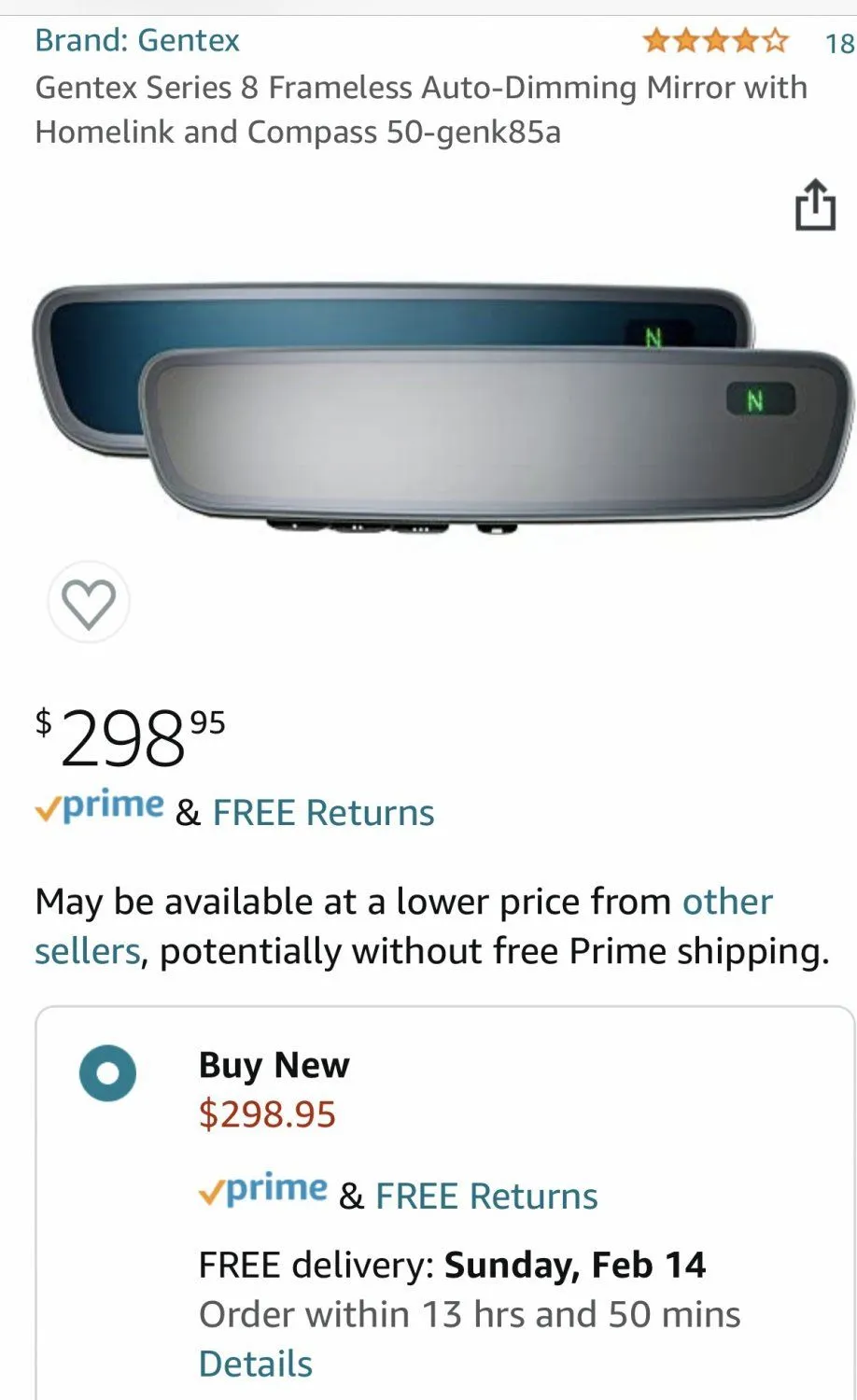

Searched Gentex on Amazon and:
This’s generic Gentex auto dimming rearview mirror with HOMELINK®. For the price I’d get OEM part or accessary.
