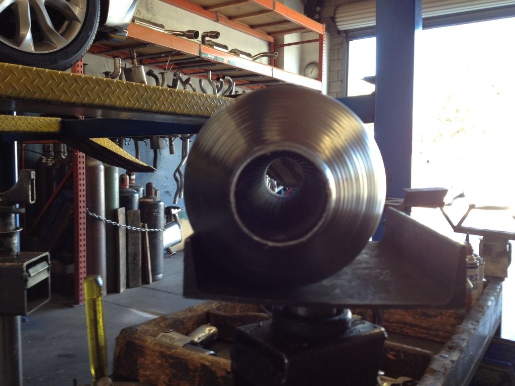

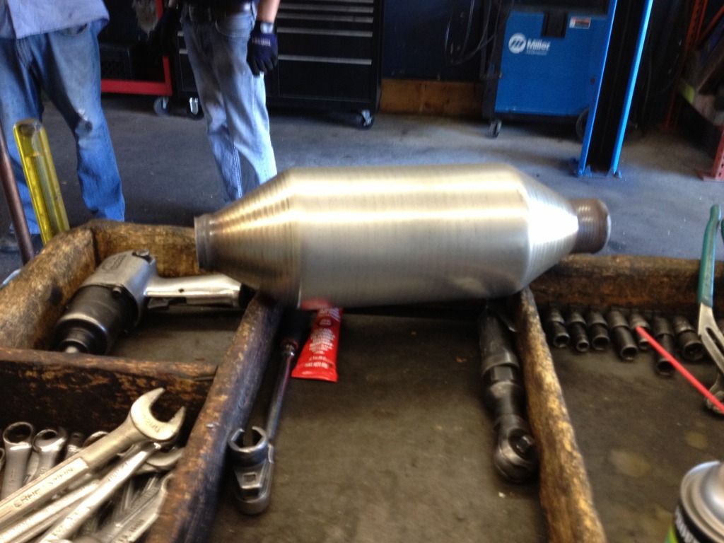

Stock resonator chopped off

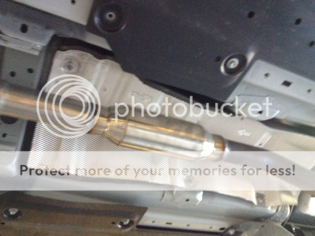

Smaller resonator welded on, the resonator has same size openings on both ends and the shop expanded each end and slip it over the stock pipes so it won't create any turbulence.
