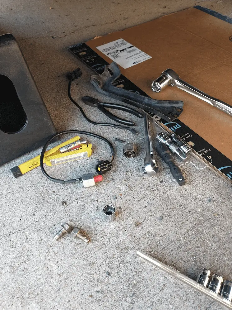

I finally installed a new knock sensor today. I was previously discouraged due to the amount of stuff in the way from both the top and bottom of the engine bay. Someone here helpfully recommended removing the intake manifold brace (only four bolts), and that helped a lot. I also unplugged the oil pressure sensor (or whatever that single-wire connector is) to keep from accidentally ripping it apart. I just got my oil changed so I didn't remove the oil filter, but that would have helped as well.
As recommended by someone on the forum, I cut off the cable as close as possible to the old knock sensor so that I could slip a socket over the top of it. With the intake manifold brace removed, there was enough room to slip on that 15/16" socket and to pop on a 1/2" ratchet. I may have been able to remove the original knock sensor without sacrificing it, but as I said it's really cramped in there.
I then spun the new sensor on by hand (donated by a very nice former P5'er who had it in inventory) and moderately tightened it up with a crescent wrench. I had to wrench it at an angle, so I had to be careful there. It's an aftermarket part (not a Mitsubishi), but it looked good.
Backing up in time a bit: Before sacrificing the original part, I unplugged the knock sensor and drove it for a day to see if the engine would knock (and it never did). I had wanted to make sure that if I destroyed the original part and couldn't get the new part installed that the car would still run properly. Note 1: With the sensor unplugged, I didn't get a CEL right away, but finally did after minutes/hours had passed. Torque returned the expected P0325 code when I scanned for it. Note 2: I use premium (93 octane) gas because I have A) an MP3 ECU and B) a JDM engine, and the premium gas may have protected me from any knocks while the sensor was unplugged.
With the new sensor installed, the plan is to get cheap gas for the next half tank to see if the engine knocks and report back. The engine certainly knocked previously using cheap gas with the JDM engine and original P5 ECU, but that was with a knock sensor that was completely devoid of its "goo" as you can see in the pics. (The old sensor had drained out almost completely onto the rear of the engine.) Looked like that rooftop bathroom after I got Delhi Belly back in 2015. But I digress... :D
Pic of old and new sensor. Old sensor has its cable cut and almost no goo left in it.
Here's another pic mainly to show the removed intake manifold brace and the cut cable for the old sensor.

So it does seem like replacing my melted knock sensor helped with my engine knock. (After replacing the sensor, my pronounced audible pinging with 87 octane improved to "only" mild audible pinging with 87-88 octane.) If a lot of the goo has melted out of the back of your sensor, you might consider replacing it. Seriously consider replacing any melted knock sensor if you actually hear pinging. You can use premium fuel for troubleshooting.
