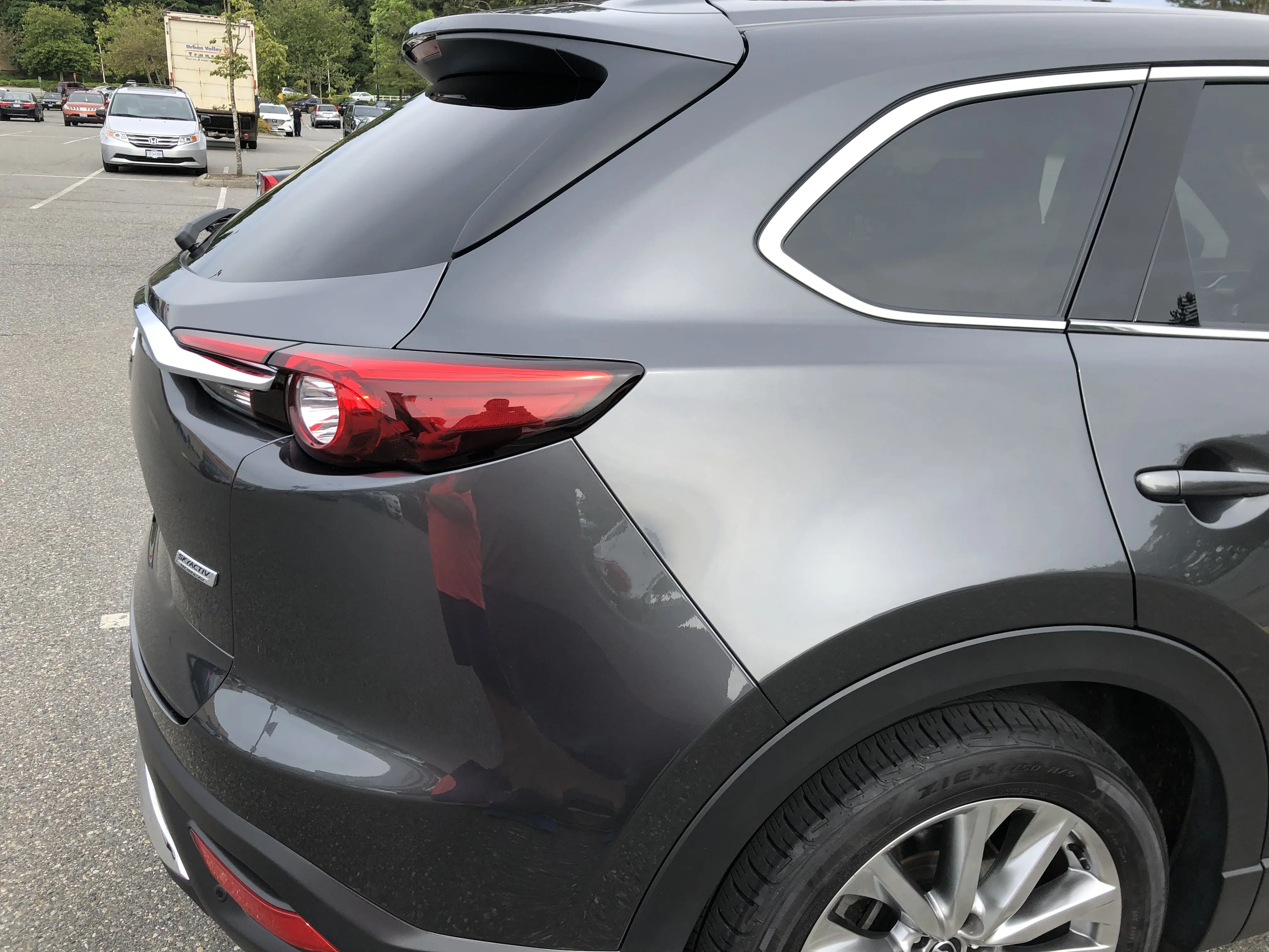

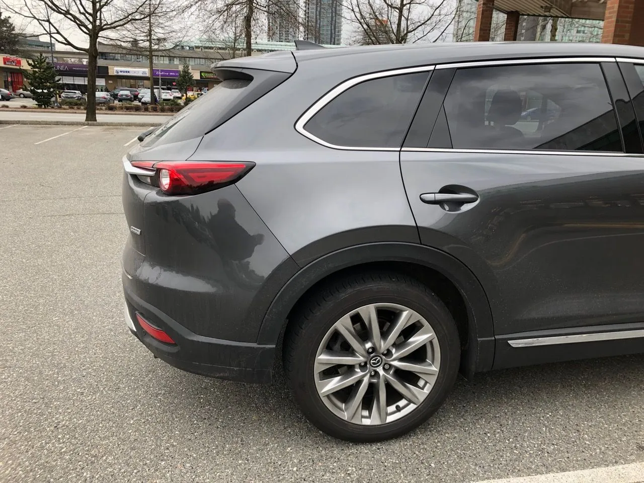

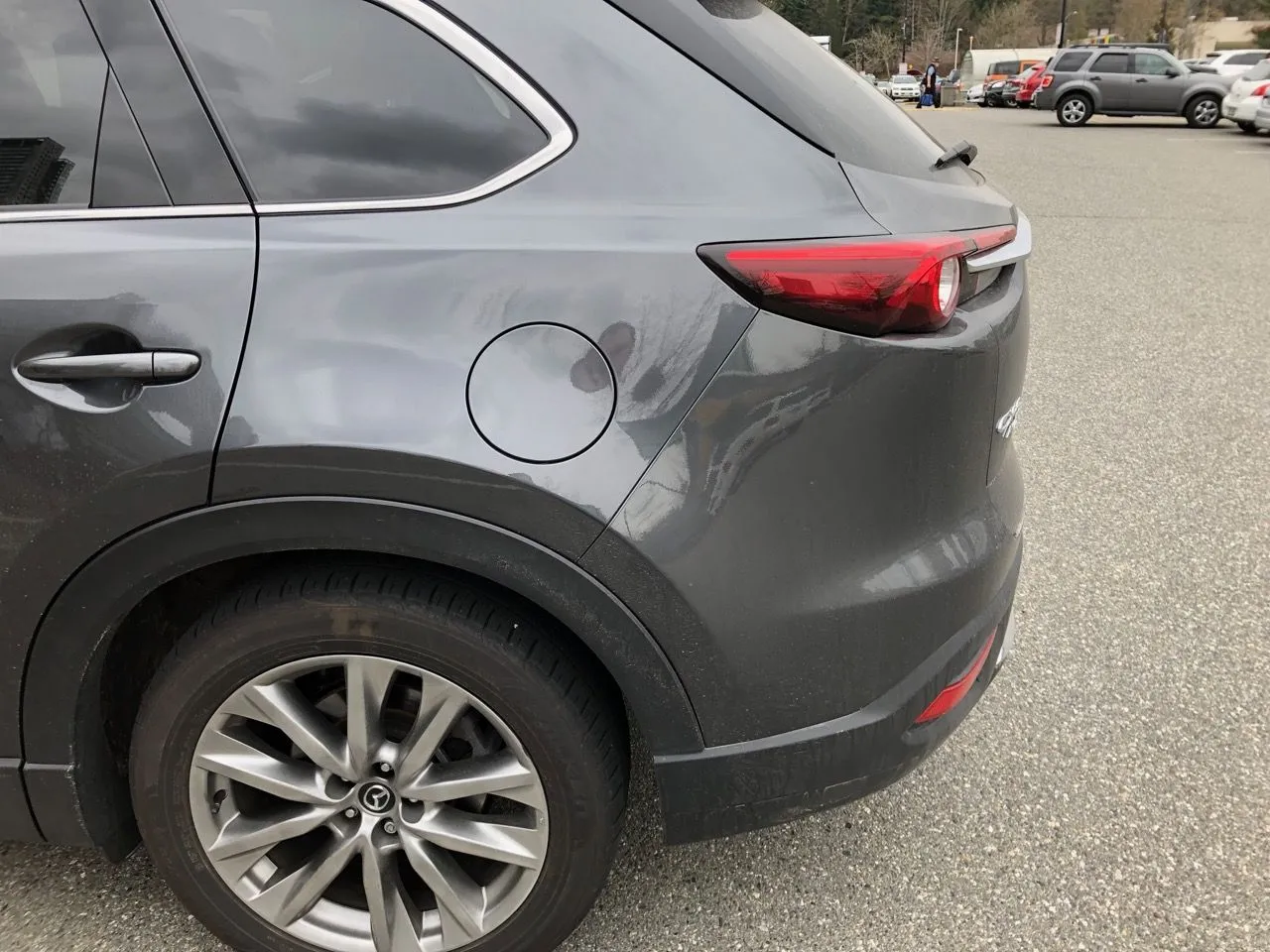

Hey All,
I have a 2017 CX-9 in Machine Grey. It has had a run of bad luck, shopping cart into he rear, nephew backed into the drivers side, dog jumped on the passenger side and someone hit the front in a parking lot.
At this point they have repainted quite a bit of it. My issue is the bumper does not seem to match well on one side only. They say the issue is the way the paint reflects on the metal vs the plastic, but that would not explain how it looks. I am pretty sure the 1/2 the passenger side and the whole drivers side was painted.
What do you think? Can it be better than this? Does it look terrible?
IMG_0693.webp Driver
IMG_0691.webp Passenger
Based on the picture, the passenger side looks way off, clearly a lot darker.
It's not like that surface area changes angles at the bumper cover line to reflect light differently.

Let's be realistic. There is no body shop can match factory original paint. Your best bet is to go back to body shop and ask them to do better job on matching colors.
Worst case they will have to blend colors with your quarter panels.
Depends on to what level you're talking. A tier 1 body shop can match where the human eye can't tell the difference. Although this may be do to blending so that it appears to be an exact match. The application process is the main difference, not the paint color itself. It is computer matched.
If a body shop can't get the paint color right, they shouldn't be painting cars. That's the one easy part.
Yeah, the passenger side is quite noticeable. If it were me, I'd be headed back to the shop to get them to do it right.

Yep I agree, a good shop would be able to match the paint. There is some difficulty in matching the paint on the plastic parts with the paint on the metal panels, but a good shop would be aware of this before the fact and account for it. I had damage on my driver's side rear door, rear fender, and rear bumper from a moving hit-and-run. I also had scratches on the passenger side in the same areas from a hit-and-run in a parking lot. I took it to a Honda body shop (of all places) and they had it looking like it was brand new.
OP, if possible, I'd get the shop to repaint it and blend the paint better. The excuse that the bumper is plastic and the fender is metal is a poor one, as the paint matched perfectly from the factory. All that says about the shop is that they were lazy. Another option might be to see if your insurance will let you go to another shop to have the paint resprayed/blended.

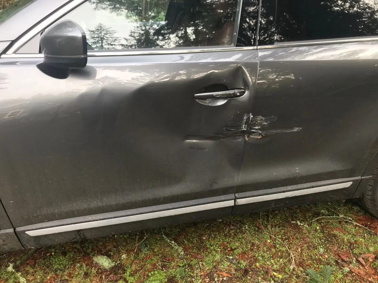

This was a recommendation by the Mazda dealer, this shop does all their repairs for their ding insurance etc, and it gets very good reviews online. I'll head back there and see what they can do about it. Poor car has around ~20k on it, 4 claims, 13K worth of repairs and no real physical damage to the body (both doors were replaced). Starting to think it might be cursed!
This is the drivers side before (or after depending on how you look at it:
Whoa. How fast was your nephew going when he backed into you?? Lol
Funny enough - not all that fast. He was in idle in reverse in an F350. Unfortunately we were in the middle of a power outage and it was pitch back and he did not see it there. Hit in an angle and slid down the doors. Damaged the supports in each door so (thankfully) they were not salvageable and had to both be replaced.

I've noticed that on the Soul Red, as well as the Machine grey. I can deal with a slight color variance, but the 2 different matches and the stark line drive me a little batty. I think they should have blended the paint better. There were dog scratches on the passenger doors, and they blended the doors and fender to match. One would have thought they would have bended the side as well.
I may be being picky - but when the lighting is right (cloudy, and I live in the Vancouver area) it is a very dramatic change.

I actually have some pics that you can reference here: https://www.mazdas247.com/forum/sho...-9-Signature&p=6621998&viewfull=1#post6621998
But let me know if you need more from different angles, at sundown, etc.
I think this illustrates the problem I am seeing. It looks like the bumper and quarters were painted on yours, and then blended up the sides. I think the takeaway here is that they should have made a case to blend the quarters to match the bumper, or matched the paint better on the bumper in the first. place. Originally they just painted the bumper, then the entire drivers side, then the front fender, 2 passenger doors and front bumper. I have no idea why they would have just left the one part out when they could have done it all at once.
The gotcha now is going to be that they have to match the rear bumper when they paint the quarter, and then blend it.
Staphwildman, I'm late to the game here, sorry. But 13 years in the auto adjusting ring and I can tell you that your repair shop is giving you bad info.
Not sure what the laws are where you live so can't say what your recourse could be.
Some deviation will always exist in that area, some colors worse than others. It also depends on which spray out card the shop uses, which paint they are using, which primer they used and if they tinted the color as well. Many factors here. But end of the day that color should not look that bad between bumper and quarter. They should be able to get it much closer without blending the quarter. In my area out of all the cars I inspect, 99.9% of bumpers are painted without blending into quarters. In the last 2 years I can think of maybe 1 shop that has asked to blend.
The majority of the few times this has been asked of me, it is for a candy color, heavy red/blue metallics, and a couple pearl whites, but never gray. That is simply not pre-loss condition. My CX-9 is gray mica and has nowhere even close to that sort of variance from the factory. Very very minimal difference and only observable in direct sunlight.
