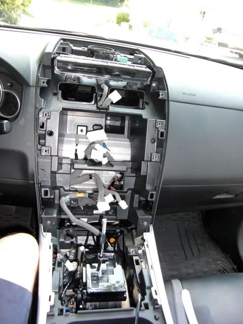

Help!
How do I get this thing back together???

Dude....You're screwed!
Perhaps a visit to your dealer Service Department is in-line at this time....
haha. Yes I took that pic when I did my iPod DICE install a year ago. It was pretty scary taking the whole dash apart of a new 40k car.
I did manage to get most of it back together and now I have some spare screws.
sorry it took me 3 years to respond but I've been a little busy. ANyway I didn't end up with any spare screws. That is just an old joke people say when they put something complex back together. Looking back, I removed this radio to get to the back in order to mount a Dice iPod controller which was so horribly slow and had such a bad interface that I simply use it as a dumb AUZ input and charger for my iPod. My mother just got a 2014 CX-5 and the iPod interface loads your playlists on the NAV screen and also plays songs from your iPhone via bluetooth quite seamlessly. It is exactly what I wanted for my CX-9 but it is 5 years too late. Mazda is always a few years behind when it comes to electronics. I remember my 2008 didn't even come with a trip computer to estimate miles left before empty and Mazda claimed its customers didn't want this feature.
