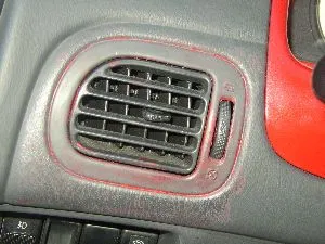

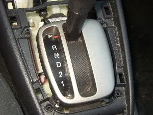

Okay, the pieces im having trouble removing are the ones shown below. the shift plate, i guess you could call it, wont come off unless the shift knob comes off. im not sure on how to do that. and the drivers side vent piece, not the vent itself but the piece around it(dont ask about the paint). i think its just attached to the dash. sorry for the dirty car.

the shifter, shift down into 1 and use a small + screw driver and remove the two screws in the back. ull have to yank the knob off because it is connected to the o/d button. u WILL rip the wires. (u can try cutting it? i just yanked it off) just rewire them after.
the vent piece, ull have to go from the left side like i described. good luck
peace

goddamn automatic...wish wish wish i had a 5 spd, but it was the only one on the lot, and wasnt totally my decision. graduation/birthday present kinda thing. theres always the option of a tranny switch...hahaha, yeah. right.
