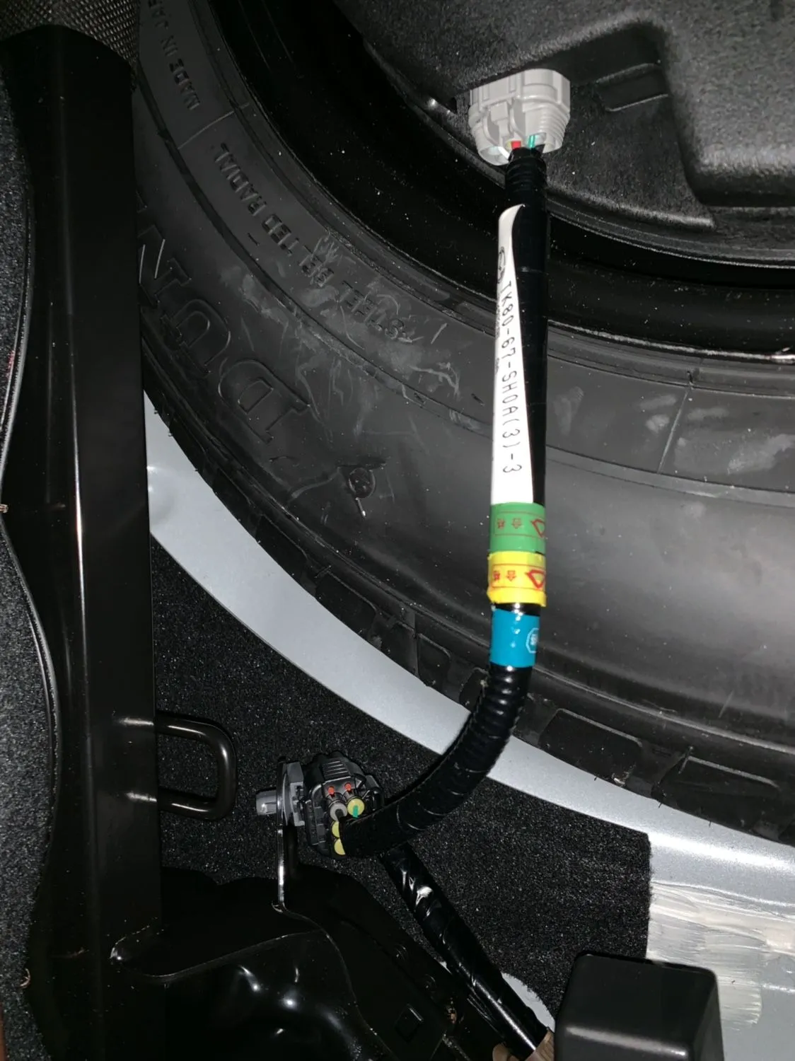

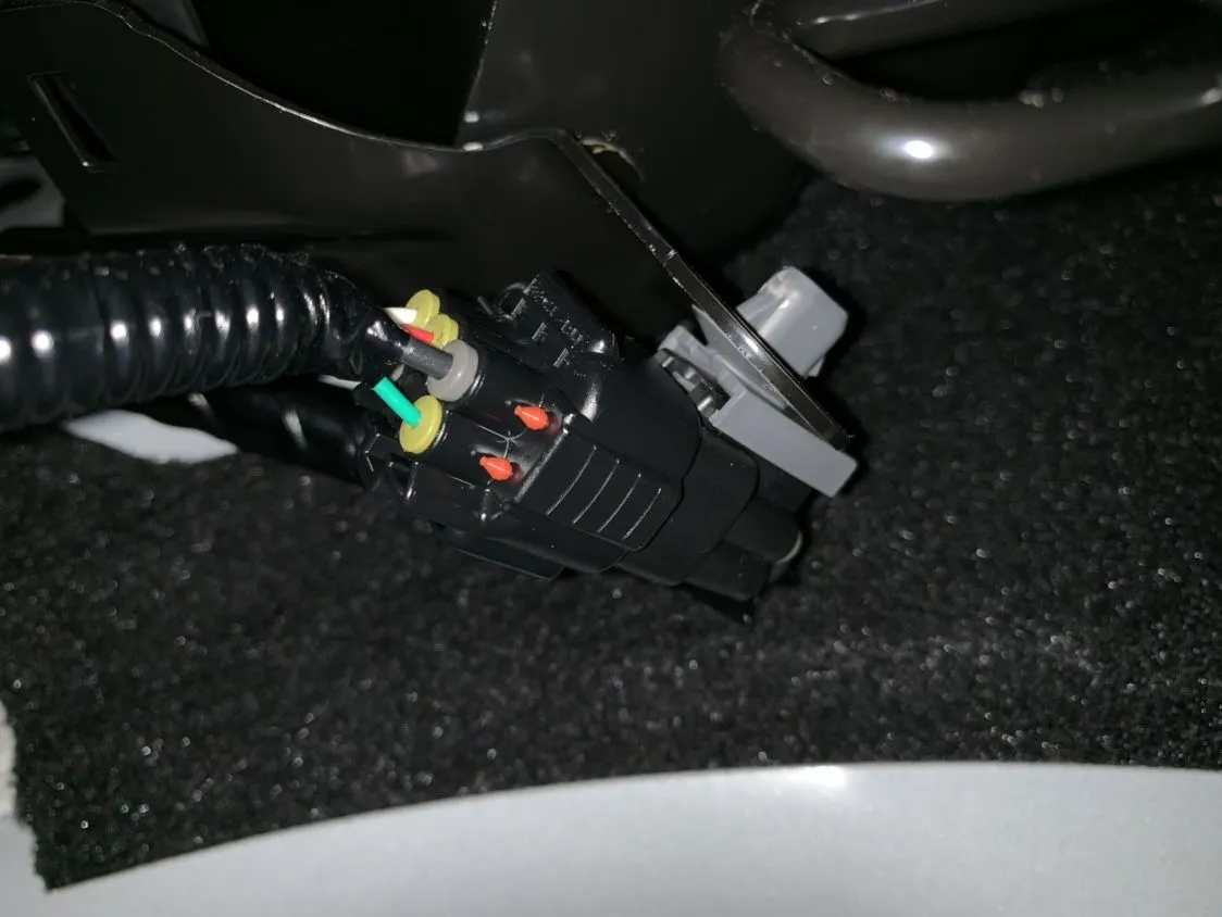

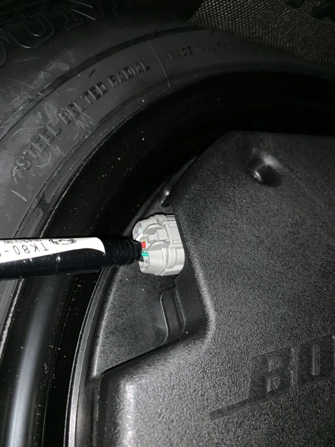

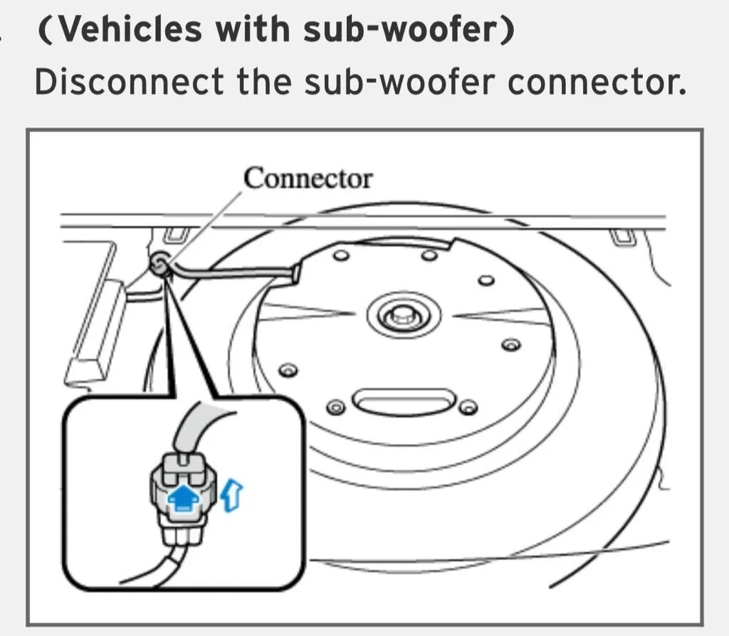

Having difficulty removing the connector. The instruction manual wasnt very clear. hoping any advice from this forum to guide. Cant seem to find any latch on the black end of the plug.
On the black connector of the cable coming out the subwoofer, the latch is on the bottom center. Just push it in the direction of the cable, and the two parts of the black connector should come apart.
