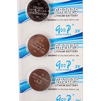

Both those links are wrongly labeled by the seller. If you look at the package it says lithium. CR is the industrial code for lithium batteries.

Yeah, although the title says "High Quality 5 PCS Cr2025 Cr 2025 3v Alkaline Button Cell Battery" but look at the actual product it says "Lithium" on package and battery itself! I agree with slidespec, I just don't think there's "Alkaline" CR2025 battery exists.
