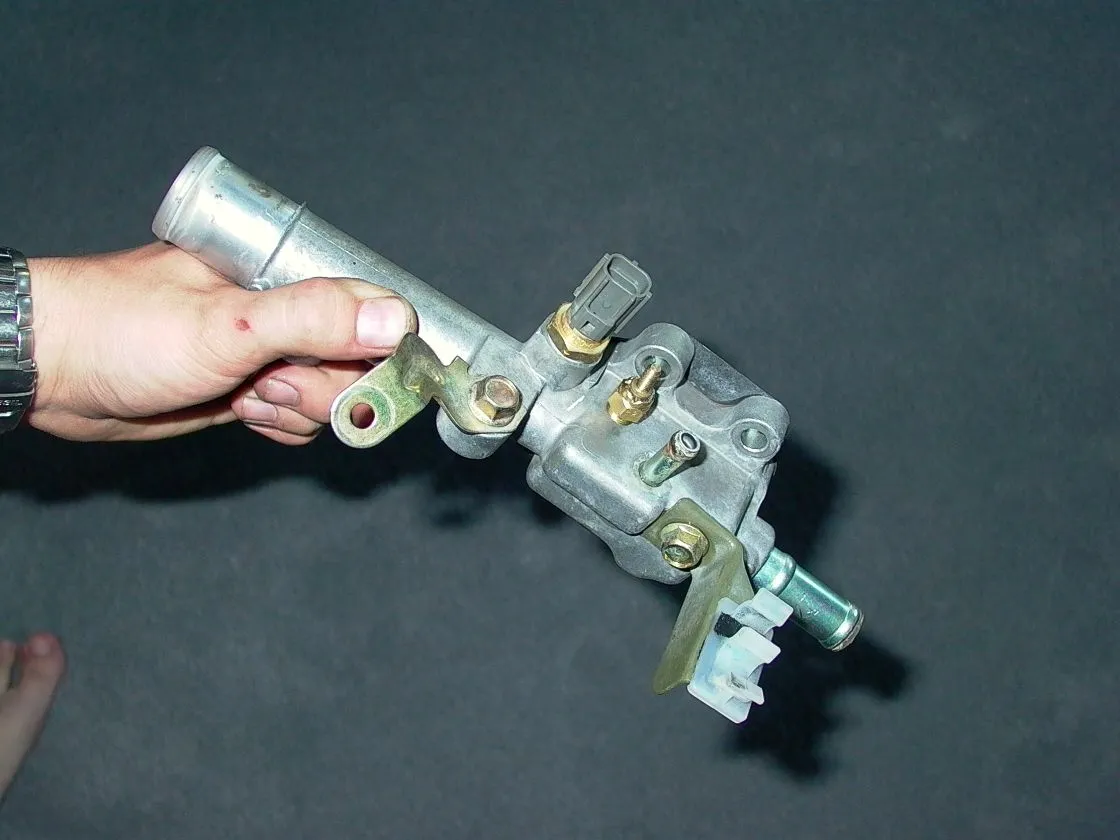

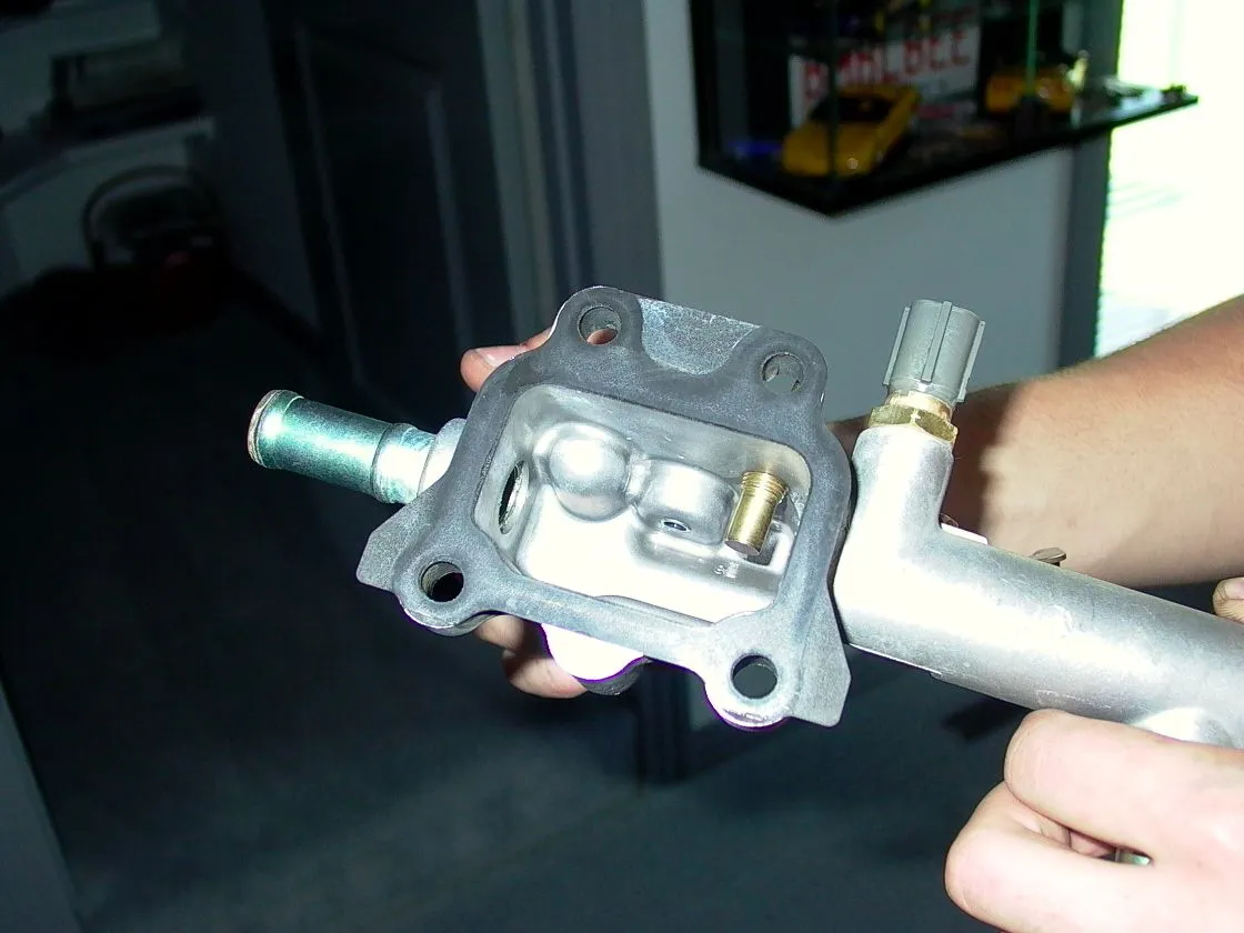

For all of you who have been posting on where to put you after market water temp sensor, here is a pic of mine installed in the water neck. I drilled and tapped a hole to fit the autometer 3/8 NPT fitting, and went to town. I had to shave down the bolt there that holds the neck to the block, but it's all good now. Learn from my mistake and put it as far away from the mounting holes as you can! Just test fitting it here, but when I actually installed it, I wrapped it in teflon tape.
Enjoy all, and thanks to Pirana for the idea.
