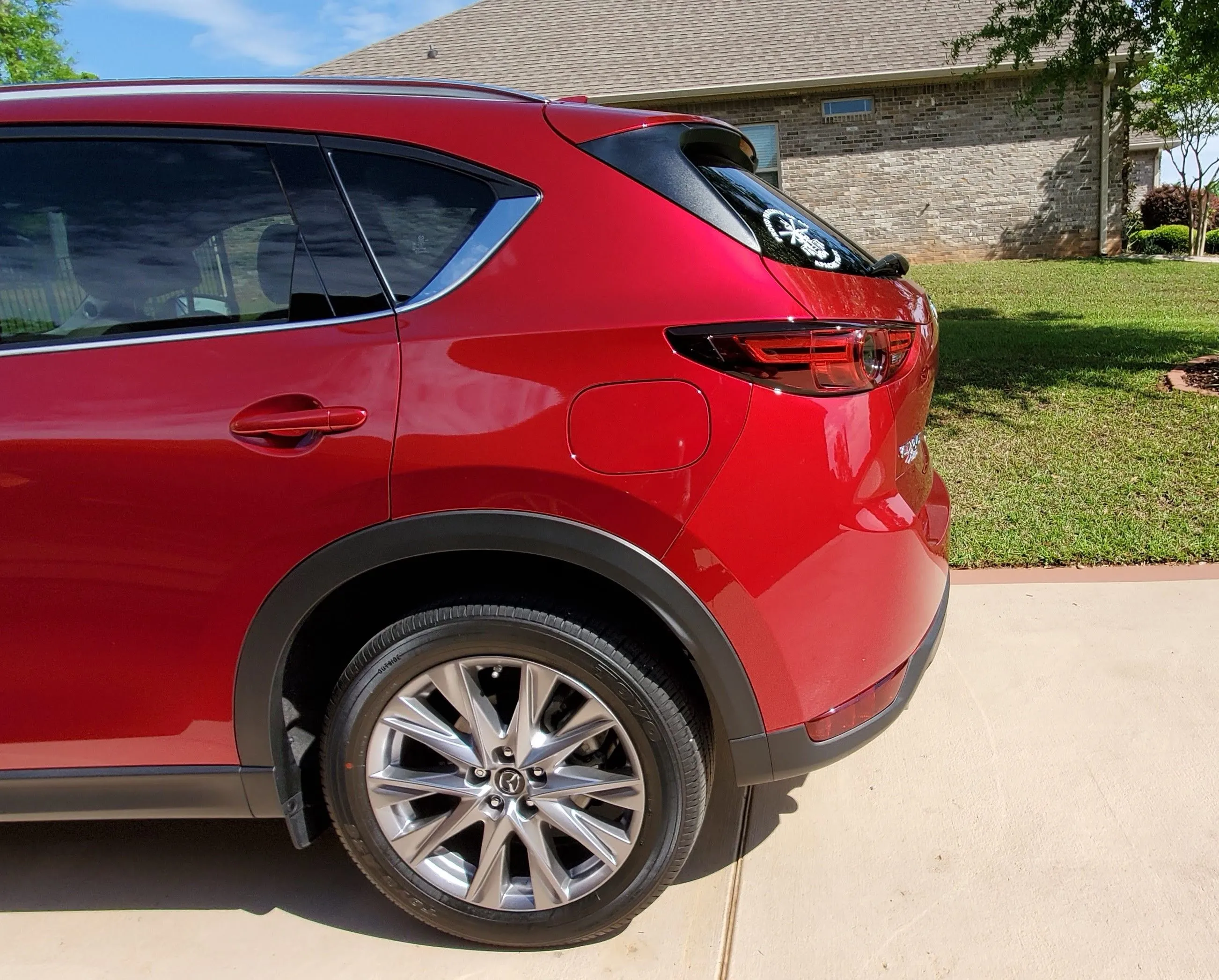

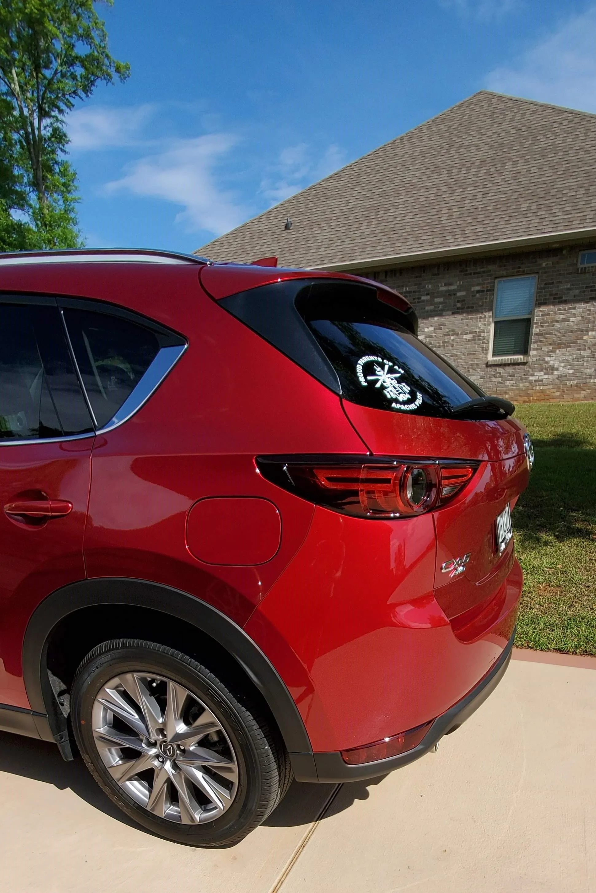

@TT_99 You shouldn't need to blend paint on a relatively new car. The OP was able to get a very close match on their rear bumper without a blend, as far as I'm aware. Maybe you can use the OP's experience as evidence that a match can be achieved without blending? I guess if the PPG rep is directing the shop to blend, you may have to proceed with that direction, but I would push for one more repaint without blending and hope for the best.

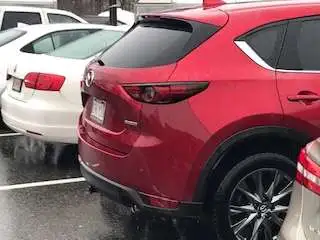

The wife had a small fender bender and the rear plastic bumper cover had to be replace, the problem I have is the paint is not matching , not even close (in my eyes). The paint shop agree to redo it but it's not guarantee to be exact. I understand but I see this as way off the mark. View attachment 224149View attachment 224150
Tony, I'm in the middle of this SS now. Here is a picture of the initial repair. I think it's a good shop, but they have little experience with this color and are treating it as just a normal paint match. They scanned the color currently on the car and are mixing the paint in house, using what they refer to as the Axalta color system. I don't understand why they don't buy the 46V from Mazda. They claim that painting plastic is different, but I agree with the comment that the color goes on top of primer and not raw plastic. They also think that the answer is to blend this repair into the adjacent panels. Really??

Jeez, that shop is terrible.
Your dealer should be more helpful. They are supposed to advocate for you with Mazda Corporate. The fact that they aren't tells me a lot about them, but that's besides the point. Absolutely contact Mazda directly. Be thorough with your experience thus far. The picture you have shows a painfully obvious attempt at paint-matching. When they find out how the shop tried to paint this colour, I believe they will either send a PPG rep out or recommend a different shop, one with experience working with this colour.
Agreed the paint doesn’t match at all. Also, any shop that does not blend the paint with the other panels should be avoided in my opinion.
Of course, you don’t want a bad job done all over your fender. But even though a good paint job can be very close to the original, it is never a 100% match. Blending it in makes it looks seamless and impossible to see the difference.
The soul red is a very difficult paint to match, and it needs all the similar appropriate layers done like on the original. It is not just color matching, it is also the depth and reflection of the paint that needs to match. You need a good shop with experience with that paint color. Maybe see who local dealers uses for their paint work, they should have experience with this special color, it has been around for a while now.
Usually small paint variations are visible to the naked eye but hard to capture on camera. The exemple above looks terrible on photo, i can’t imagine how bad it must look in person.

Hey sorry man. That looks like my front bumper after the first 2 times. I keep pressing after I wasn't satisfied and the shop I went to reached out to the PPG rep and they send someone over to oversee the respray. Took 3 tries and the 3rd isn't perfect too but it was a lot better than the first 2 attempt. In some angle it looks like its perfectly blended but in some, its still a shade off but I stare at it so much that my eyes is starting to see all the subtly of this shade. I also stare at any cx5 SCR when i see them on the street to see if the bumper and the fender has any noticeable color difference and even new one does have a slight difference if you look close enough. I will keep at it and ask the shop to reach out to their PPG rep and ask them to send someone who can oversee the respray. It could be the mixing of the paint or just the process itself, but it made a huge difference on my car. good luck
Shade will be off at some angles even with factory paint because of the different material but it shouldn't be so obvious.
Yeah, my shop didn't achieved the same results as the OP but after 3 tries, i was happy enough as I don't think they will do it for the 4th time.
