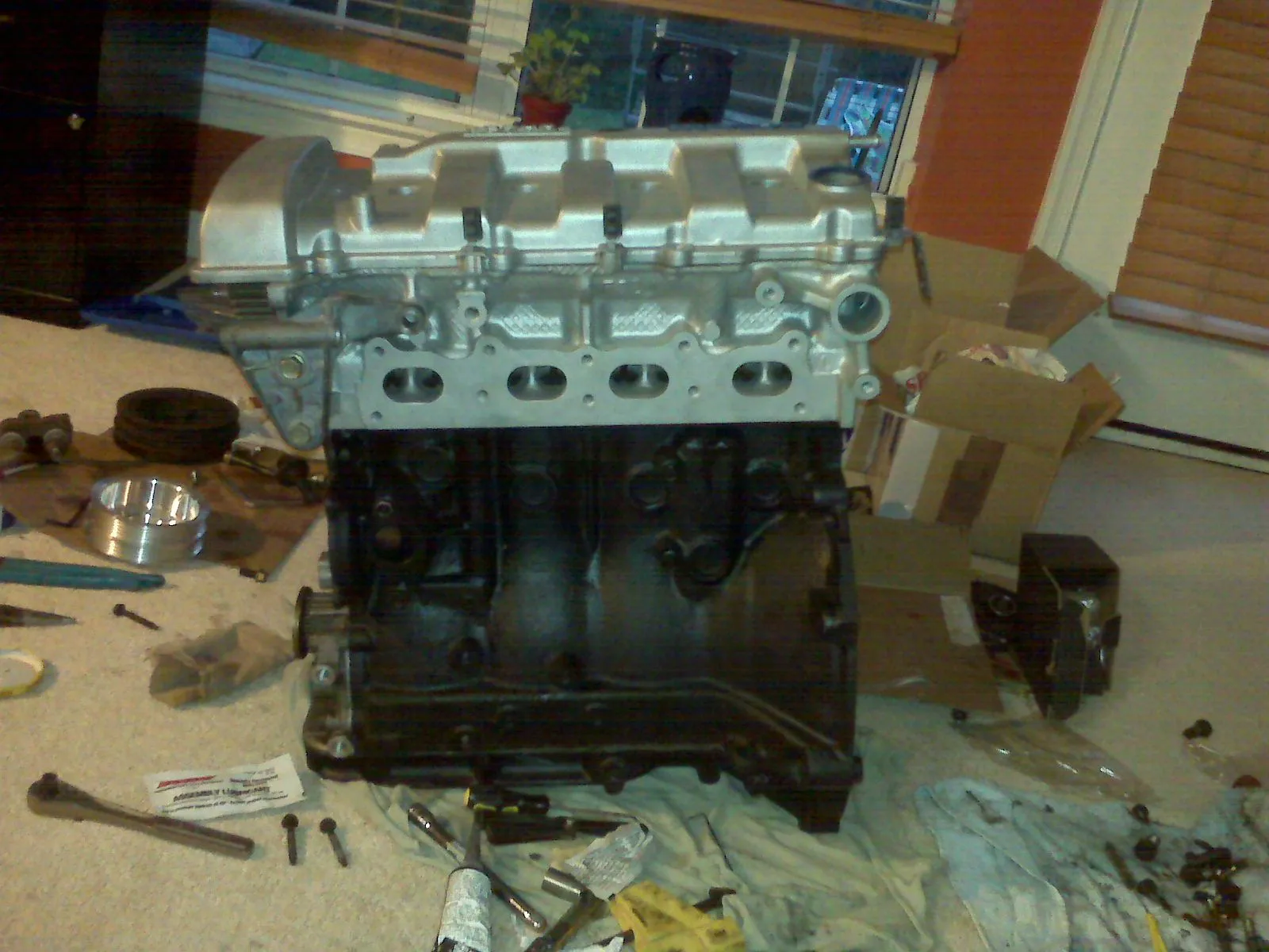

finally got it back together, right next to my huge mess of tools.
